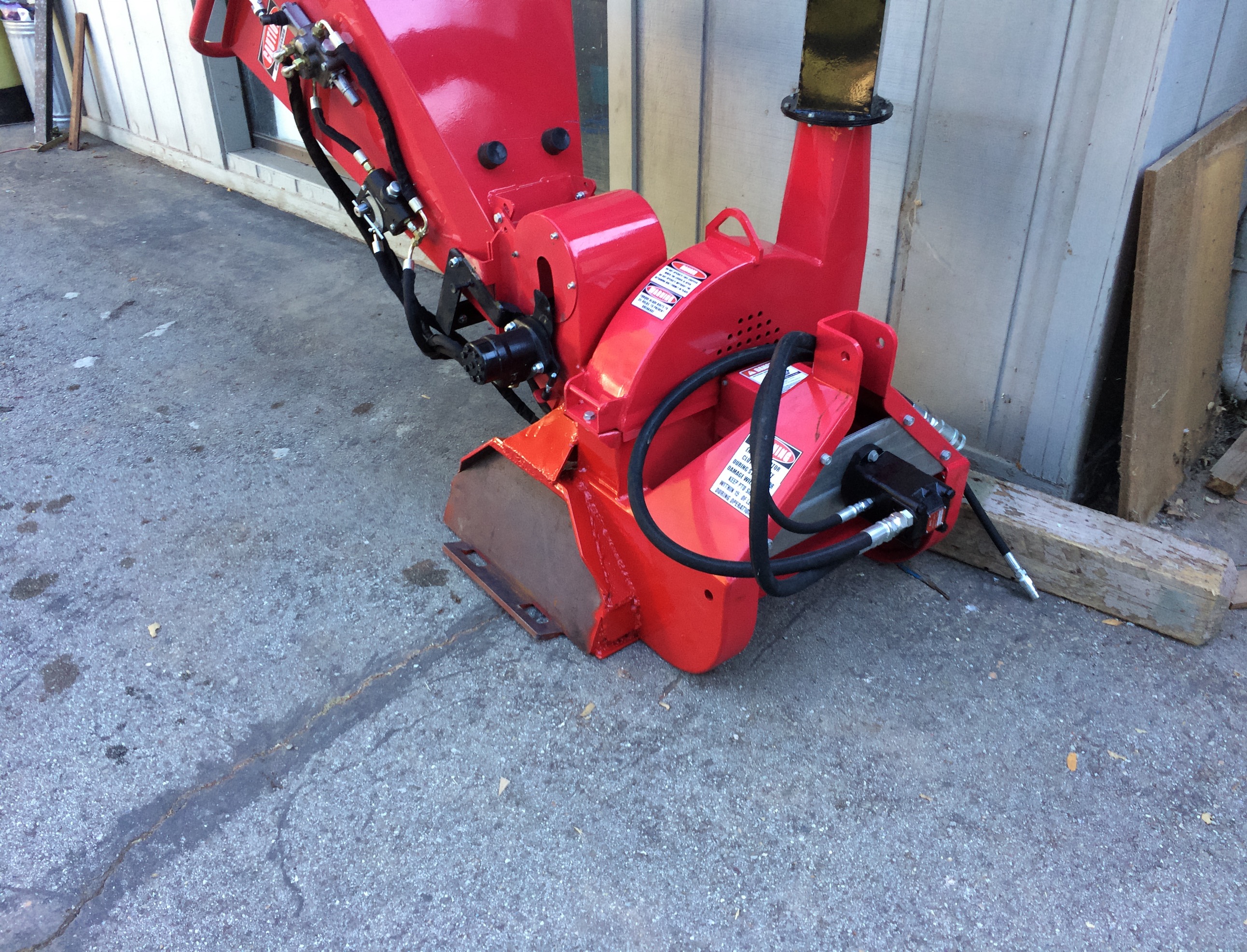

Once it arrived, it was clear that the shipper had tipped the chipper over on its side at some point. There were a few scuffs on it, and some bent hoses, but nothing a little touch up paint and a replacement screw couldn't fix. WoodMaxx offered to send touch up paint, but I just used the PowerTrac red that I've been using. It almost matches the nice powder coat on the chipper. I went over every screw, bolt and nut and checked for torque/tightness, and we were off to the races.

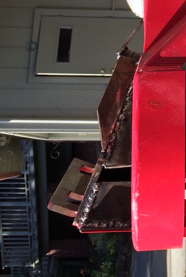

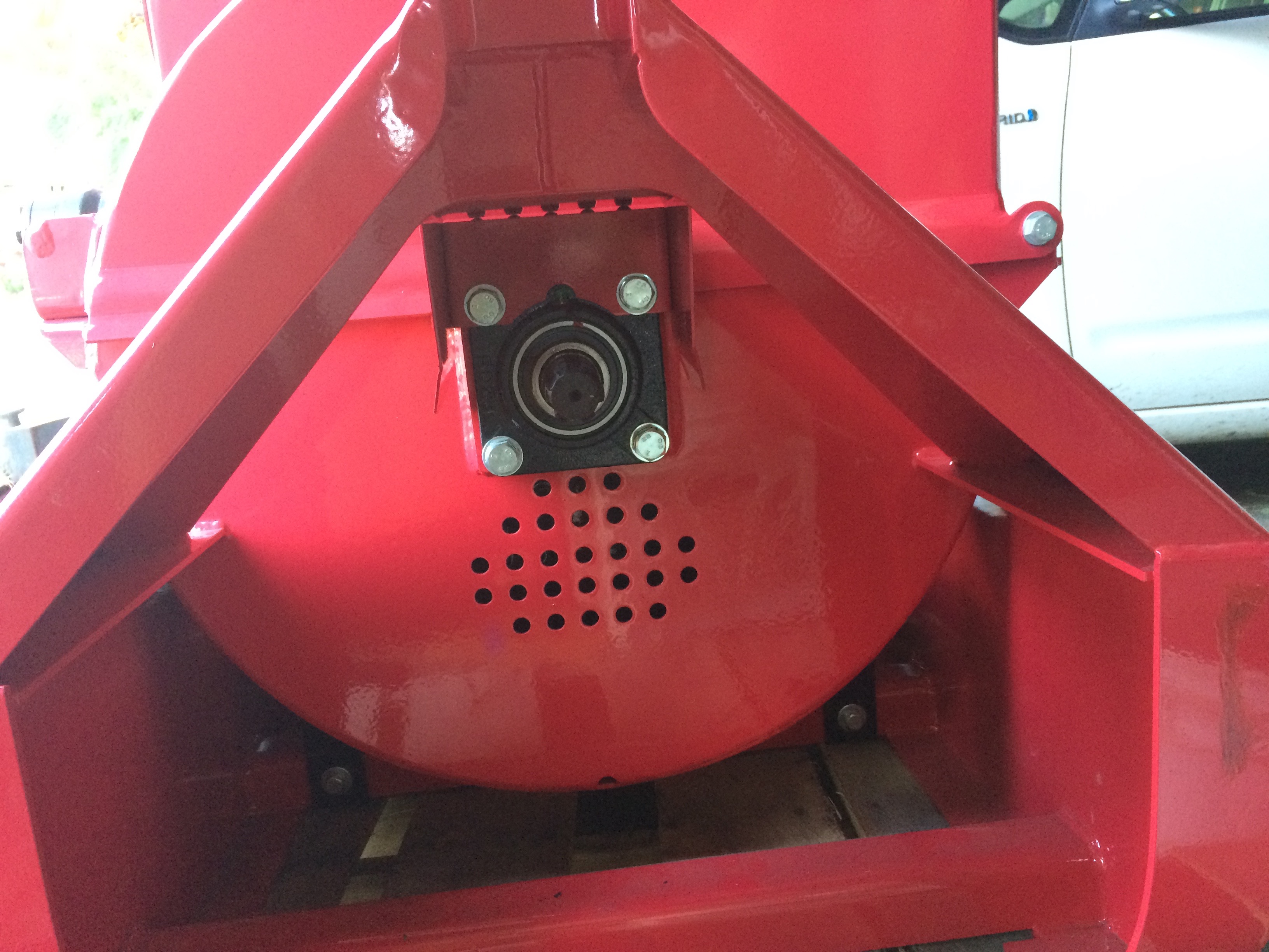

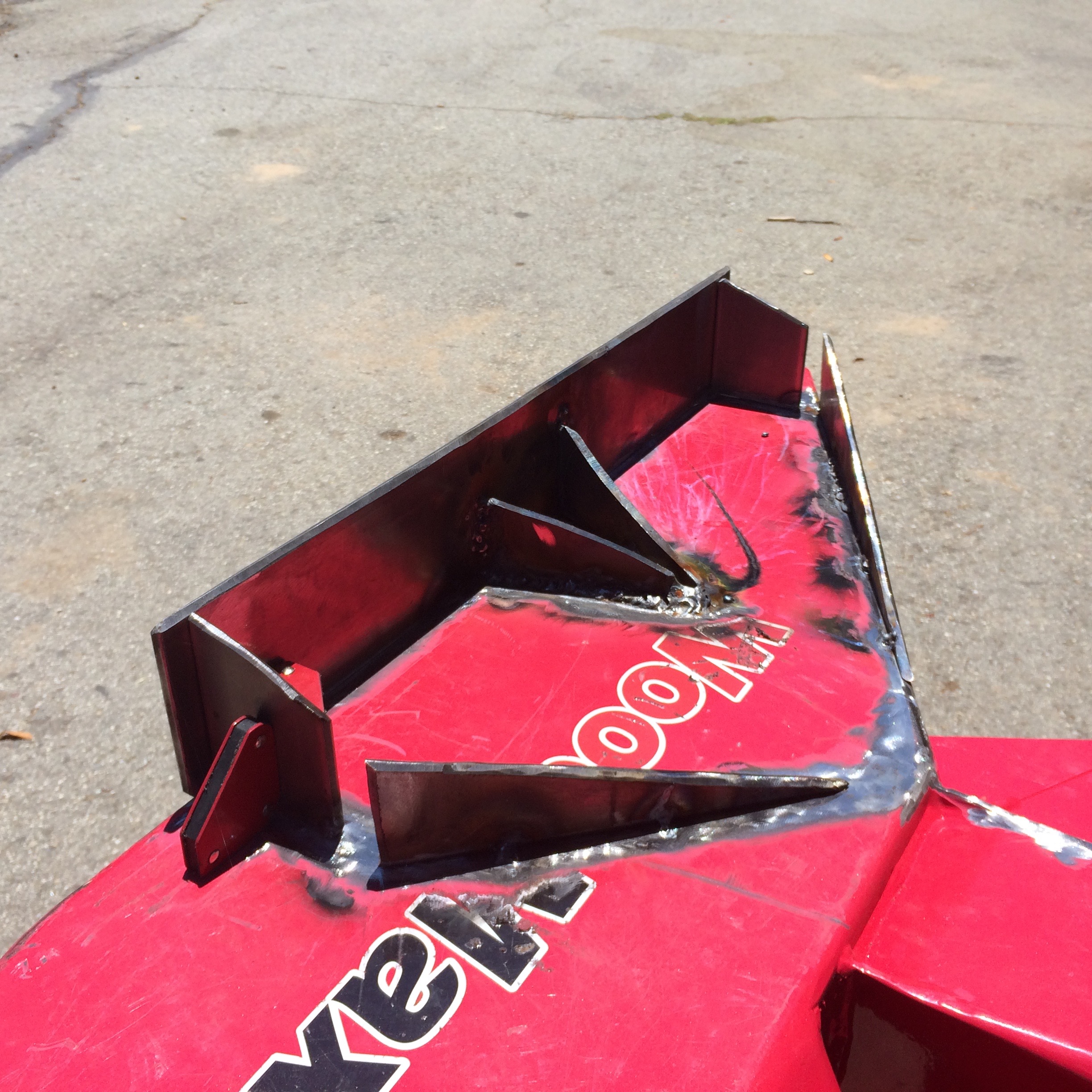

With the chipper at ground level, it seemed as if the optimal site for the QA plate was on the side of the chipper, perpendicular to the 3 PT hitch, which would bring the center of mass closer to the the tractor. I did some quick center of mass checking by lifting the chipper from the center eye. It would also put the Q/A plate right on the chipper housing for added strength.

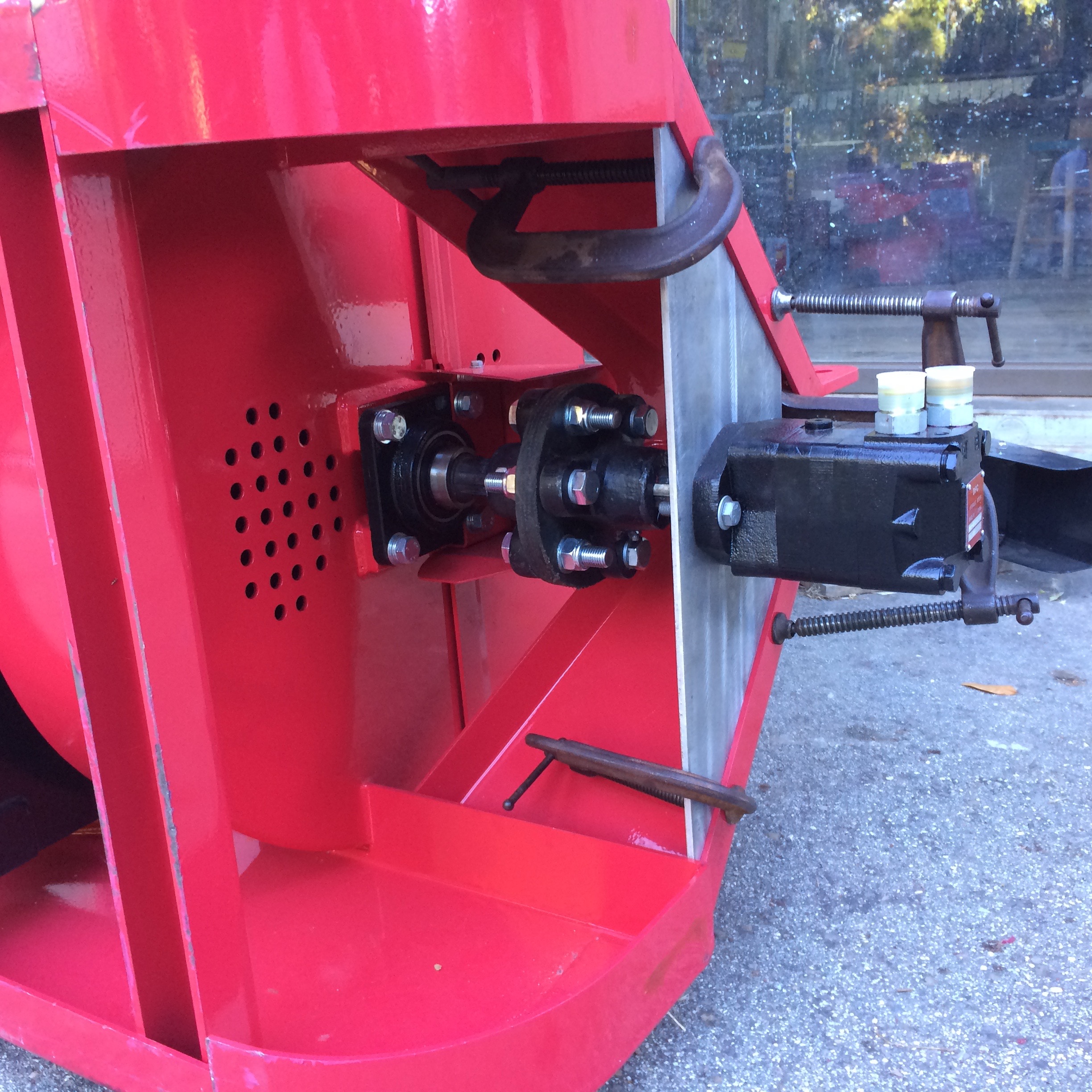

A friend machined out a trapezoidal plate to hold the motor where it would be inline with the existing PTO splined shaft of the chipper. I was going to use steel, but he had some high strength aluminum, and we used that instead. It is held on with four bolts at the corners, roughly where the clamps are in the photos. I used Nordlock (McMaster) washers to hold the motor and plate in place, and to hold the yokes to the rubber shock plate. (Nordlocks are amazing! And pricey!) The bolts are grade 8, but could have been grade 2 as a quasi-shear bolt. The emergency stop should be covered by the PT pressure relief. I loosely tightened all the bolts on the plate and motor after checking the shaft alignment, including the yokes. (It turned out to be a mistake. See below.)

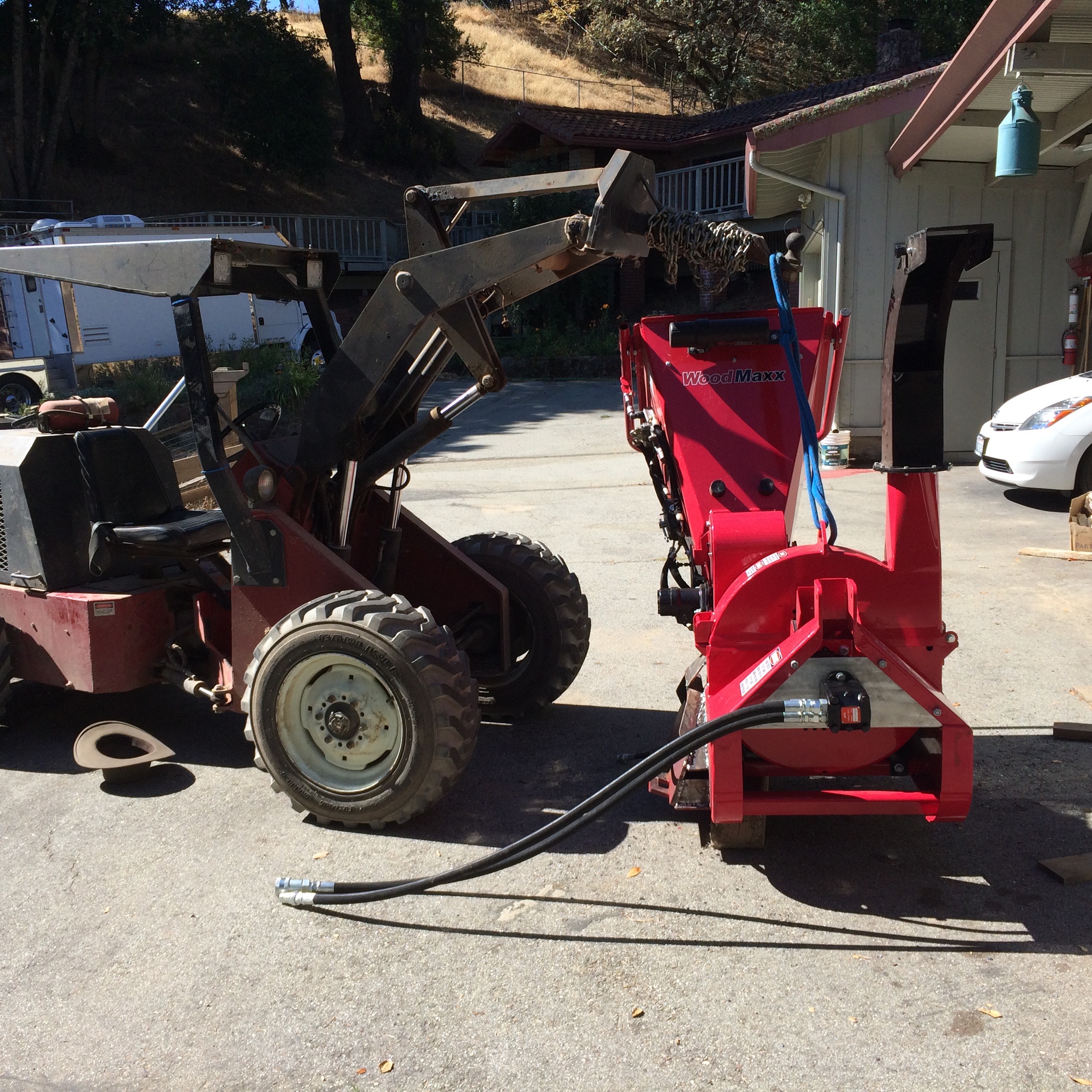

I used the PT to turn the chipper on its side to weld on the Q/A plate, by using the lift eye again, so more welds were horizontal. (I'm not a great vertical welder.) I then cut some steel pieces to space out the Q/A plate at the bottom to enable chipper to be carried on the level by the PT, and to have it level on the ground.
I also added a top plate to tie the top of the Q/A plate to the chipper housing, which contains ~1/2 of the weight.
With the Q/A plate on, I turned the chipper vertical and filled the oil 15W40 synthetic, in case it ran hot. I had a brief break in the action while I sorted the right Power track connectors.
Then, I powered up the chipper. The motor wobbled, despite my prior attempt alignment. Shut everything down, and rechecked, and found that one of the yoke set bolts was pushing the yoke out of alignment. Since, the whole yoke only need one set bolt, I loosened the offending yoke set bolt, and realigned the shafts and yokes. I retightened the motor and plate fasteners. On repowering the motor, everything ran smoothly, and stayed in alignment.
I then stopped the motor, and put a small reflector on the yoke and used a non-contact tachometer with the reflective dot to measure the chipper speed. I plan to use it at some point in the future to double check the Deutz idle and WOT to factory specs.
I slowly ramped the motor speed up to prime the hydraulic feed (it runs separately from the PT). It didn't really prime until I got over 250 rpm or so. I ran it slowly at 250 for twenty minutes or so to get the hydraulic lines purged and then topped up the reservoir with oil.
Once I had the chipper running at 540rpm, I marked the throttle setting on the PT. As planned, it is about 60% throttle. I start and stop the chipper at idle. Popping the PTO off at speed generates a little cavitation noise (perhaps as the valve goes from powered to recirculation?), as does a sudden deceleration. I think Rip's idea of having a pressure relief at the motor might have some benefits, but the chipper spins down smoothly.
