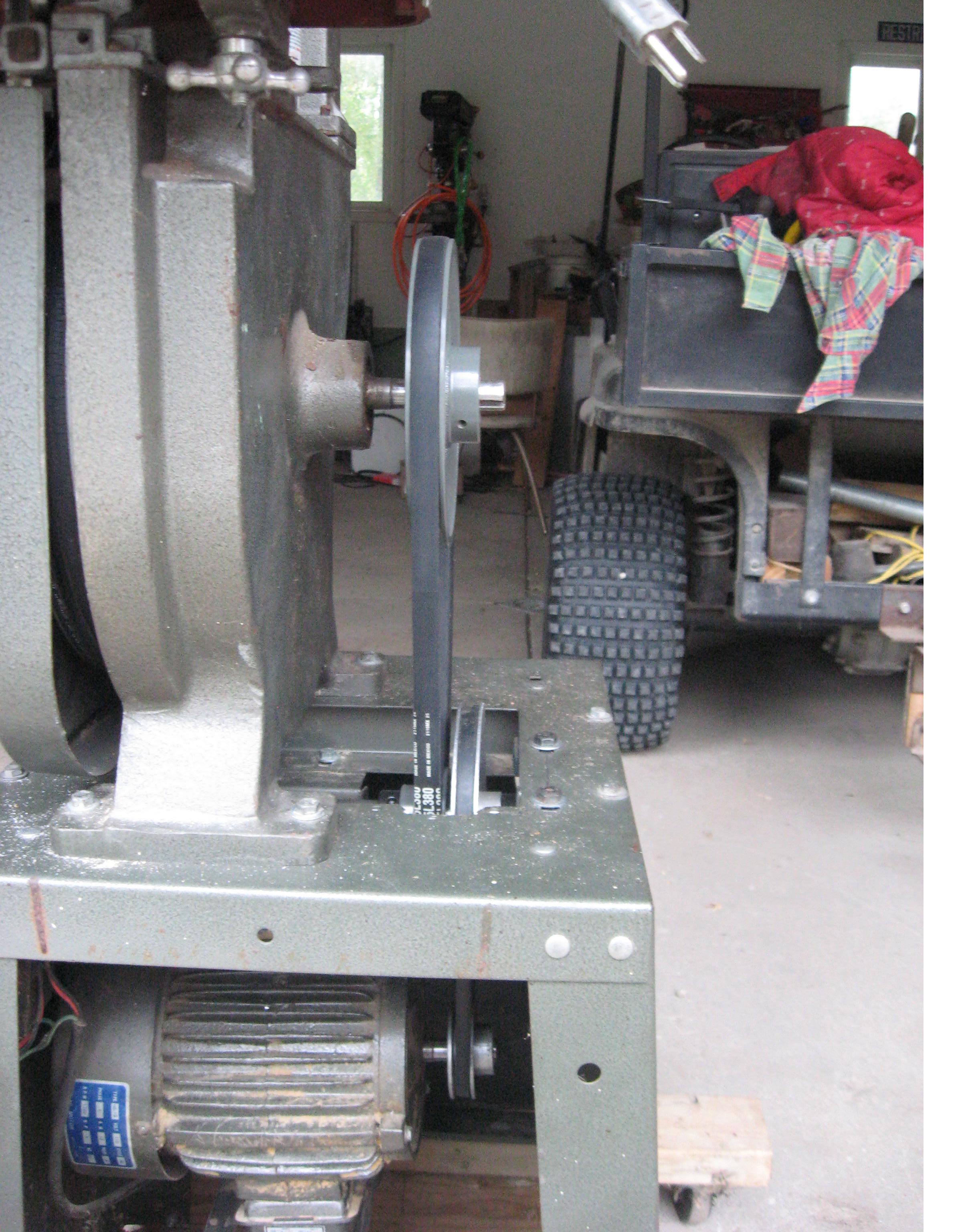

It kinda doesn't make sense, but I have/use a HFT 'Router Speed Control', which is PWM like 3 PH VFD's are. I made a jumper w/50a spaded FW bridge rectifier to use with 130v DC treadmill motor for my Cinci T&C grinder vs OEM 440v 3PH. :rolleyes: Yeah, it growls at low rpm that I wouldn't use, but does give me good speeds for both 3 1/2" & 5" bonded wheels.
Anyway, the speeder doesn't just work with routers. I use it to mix protein drinks and can slow my H-B shake maker on the 'hi' setting to reduce foaming in my blend. So, these instances are using PWM to vary speeds of motors that (minus slip) basically lock into the 60Hz of our supply.
As with VFDs then, it seems there are 'ID' motors to handle the strains of their non-typical loads/speeds. We can generate a lot of torque with PWM at lower rpm (lathe, mill) but TEFCs can run warm when the fan slows. If we can't prove it's more than marketing buzz, 'ID' seems to connote 'rough service' and/or continuous use. (large/muni water systems use PWM VFDs & 'Inverter Rated' motors a lot)
Do your best to balance any pulleys and be sure they run true. HFTs digital tach works for me to reverse-calculate driven pulley rpm, blade fpm, etc. Here I brought a wood saw's blade down from >2400 to <600 fpm for metals by adding a jack-shaft, and calculating from 14" wheels' rpm.
