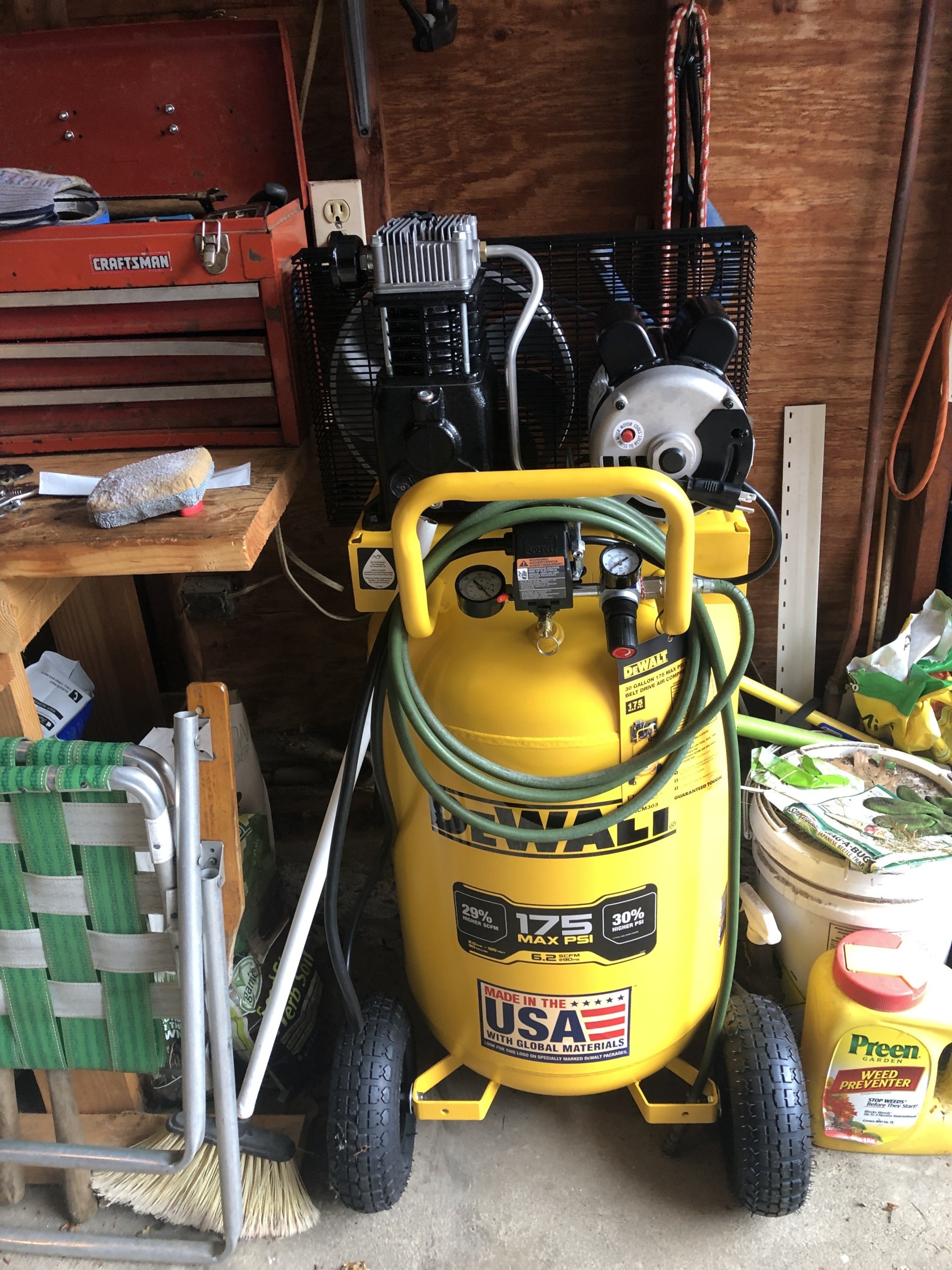

Beware of compressor duty motors. Listed as 5hp peak 3hp continuous.
I have an IR dual stage with a 7hp motor. It pumps air faster than I can drain the tank with any tool.
Curtis makes good stuff ad well
/ What compressor would you get? #24
The IR is only a single stage compressor. I have a 2 stage 5hp 80 gal vertical, the high limit is 175 PSI. My plasma cutter, Hypertherm 65 makes the compressor run hard. If it was my choice I would get a 2 stage at a minimum. More CFM.

Yep I ended up going with

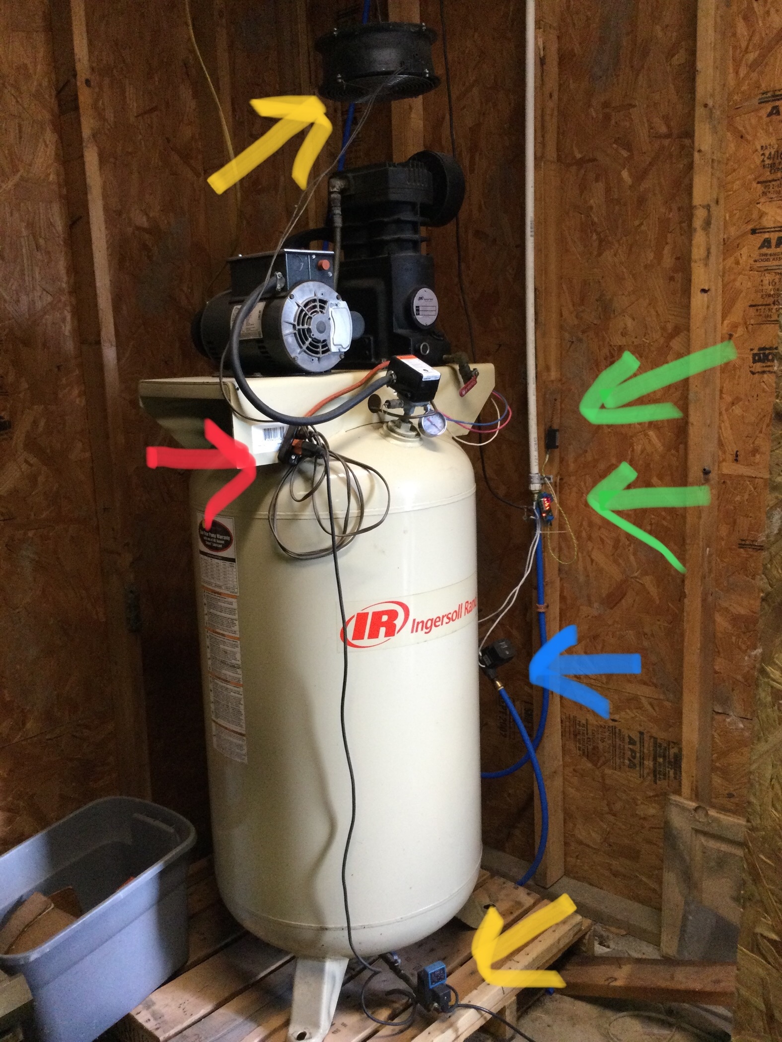

What IR compressor did you have and what failed? Sounds like I will have to suffer with more junky stuff.

The one I posted a photo of failed, that’s how I got it for free. It was ran hard, everyday at a shop for a decade or so with almost zero maintenance, the tank probably would have been ruined but there was one guy that would drain it every day.
The rebuild kit cost me $157 and I have been using it for a number of years since then. If you think you are going to buy one and not do any maintenance, ever, a cheaper disposable compressor would probably be a better idea. Just throw it away when it fails and get another. That said, changing the oil and air filter is a hell of a lot easier and faster than rebuilding the compressor and that’s if nothing was ruined by the lack of maintenance.
