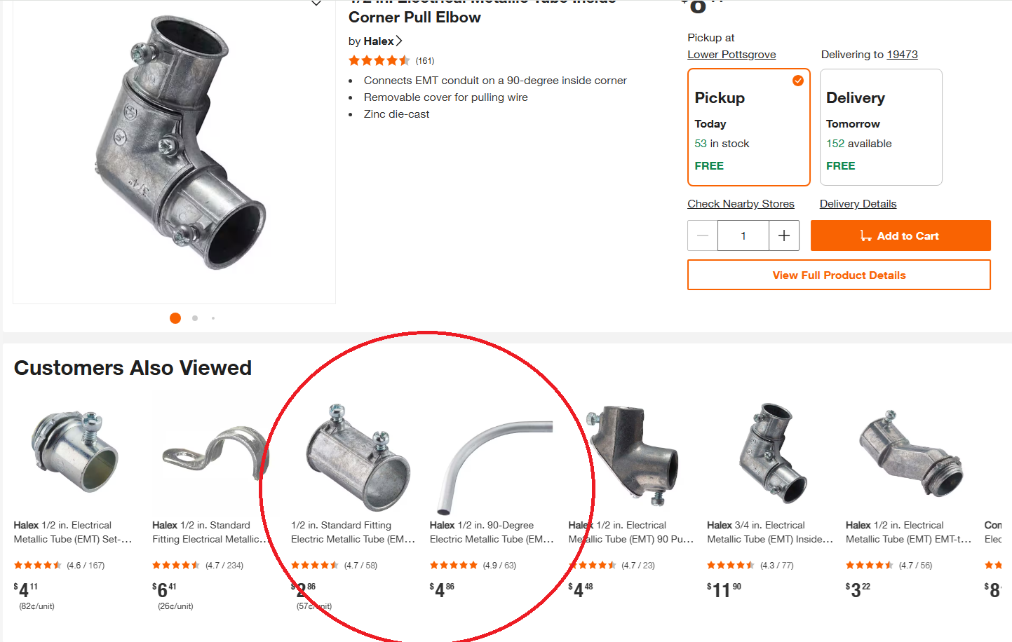

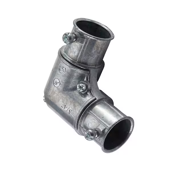

I'd run Ø3/4" EMT, it ain't that difficult. And there's no need to bend, if you don't want to, they make both inside and outside pull elbows, which can be disassembled to pull the wire thru, then re-assembled around the wiring. Here's the inside corner version, both available at your favorite Lowes Depot.
With that, you can pull simple THHN or THWN, and forget the Romex. Anything else is going to look like a home-boner hack job, and bother you for the rest of your existence, not to mention put off any potential future buyer.

Be sure you're calculating the guy's material right, wire is expensive, and also accounting for his travel time. But if your $1900/2.5hr = $760/hour claim is right, then yeah... that's awful greedy. I'd guess the going rate on residential work is probably closer to $125/hour these days, but that's only a guess based on older data and inflation.
But a job like this is simple and straightforward enough, it's hard to justify hiring it out. 3/4" EMT, 3 AWG-10 conductors of THHN or THWN, breaker and receptacle rated for your wire type, gauge, and amperage... all of which is likely already spelled out in the novel-sized manual that comes with any stationary equipment, these days.
Yeah, you could do PVC, if you want it to look like hell. It sags, it yellows, it breaks... it is embarassing for anything other than burial, IMO. EMT is just too easy to bother with PVC, in any non-corrosive space.
Oh, and there are swept bends for inside corners as well, if you don't like bending your own or using the pulling elbows. Just use a coupler on either end of the bend to connect the straights, all on the same page:
Oh, and lookie... conduit clamps for fasetening it to the wall are just to the left of that, and the adapters to interface with your panel and receptacle box knockouts are to the right of the page.
