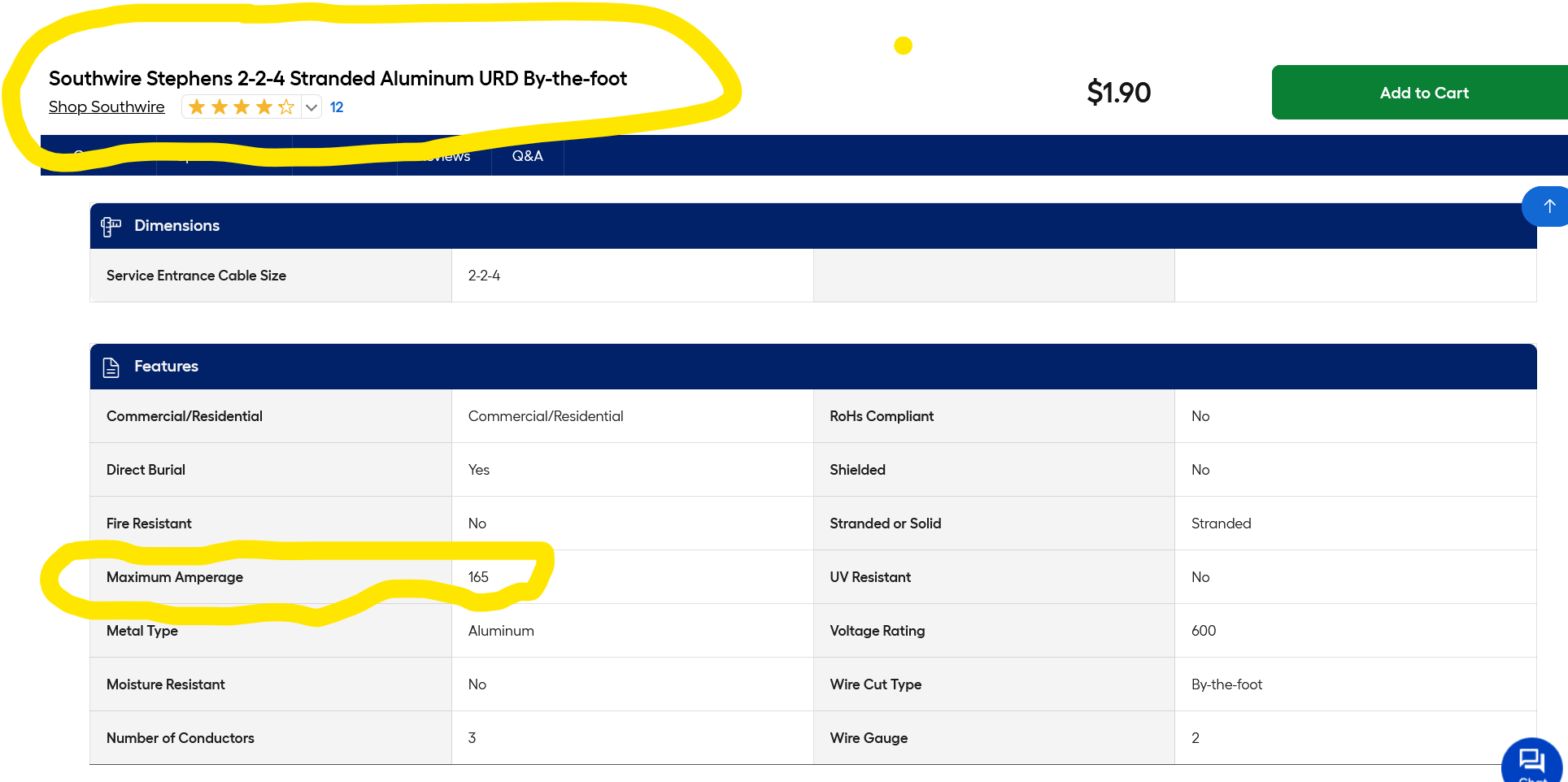

nope not suitable for the chargers I have experience with. Installation say alum. a no go.
Not supposed to use alum. wire as the charger is both a continuous use of high power (many hours) and regular use (very often)
ie: to much power to often but service drops are the same IMHO but its what the installation manual said.
but 2-2-4 alum. USE-2 / URD from Southwire is rated 165 amps when buried though??? so I'm clueless only sharing what installers book said.
I'm a proponent of copper as well; lower power losses.
Can you point to where that specification is? On the Southwire website, it doesn't even go that high for copper on 2-2-2-4;
All the best,
Peter
I am no expert!!
I chated with Southwire about a year ago on their chat function from their web page and on the Lowes.com website under specifications both confirmed 2-2-4 for a service drop was rated up to 165 amps given a bunch of assumptions like run length, insulation they use, the high temp. rating they have on the insulation, etc....
So I am just parroting what I have been told by Southwire and from Lowes website
the no alum. observation comes from the chargers installation manual.

Aluminum wiring is perfectly fine, as long as it’s sized correctly and all mating terminations are properly rated and applied for aluminum use.
I’ve specified it countless times on large circuits. It’s definitely a cost saving.
People still have unfounded fear from stories of it being misused in the 60’s-70’s residential wiring.
