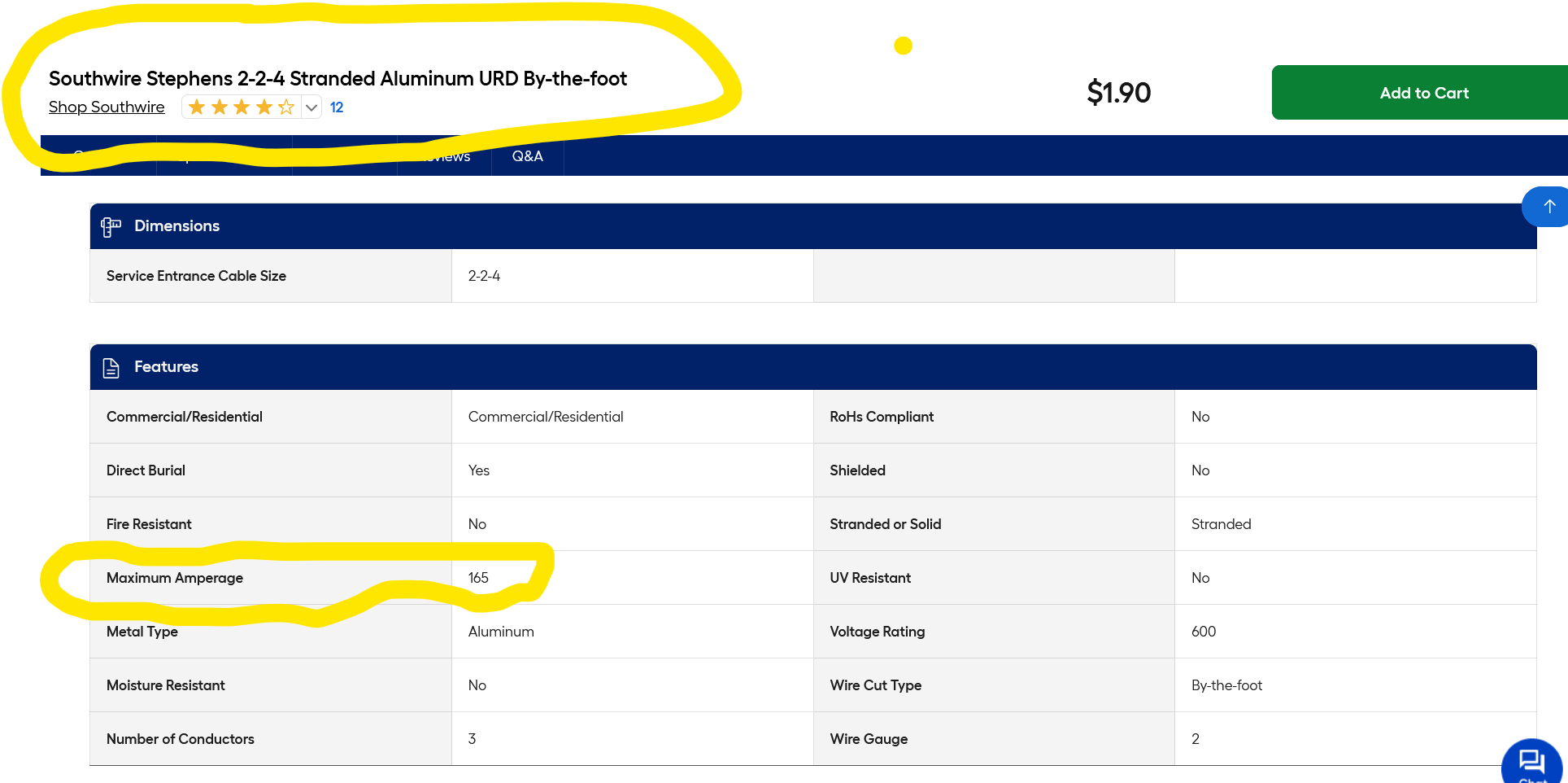

nope not suitable for the chargers I have experience with. Installation say alum. a no go.
Not supposed to use alum. wire as the charger is both a continuous use of high power (many hours) and regular use (very often)
ie: to much power to often but service drops are the same IMHO but its what the installation manual said.
but 2-2-4 alum. USE-2 / URD from Southwire is rated 165 amps when buried though??? so I'm clueless only sharing what installers book said.
I'm a proponent of copper as well; lower power losses.
Can you point to where that specification is? On the Southwire website, it doesn't even go that high for copper on 2-2-2-4;

I am no expert!!
I chated with Southwire about a year ago on their chat function from their web page and on the Lowes.com website under specifications both confirmed 2-2-4 for a service drop was rated up to 165 amps given a bunch of assumptions like run length, insulation they use, the high temp. rating they have on the insulation, etc....
So I am just parroting what I have been told by Southwire and from Lowes website
the no alum. observation comes from the chargers installation manual.

I am no expert!!
This ampacity rating is for conductors in free air, suspended overhead. The free air gives up the heat, voltage drop would also be higher at higher amps..
In conduit #2 AL would be rated for 75 amps.
