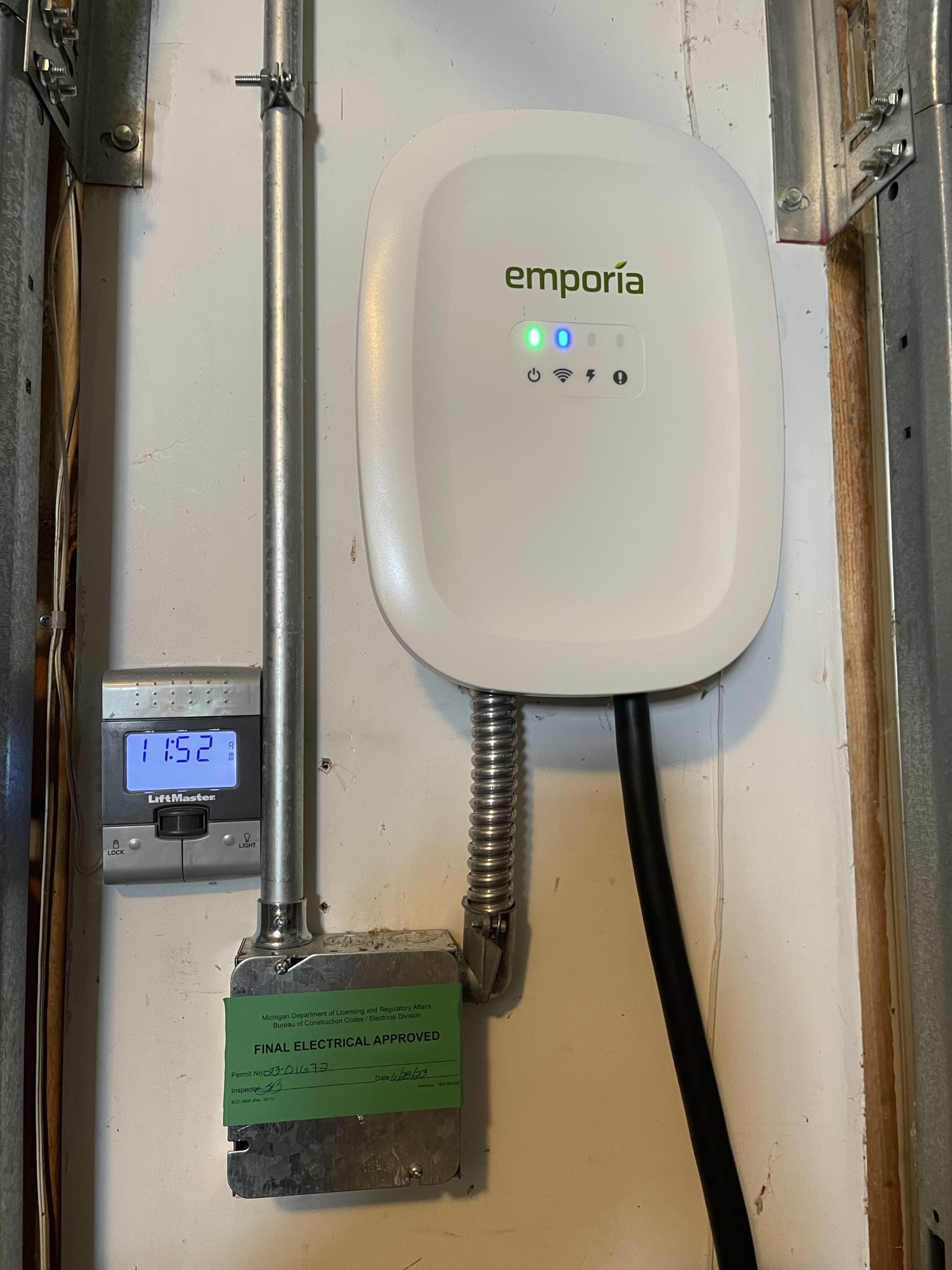

Our circuit has a 60 amp dedicated breaker allowing us to charge at 11.5 kW/48A max charge. We had an Emporia Brand Level 2 EV Charger direct wired into the end termination box. Direct wiring the Emporia Charger allows us to use a settable (thru phone app and charger wifi connection) from 6 Amps to the maximum 48A/11.5kW). If we chose to have the a NEMA 14-50P plug in the outlet box installed we would have been limited to 40A max charge. The Emporia Charger came with the mating 4 prong connector hookup that would connect to a NEMA 14-50P plug. That cord and plug could/was removed to allow the direct wiring from the breaker/wire circuit directly into the charger terminal box. We chose the direct connection for two reasons 1) allows max charge rate capability and 2) over time the receptical/plug can generate heat if the prong clamp load lessons.
side note
We placed the direct wired charger on the inside wall of the garage between the two garage doors. This was so we could charge in either of the two garage bays inside or outside of the garage with the 24 foot charger cable.

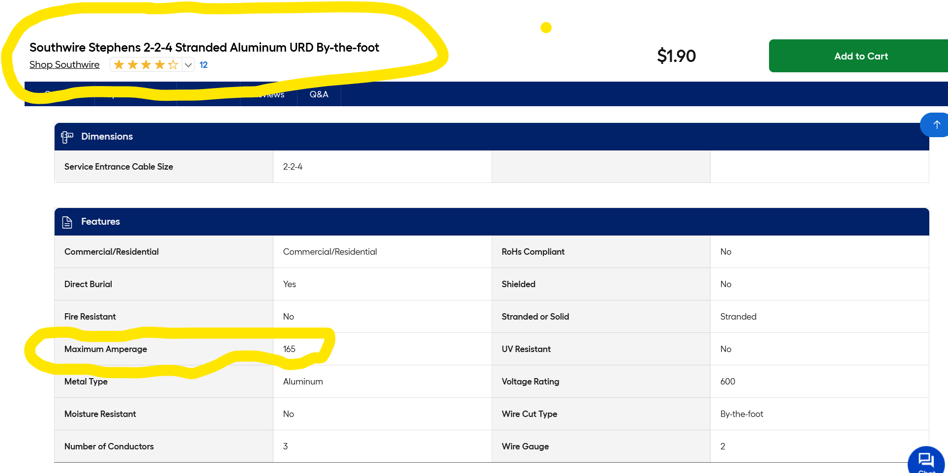

Lowes has 2-2-2-4 USE Aluminum for just under $4 a foot. Is there any reason not to use this? It's bigger then what I think I need. I'll just put a 50 amp breaker on it for now, and if I ever buy a UV, I can swap out the breaker for what I need, up to 100 amps.

I am not an electrician, but I think that 2ga aluminum (72A ampacity @60C, while copper is 95A @ 2ga) is pretty light for what you are proposing. Even 6kW over 2ga is a substantial voltage (and power loss). I would go heavier gauge, and go for copper if you can find burial rated copper in your area. Locally, I can only get it from electrical supply houses. I would set it up for 200A service and be ready. EVs consume much more power and for much longer periods of time than any other home load.

nope not suitable for the chargers I have experience with. Installation say alum. a no go.
Not supposed to use alum. wire as the charger is both a continuous use of high power (many hours) and regular use (very often)
ie: to much power to often but service drops are the same IMHO but its what the installation manual said.
but 2-2-4 alum. USE-2 / URD from Southwire is rated 165 amps when buried though??? so I'm clueless only sharing what installers book said.

I would suggest leaving excess length wires with a cover plate over it in the metal box where the charger is to mounted. This way if you get an EV you can either install a NEMA receptacle in the box or direct wire to the charger. In our case the steel box (i think 4 inches square) is about 8 inches from the charger. We used flex steel conduit to encase the wiring from the box to the EV Charger. When selecting a location make sure there is room for the EV Charger to mount. We had room between out two garage doors so it worked well.
I will try to get a picture of the receptacle box and EV Charger on the wall to show the setup.
Spanky
