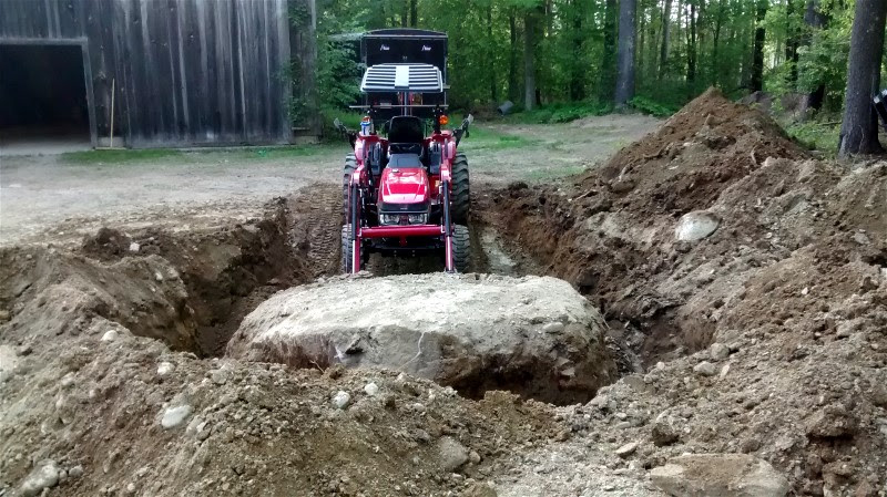

for Florida that is a huge rock, for New Hampshire it is a stone. 2 ton Comalongs will be nearly useless. Easiest way I have found to move large rocks without a backhoe is a rock sledge, or some say sled.
Get an old pick up hood, using bars, chains, whatever you may have, roll the rock on the hood and pull the hood with your tractor.

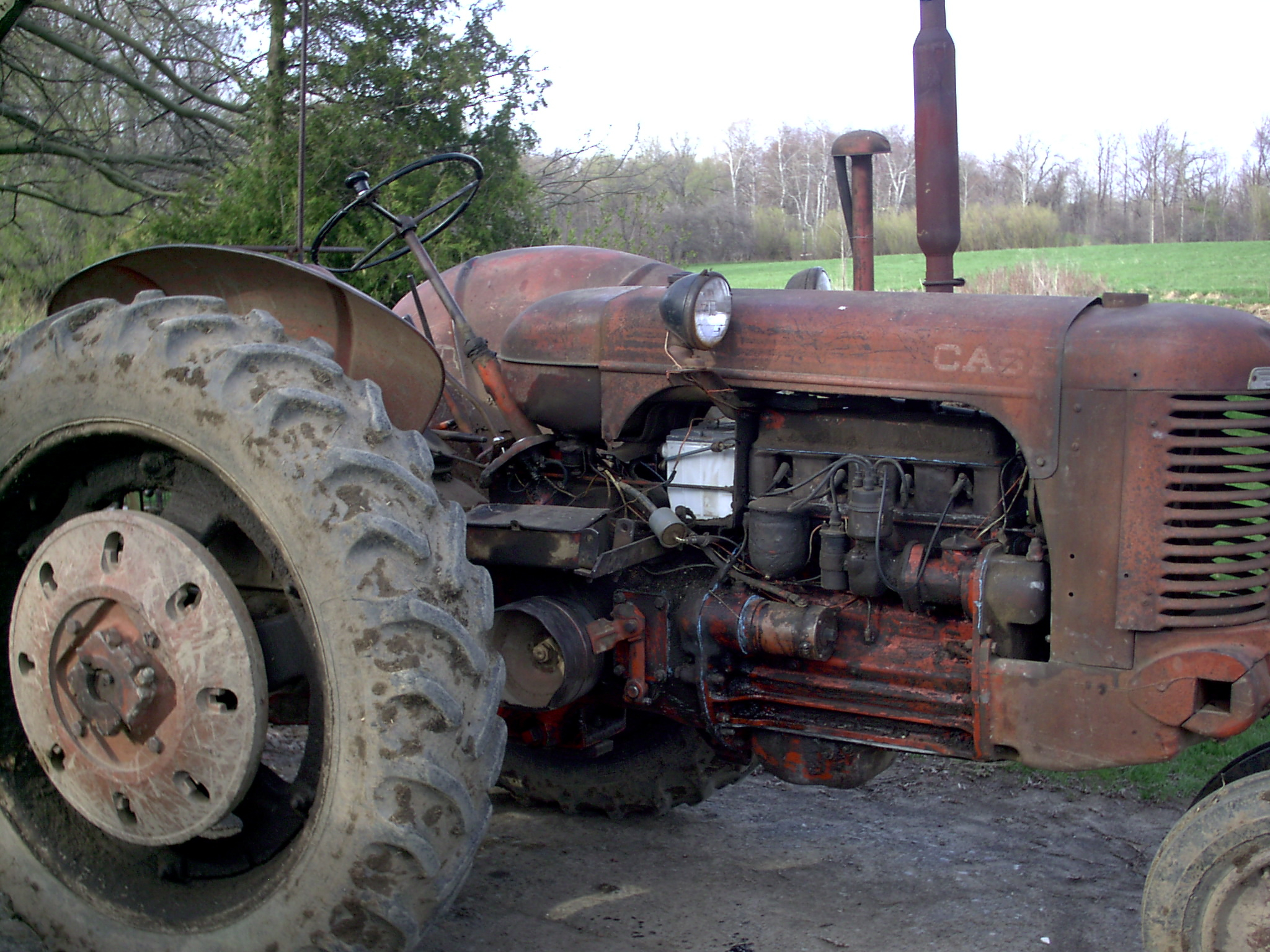

If my 70-year-old Case SC (roughly 30HP) couldn't pull a rock out, I wouldn't bother even trying with come-alongs. My Case can rip a set of typical "2-ton" come-alongs apart without even grunting.
Now, that's a no nonsense tractor right there!
