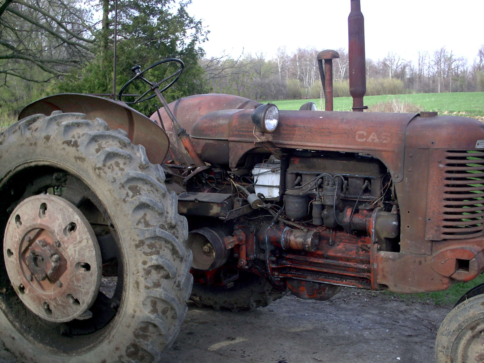

If my 70-year-old Case SC (roughly 30HP) couldn't pull a rock out, I wouldn't bother even trying with come-alongs. My Case can rip a set of typical "2-ton" come-alongs apart without even grunting.

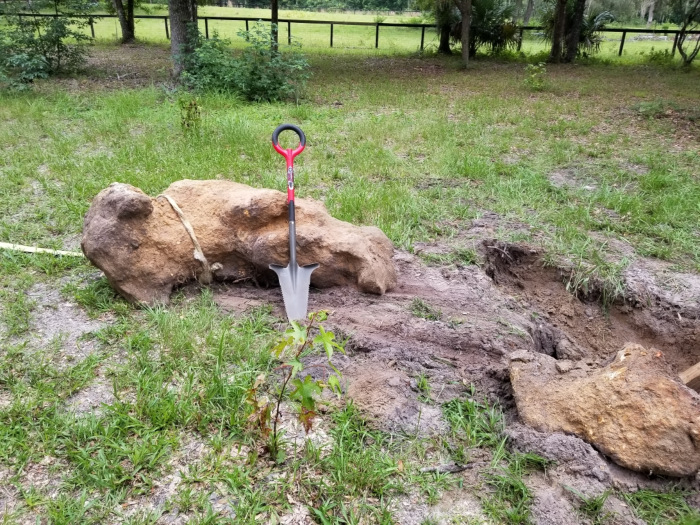

This started out as a small "corner" of rock sticking out of the ground.
Dig before you try yanking it out.
(Btw, It's still in the ground)

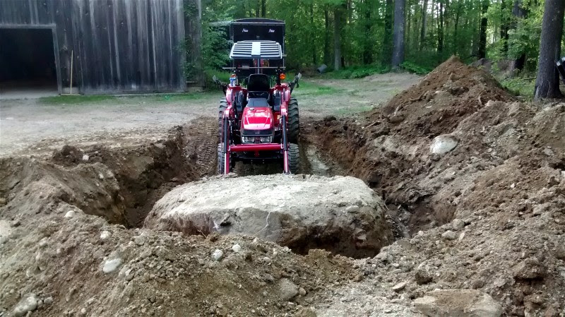

I tried to pull an old set of concrete stairs with my L3901, stairs were about 4 feet wide and 3 feet tall. Aftering digging a place to roll the stairs downhill I had no luck whatsoever pulling pushing or rolling with forks or bucket. Ended up getting some dexpan and a rotary hammer to split the stairs in half before I was able to move them. Years ago a local farmer tried to pull the same stairs with his 70hp dual rear wheeled tractor and just snapped a 5/16 transport chain before moving it. Your tractor is about 200lbs heavier than mine on base weight.
