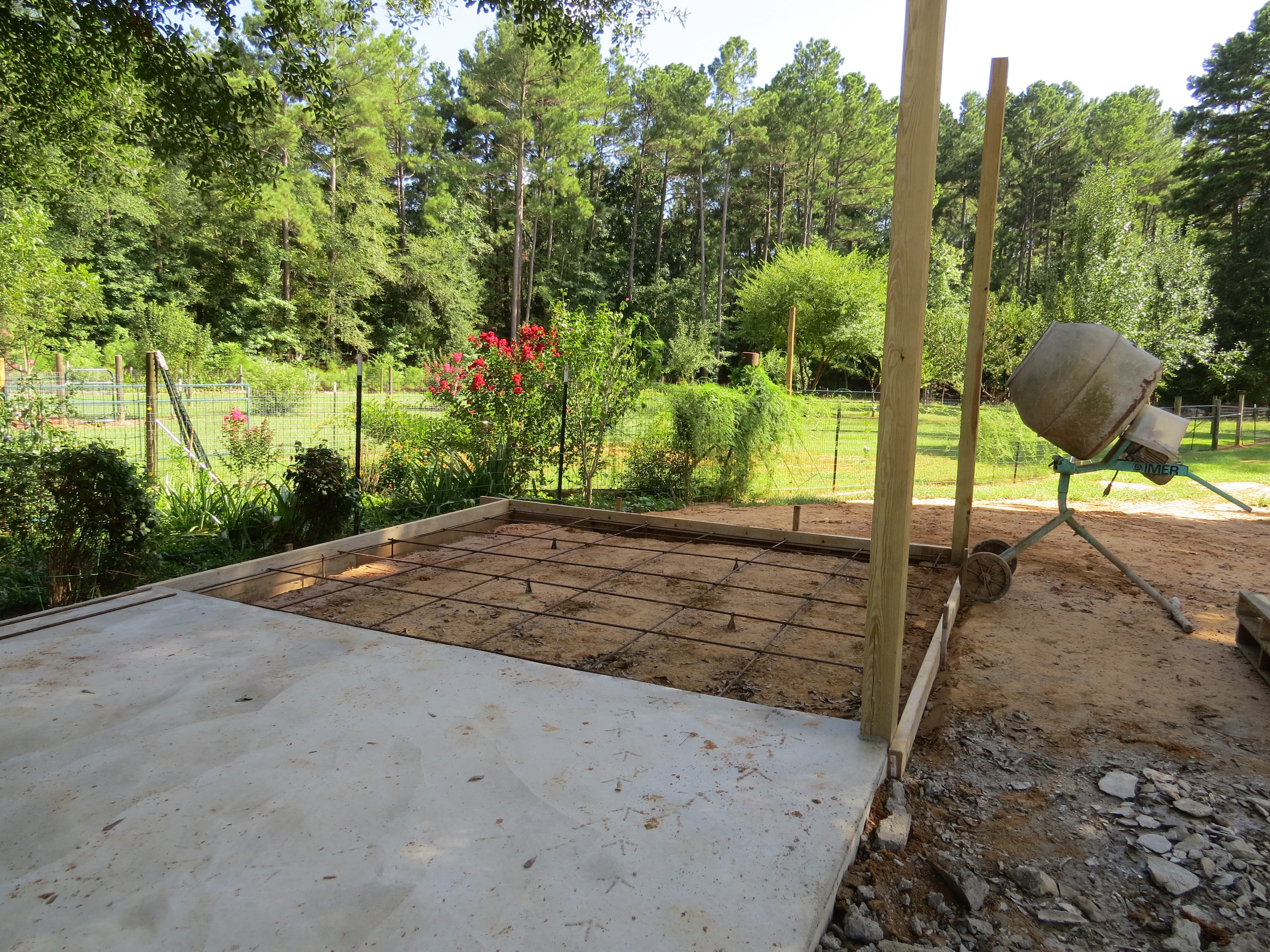

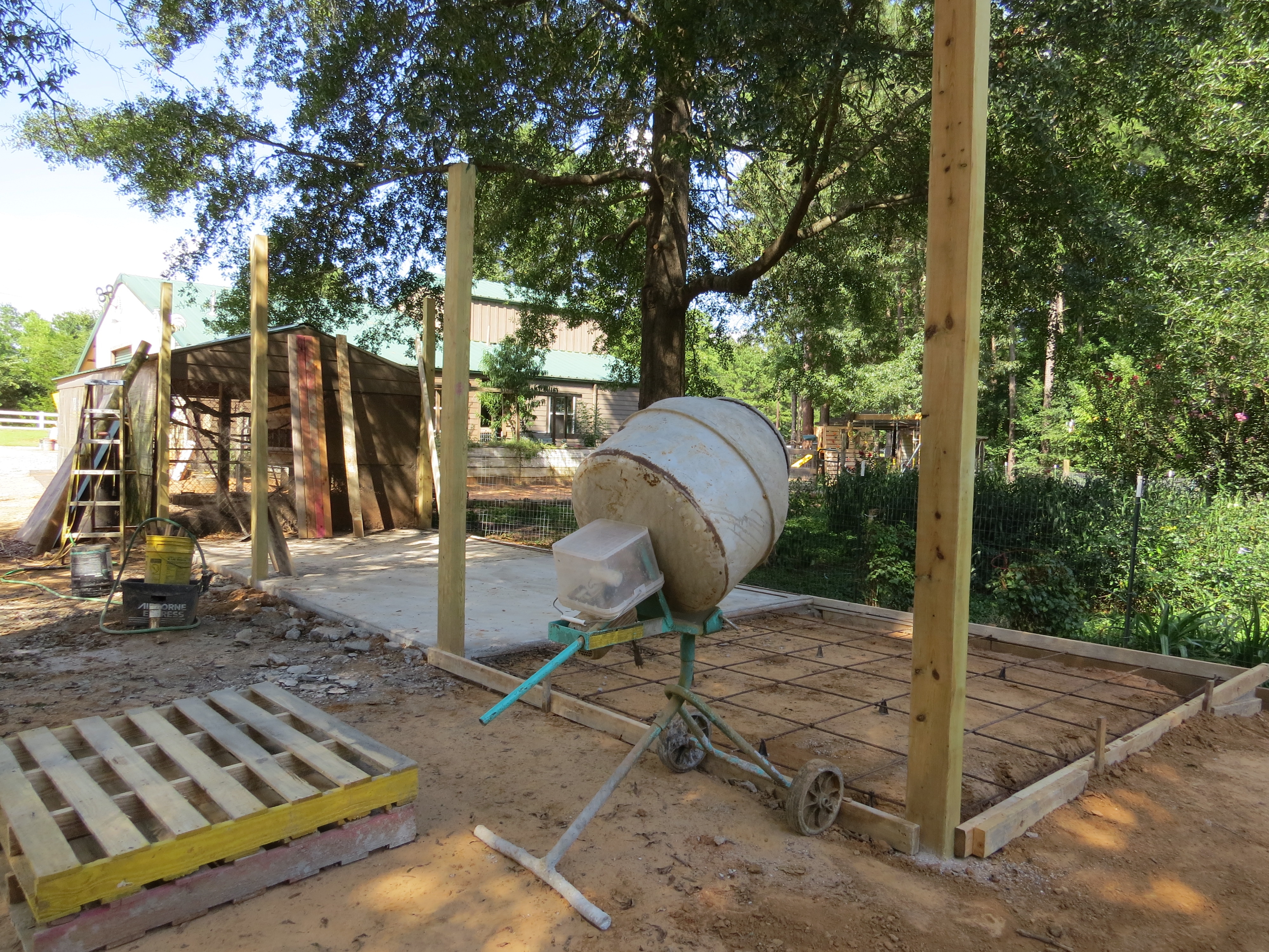

Eddie (and Paul) -
Great!
Two questions - How do you tie in the separate pads? (or do you?) And if you just lay rebar sticking out, how much length do you run for overlap?
I've never done dowels.
In my opinion, if I had hired it out, it would have been one big pour. So, my thinking is that I want rebar connecting all three pours to make it as close to one big pad as possible. I did the same thing with my shed. Three pours that where 10x10 to give me a 10x30 shed for my lawn mowers and other stuff.
I don't put anything between each pad. I just pour the concrete right up next to it. My thinking is that if it's going to expand and contract from the heat and cold, it's such a small amount of movement that it won't affect anything. In other parts of the country, this might be an issue, but for me, it's not.
If I can, I leave a foot to a foot and a half of rebar sticking out of the pad to connect to the next pad. Where I'm connoting to existing concrete, like the garage, I drill into the concrete with my SDS Plus rotary hammer drill. I use a half inch bit for 3/8 rebar. I fill the hole with PL Construction Glue and hammer in the rebar.
I finished getting the third pad ready for concrete last night. Saturday morning I'll be up at first light and mixing 60 pound sacks!!
