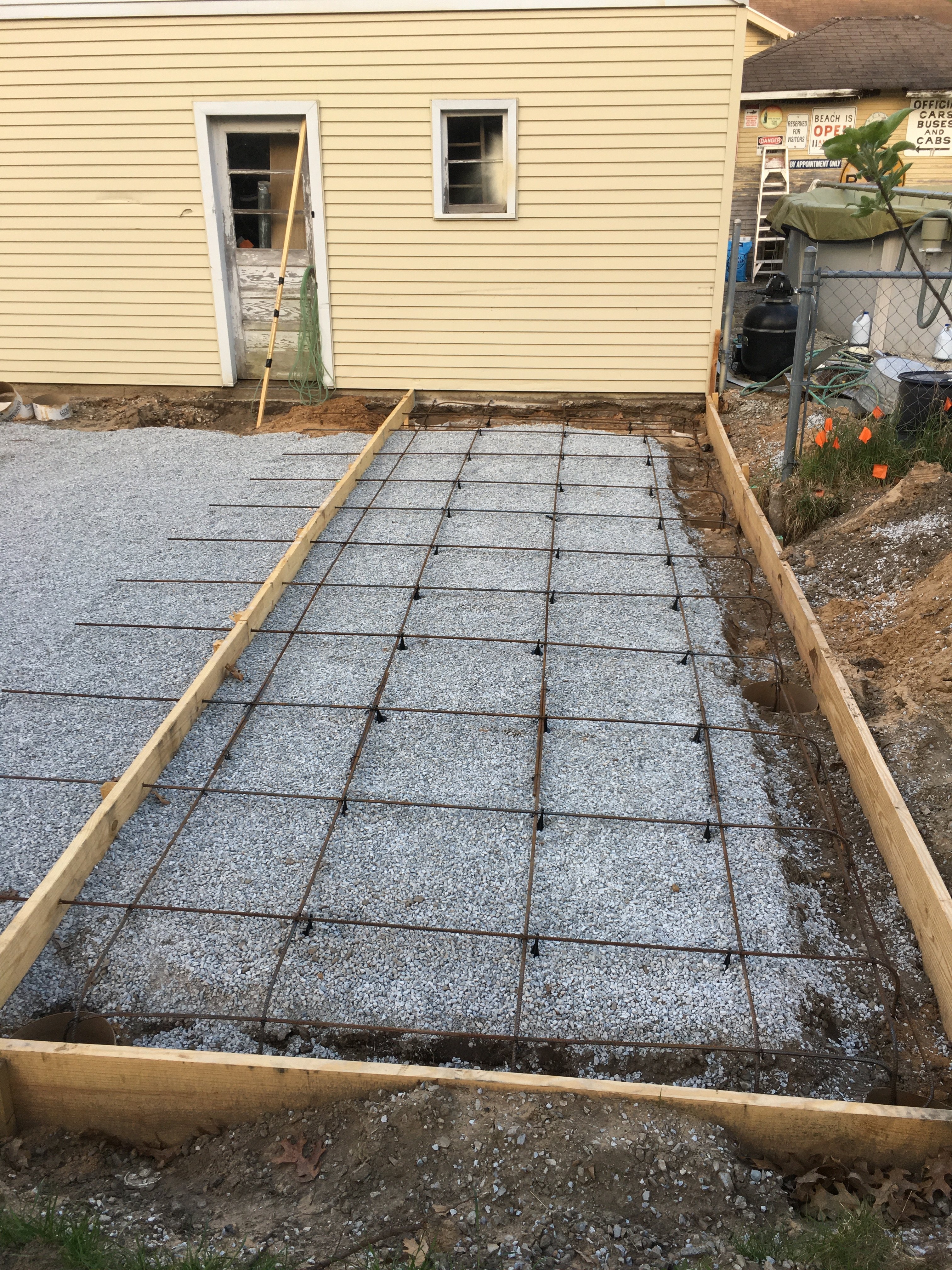

I personally will only use rebar in a concrete pad. It will be set on chairs so it's in the middle of the pad. Wire is impossible to walk on and keep in the middle of the pad. The most common lie told with concrete is that they will pull it up while spreading it.
I have my rebar done before I pour my first pad. The form that divides that pads has notches in it so it fits over the rebar. When the concrete is dry, the form comes off, and then goes to the edge of the next pad.

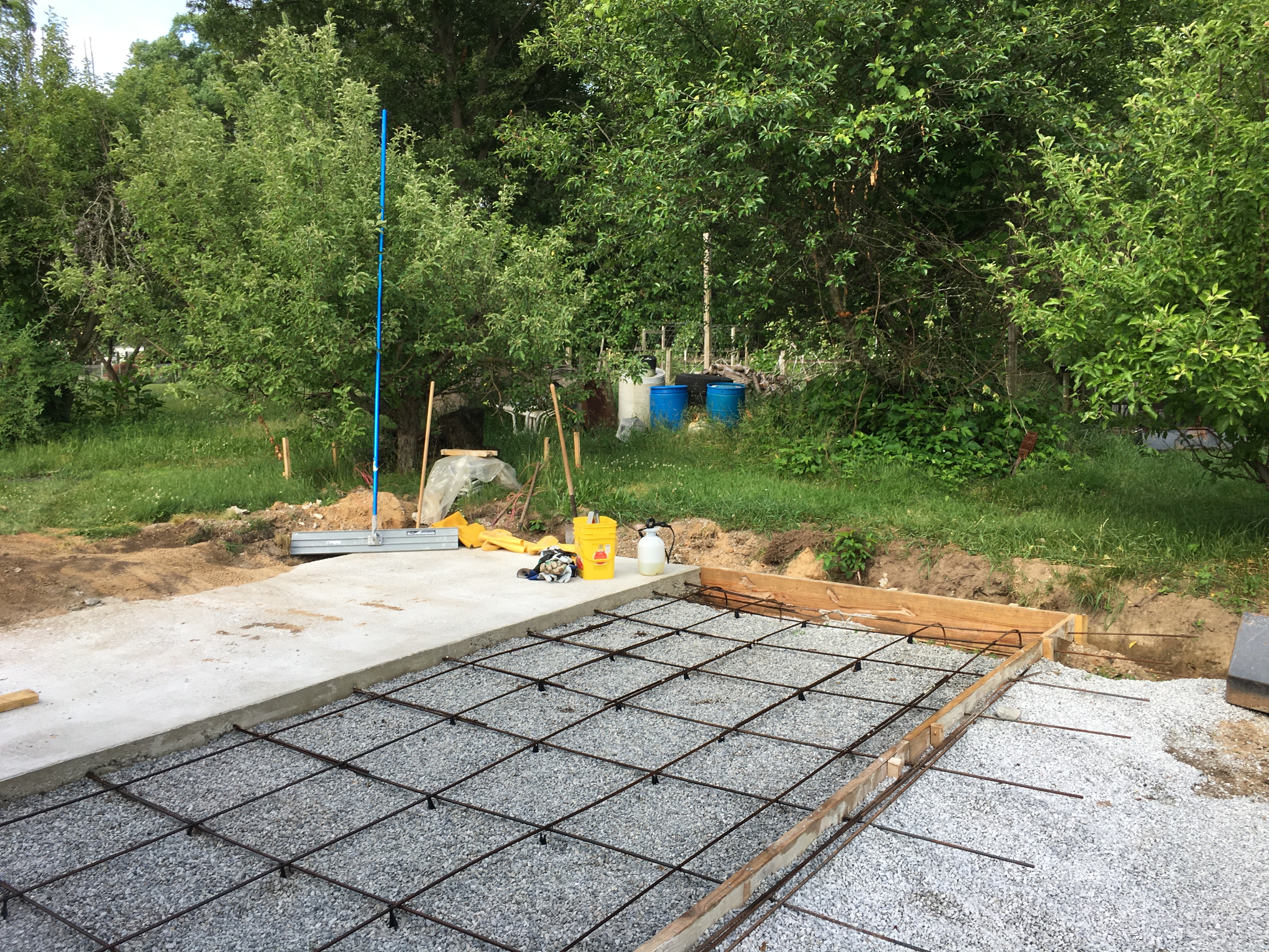

That's pretty much how I did mine, only I didn't notch the side form for the rebar, I drilled a hole.
1st pour
(click to enlarge)
2nd pour
(click to enlarge)

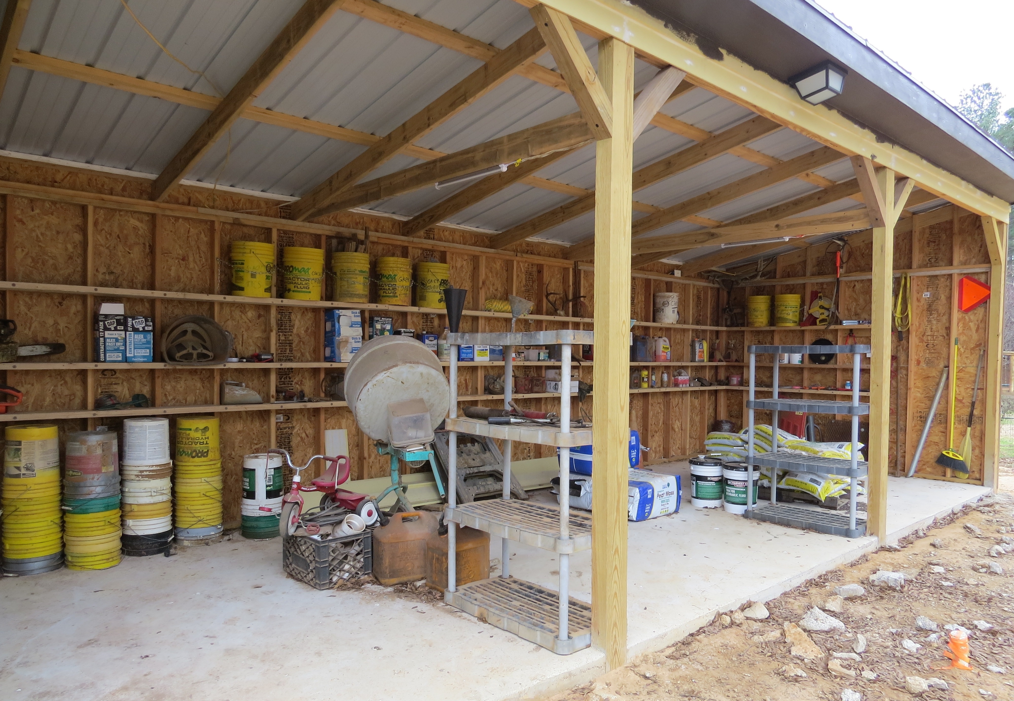

I'd read a lot of your posts well before my garage project, so I was convinced on the rebar on chairs VS wire mesh. The rebar wasn't very expensive at all, I bought a cheap bender, but only used it for really tight 90s. Most of the time I just bent it over my knee..... GRRRRRRR!!!!!! AAAHHHHH!!!!! :ROFLMAO:
But I did use a lot of it. Several down the footing tubes, several in the skirt around the edges, drilled and epoxied into the existing garage slab every couple feet and about a 2'x2' grid in the whole thing.
Since I used 2x6 in center, I had at least 5.5" to work with to keep the rebar in the center of the slab. The outsides were 2x12".
Building inspector seemed happy.
Originally, I thought I could just do a slab with no footings. A contractor told me that since I was adding X square feet to an existing building, even though that original building was just a slab, the total square feet of the entire structure was over the square foot limit and would require a full frost wall on footings. So I was looking at 96' of 4' wall on a 12" footing on all four sides. That was going to double the budget for the entire garage addition.
So I went to the county building department and asked why I had to do full wall below frost line when neighbor did the exact same thing, but a pole barn, and only needed sonotube footings under each post?
He said pole barn is different than stick built. I asked how? He said the footings supported the posts. To which I said, "and nothing is supporting the slab, since it's poured directly on the dirt, not on any footings." And I asked if I could just put in 4' footings every 8' like the pole barn, tie them into the skirt wall of the slabs, pour the slab over the tops of the footings and everything would be supported. I'd even put footing every 8' inside the slab as well.
He agreed and let me do it. So I went from 96' of 4' wall to 16 of 4'x12" sonotubes. That was a huge savings for us. (y)
