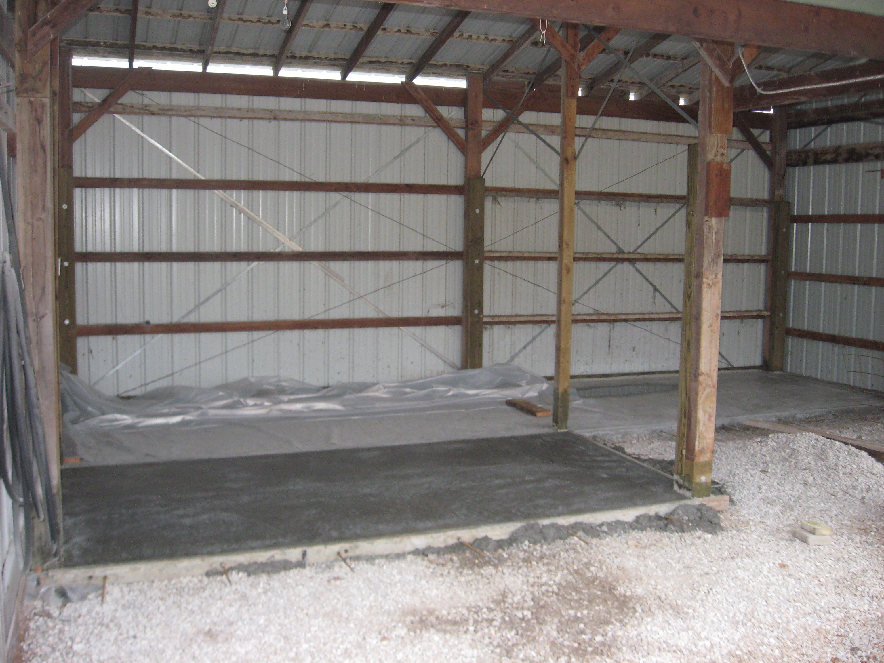

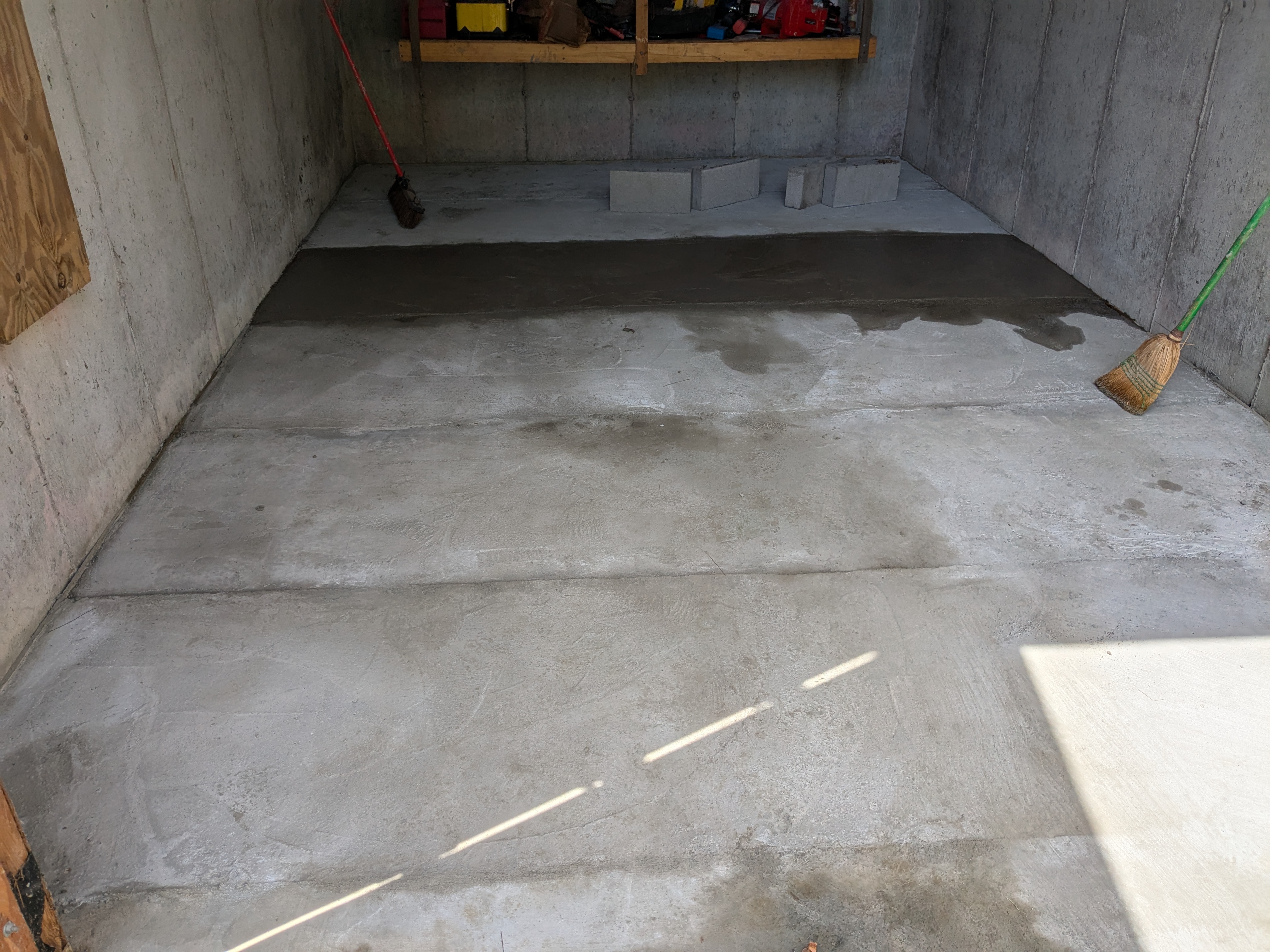

About a decade ago I needed concrete for an area that would be hard to get a full size truck mixer into. I found a a place that rented “you tow it” concrete. Basically a trailer mounted mixer that held 2 cubic yards of concrete. They load the dry mix and you add the water at home and turn on the mixer. Those units can be truck towed and get into as tight a spot as you can back it into. Break up your slab into 2 yard sections.
But, also in most places there are small concrete contractors who will do small jobs. Maybe search a bit more.
There is one local guy that will deliver in this set up, and about 1h away there is a rental company you can do it yourself. Only thing difference, it's redimix, and you don't add water. The catch with the rental place, the 1 cy of concrete includes 1 hour of rental; but the issue, it's 1 h away, you need to pour, clean up, and then... what take it back and hope 2 hours it hasn't gone too far to finish. I would want to at very least float and edge. After 2 hours, on a cool day, sure you can still work a cream back up, and broom, but on a hot day...

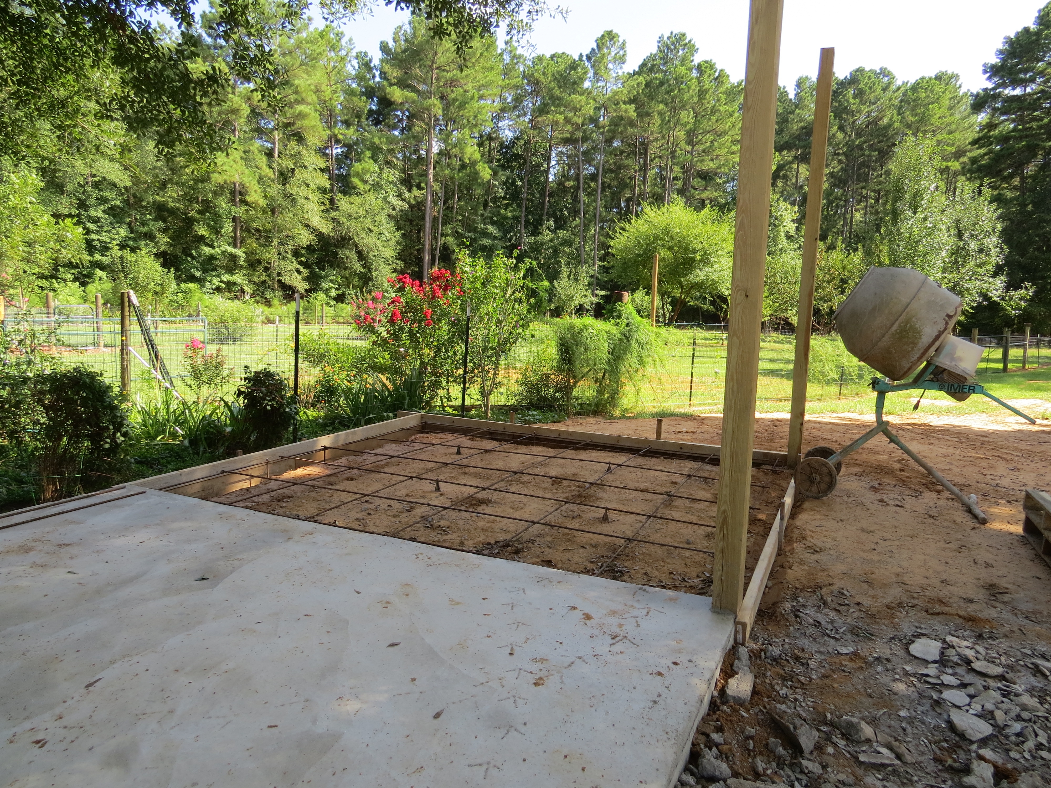

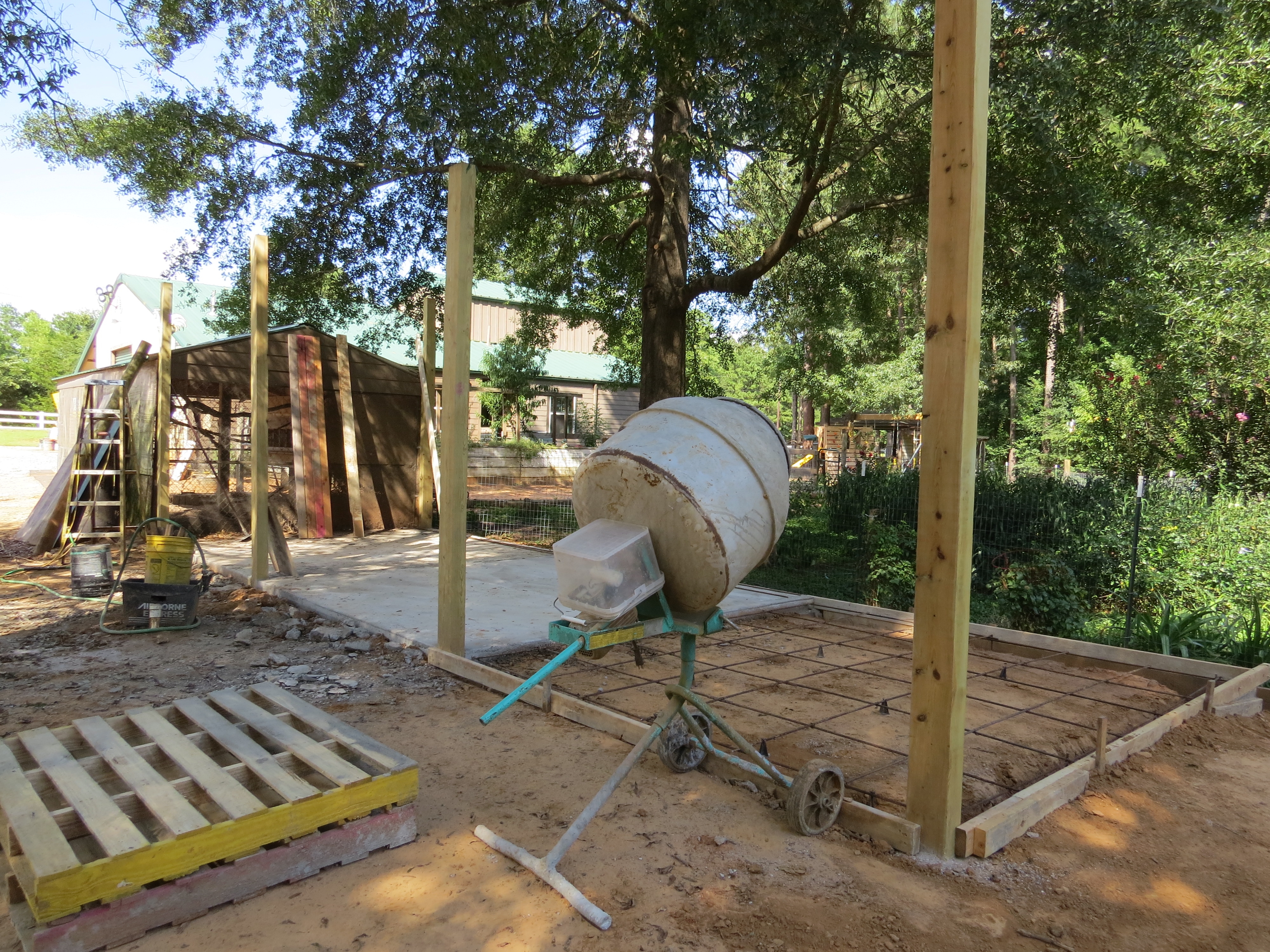

I poured a slab using 60 lb bags pretty much like runner, I did buy a mixer from Harbor Freight only problem was if you did not keep grease on the gear it would lock up. Not a big deal just something you had to be aware of.
Kind of a pain to clean at the end of the day since I was pretty much worn out. It took me several weeks working on weekends.
I also laid down a sheet of 4X8 plywood making it easier to move the mixer around.
I don't remember how many bags but I was working alone outside so the weather had to be considered
I also made it less than perfectly smooth.
Only thing I could recommend, no matter how you do it, pace yourself and know your limitations once you start a section you have to finish it.

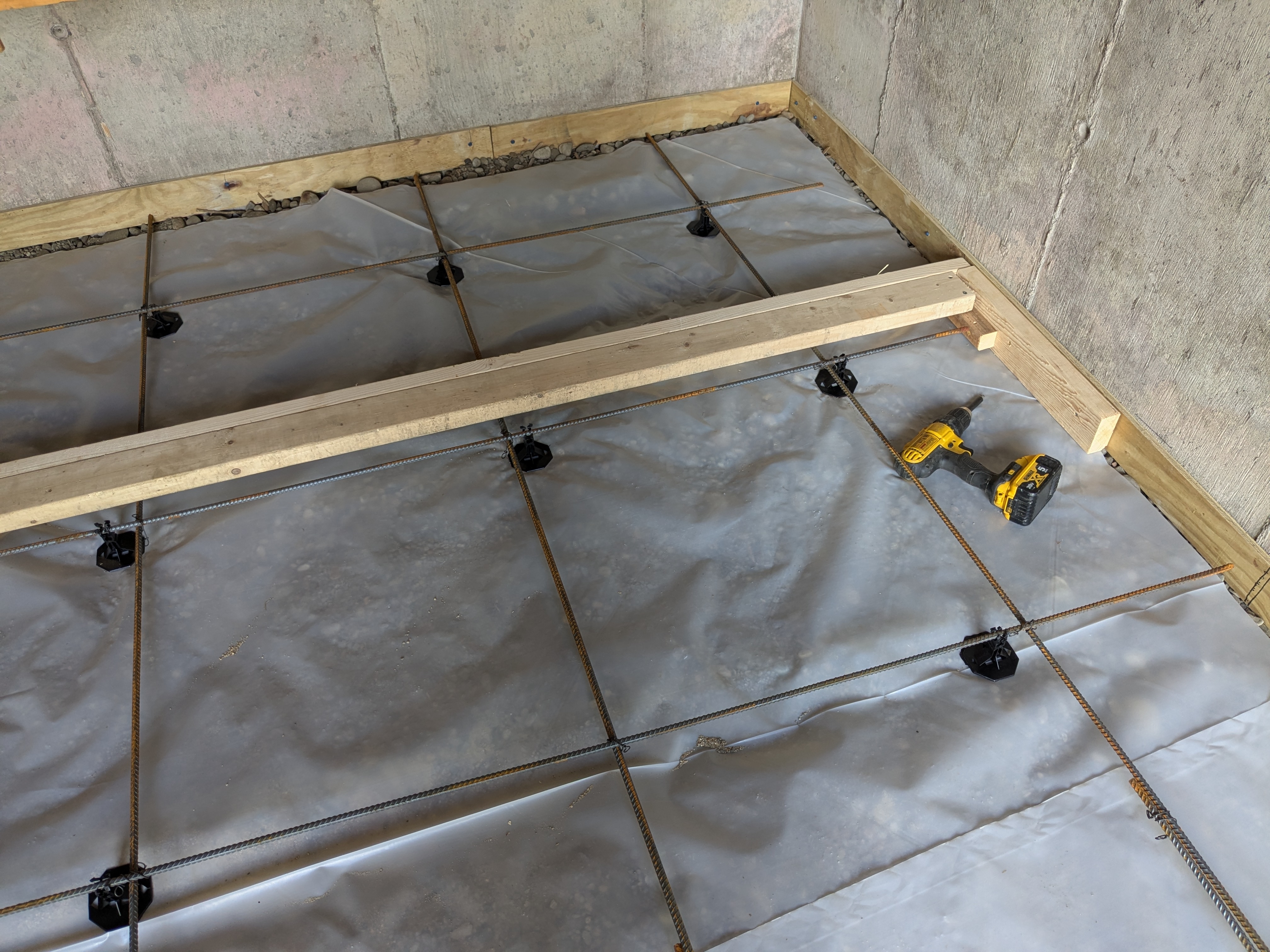

I personally will only use rebar in a concrete pad. It will be set on chairs so it's in the middle of the pad. Wire is impossible to walk on and keep in the middle of the pad. The most common lie told with concrete is that they will pull it up while spreading it.
I have my rebar done before I pour my first pad. The form that divides that pads has notches in it so it fits over the rebar. When the concrete is dry, the form comes off, and then goes to the edge of the next pad.
Pouring one pad in a day wears me out, so I do them once a week. During the week, I buy another pallet of concrete, move my forms, clean up the area and stage everything for the next pour on Saturday morning. I'm in no rush to finish, and the more time I take to get everything in place, the easier it goes.
