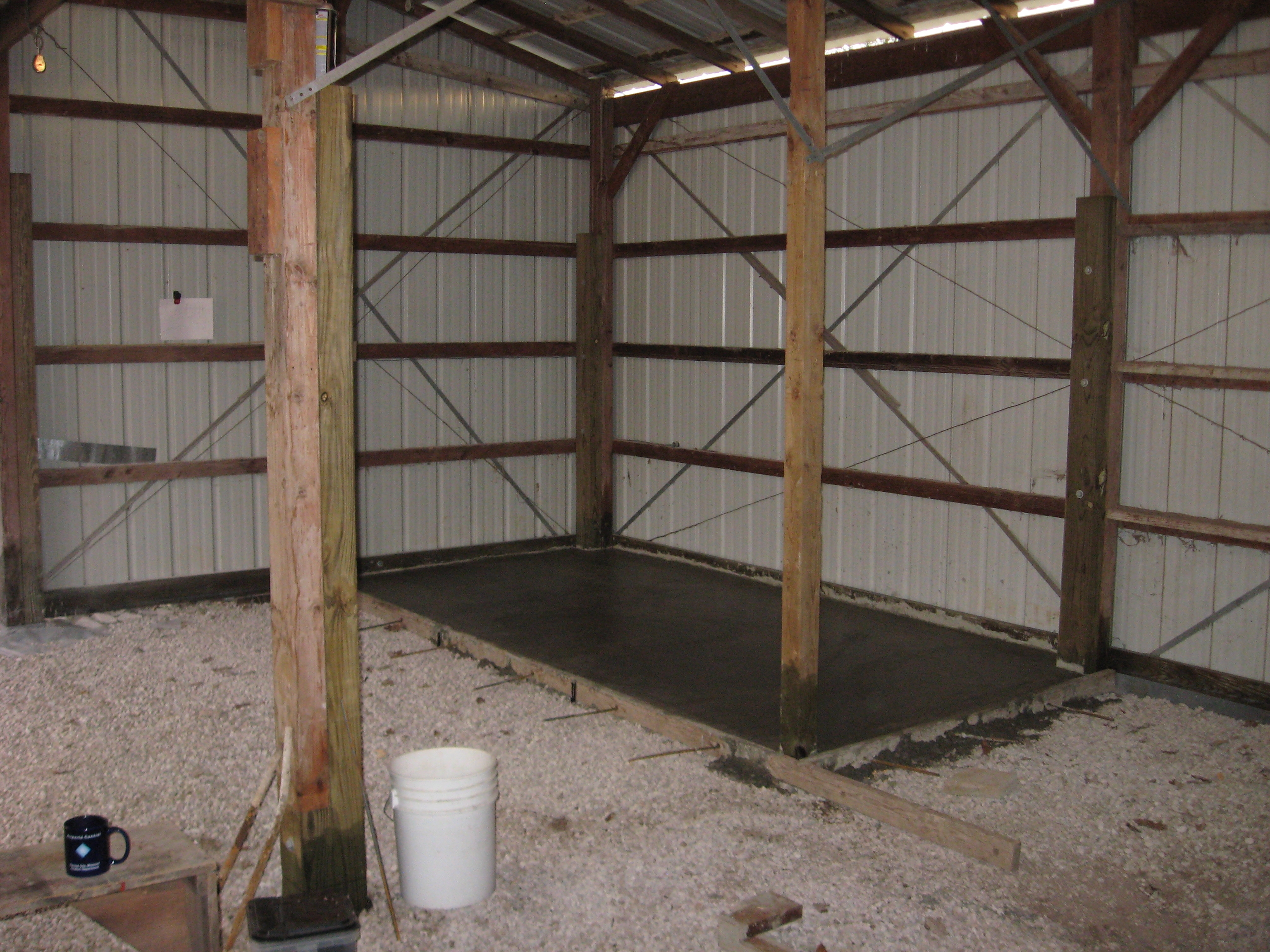

When I did my pole barn floor, I left about a foot sticking out beyond the forms to tie the slabs together. That was 9 years ago and it seems to have worked out OK.
   / How big of a slab could I do by myself? #151
That's the same way I did our garage addition... by running the rebar through the form. It helped to keep the rebar in the center of the slab, and I used chairs wired to the underside of the rebar as well throughout the slab.
When I did the adjacent slab, I'd just wire it with that 12-18" overhang in two places so it couldn't shift, and I ran a piece perpendicular across the joints and wired them. It wasn't going anywhere. ;)

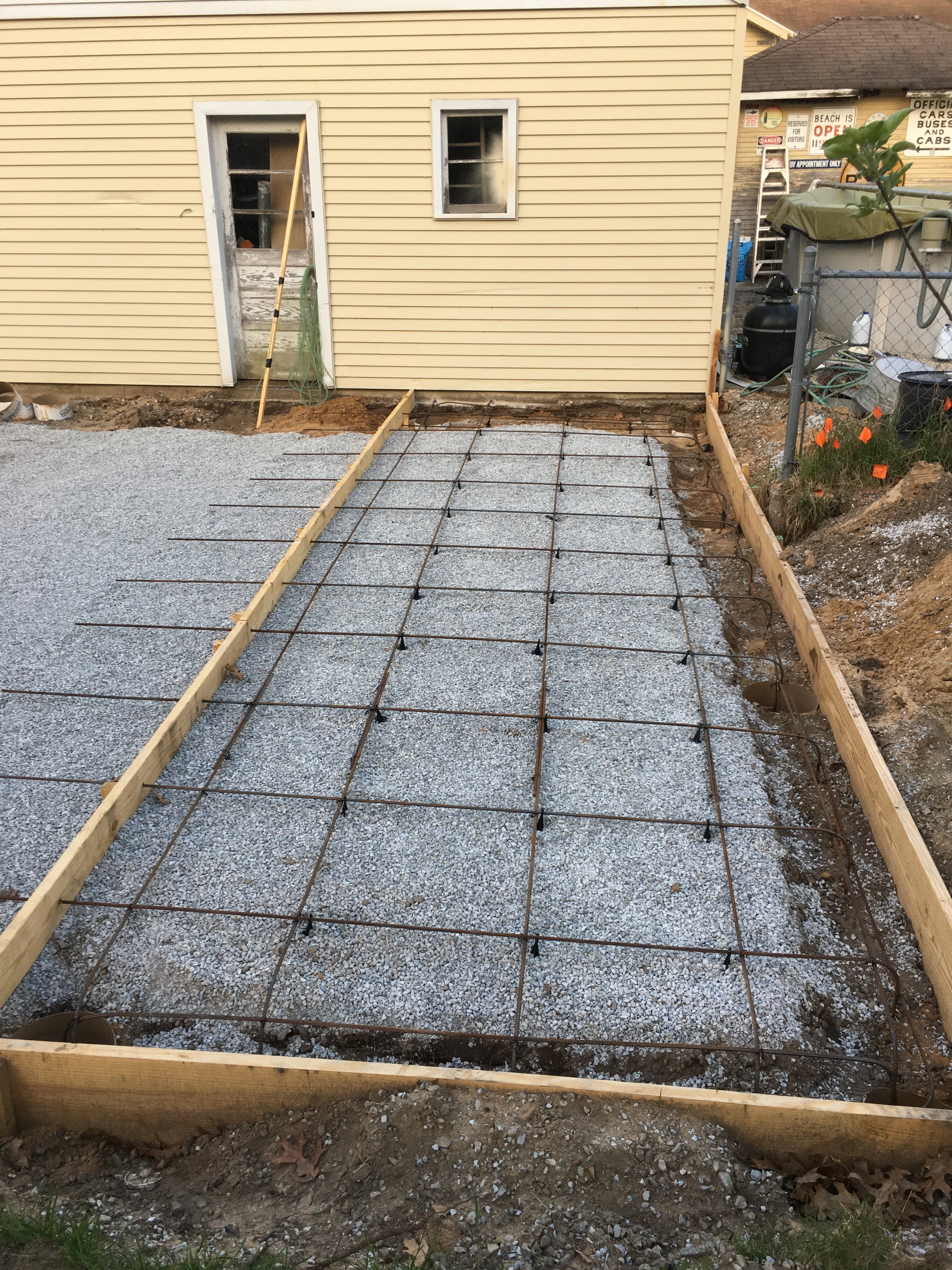

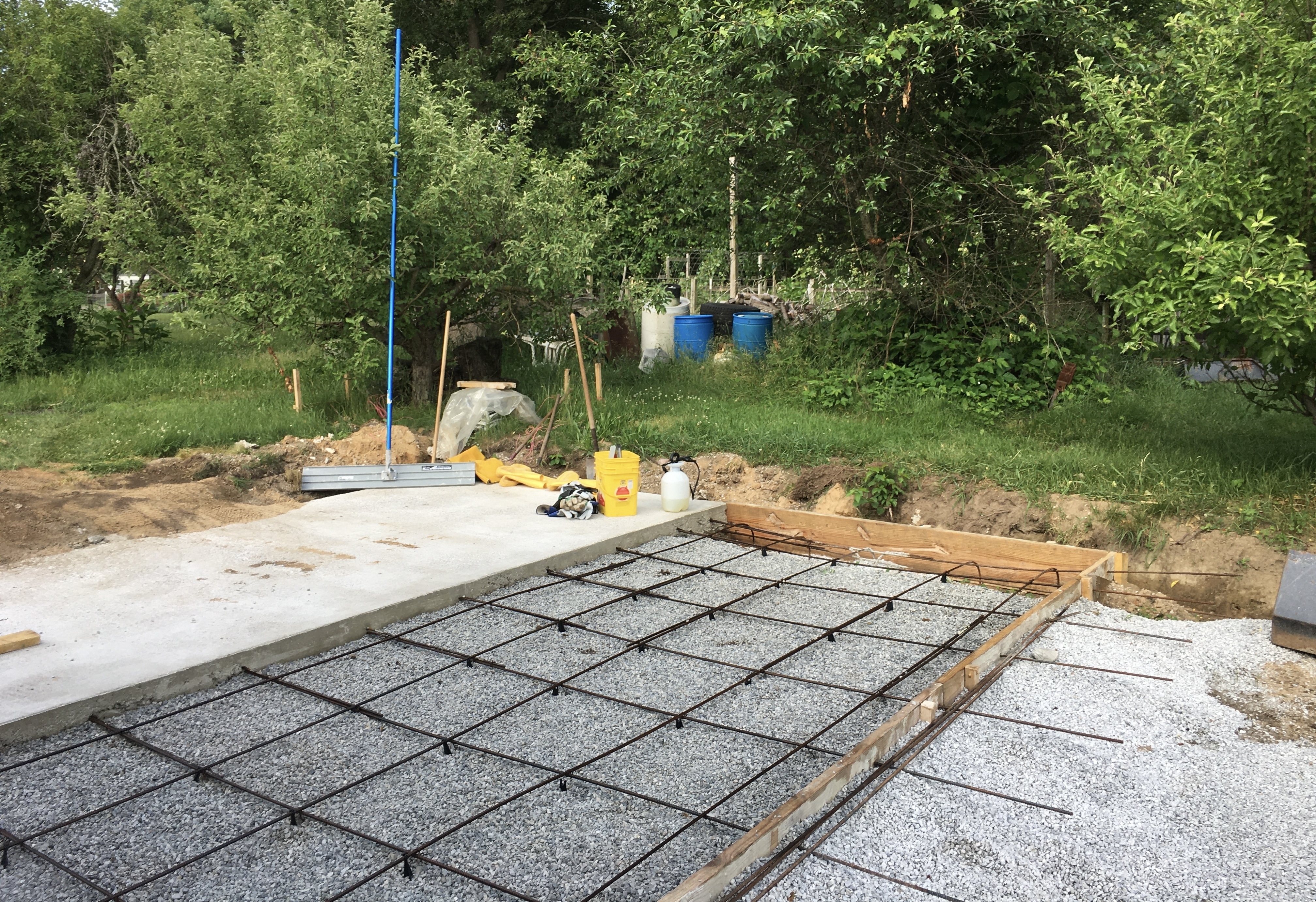

See post #62 in this thread. šŸ™ƒ
First slab ready to pour...
(click to enlarge)
Second slab ready to pour...
(click to enlarge)
You can see the rebar for the 1st slab tied to the 2nd slab.
I used 2x6 so the concrete is about 5-5.5" thick.
(click to enlarge)
(click to enlarge)
If you look at picture one above, I had to drill and epoxy pins into the existing garage foundation so the new slab(s) would be tied to the old slab and wouldn't move around. I tied the pins to the rebar in the new slab(s).
