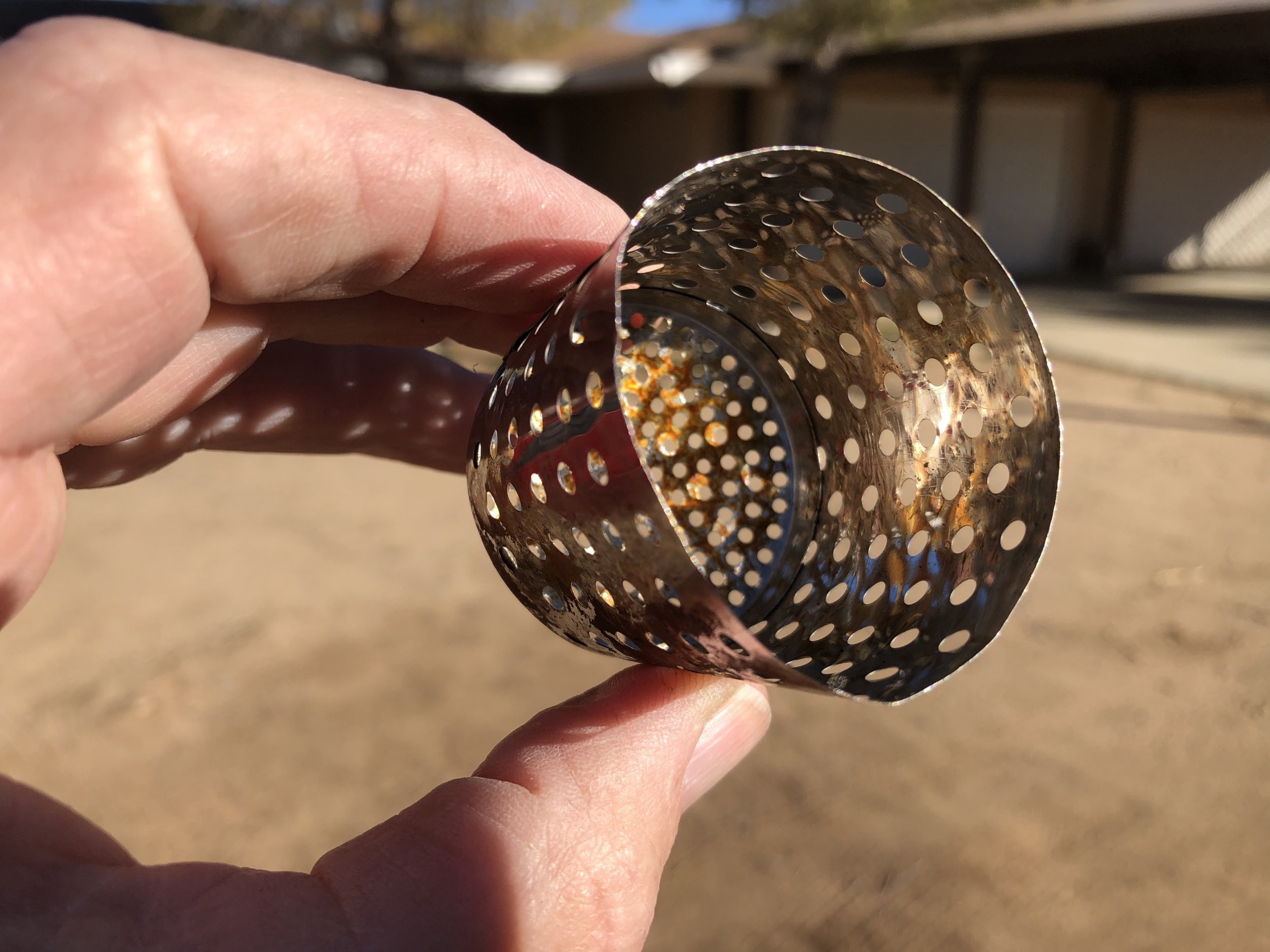

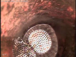

My grandson had the drain in his shower run slow. He tried rooting it several times withou luck. He hired a rooter service and they could not get past a couple of feet before rejection. He then had them camera it to see what the issue was.
Here is what they saw.
They quoted him $3800 to jack hammer out the floor and then replace the tile.
I said that’s crazy and let me see what I can do. I thought about it for a while and said, I wonder if I can pull it out with my shop vac. Stuck it on the drain and in 2 seconds…
Here’s the result.
View attachment 782852Here is what they saw.
Here’s the result.

My first try would have been a long bolt screwed into one of the holes. If that didn't work I probably would not have thought about suction.
I actually tried that first. BUT I had to go through the trap first. I found an old manual snake and welded a small wood screw to the end. It flopped around too much to catch in a hole which were maybe 1/16”. Plan B was vacuum.
