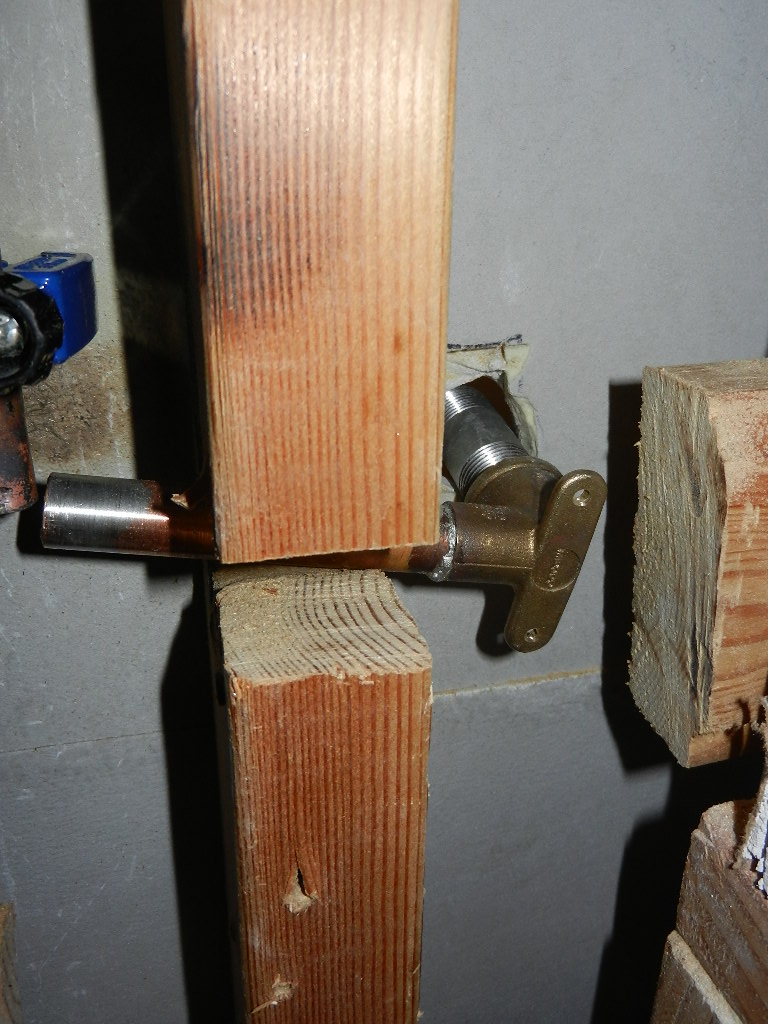

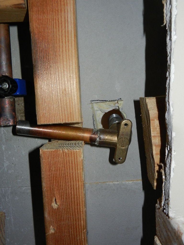

Update: I've cut away most of the wood. Notched the 2x4 that the pipe goes through. Looks like, how to describe this, looks like the hole in the 2x4 wasn't at an optimal spot so when you turned 90 degrees, it caused the fitting to hit the wood (INSIDE the hole) forcing it at an odd angle, giving me my issues)
I took my oscillating saw and notched it so I can simply slide the copper in/out via the slot verses the hole....discovered this issue so chipped away on the back side of the "hole" allowing the fittings to turn the corner a bit more tight.
I can't get the union off easily so I'm going to cut it.
Dawned on me....I can get my 90 to turn the corner and maybe use a pair of street 45's to wiggle the angle a bit and give me more broad coverage.
I think this is going to work.

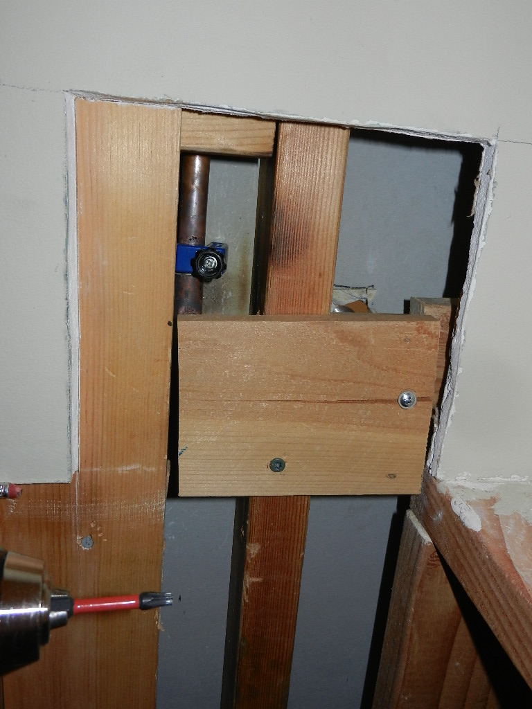

Where I cut the wood and now have "nothing" behind the ears to screw them to.... I'm going to mount a short piece of 2x4 to screw the fitting to and then I'll screw another 1x6 behind it making it flush with the studs and then I'll have something supporting the drywall (not really an issue for this small area.... but it will actually support the fitting with the ears)

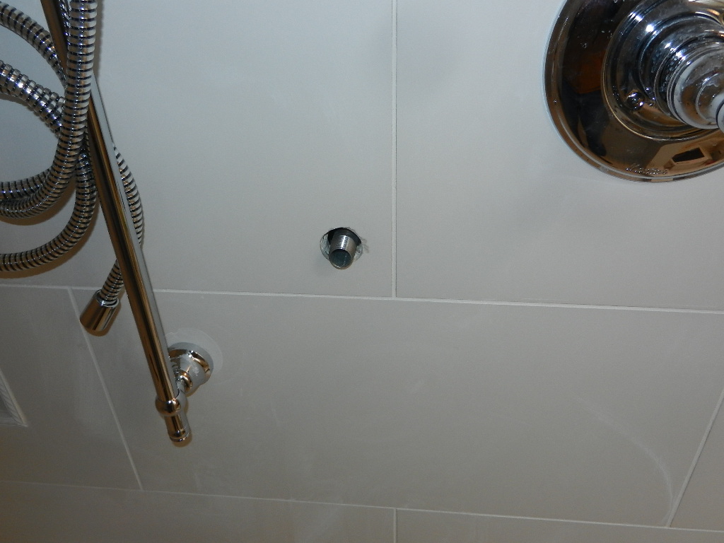

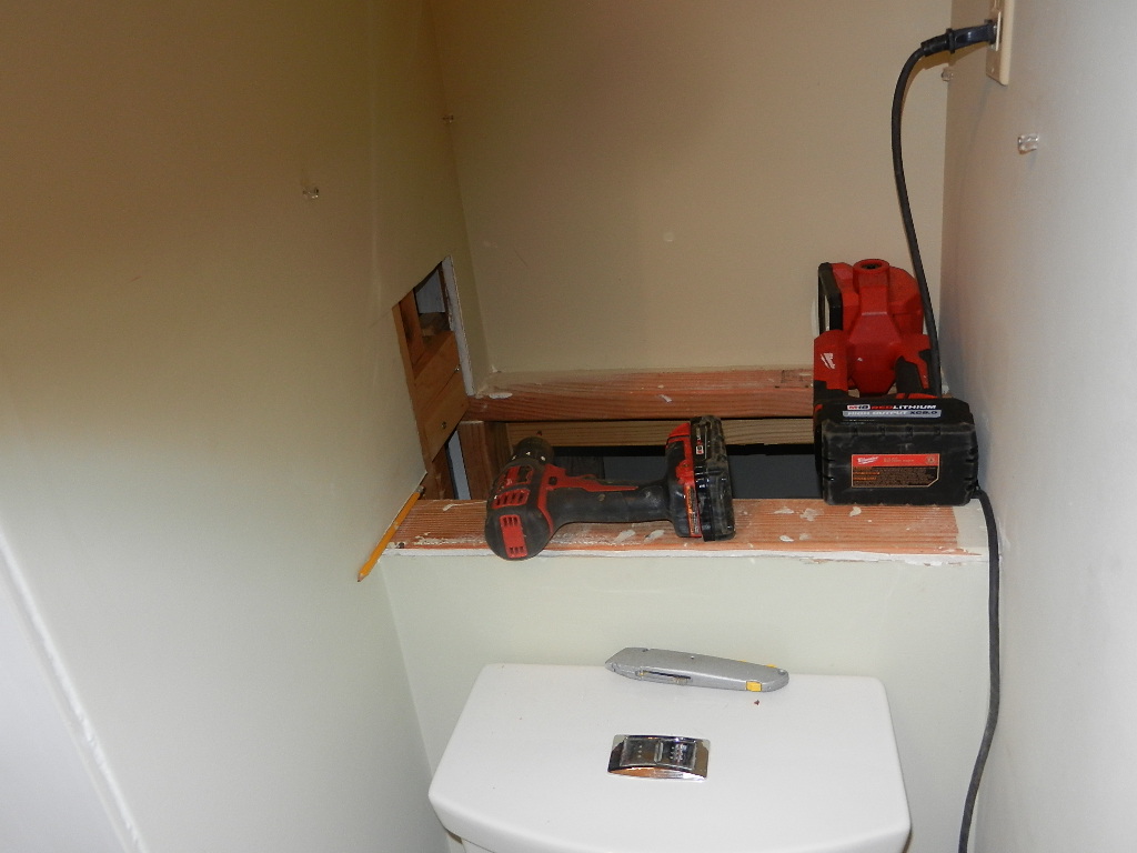

Waiting on wife so grabbed a couple pictures.
Hole in shower where it goes
Toilet area that I'm working behind
Temporary parts to size things and see if the idea is going to work
Wood removed to see the cuts
My goal is to fit things and mount the ears to the wood...."finalize" those fittings and install the base for the hand held. Meanwhile, I'll have the copper parts fitted together, prepped, fluxed BUT not yet soldered.... so I can wiggle things and once everything seems to fit (and I already have the pipe correctly placed and the base mounted) I'll solder all the fittings.
