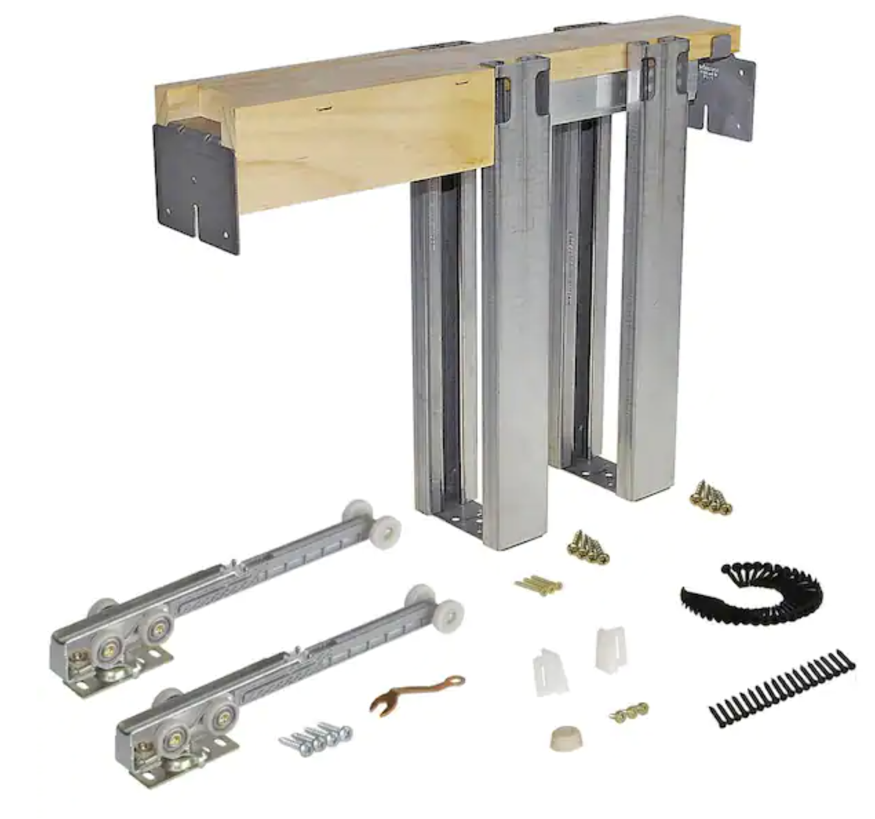

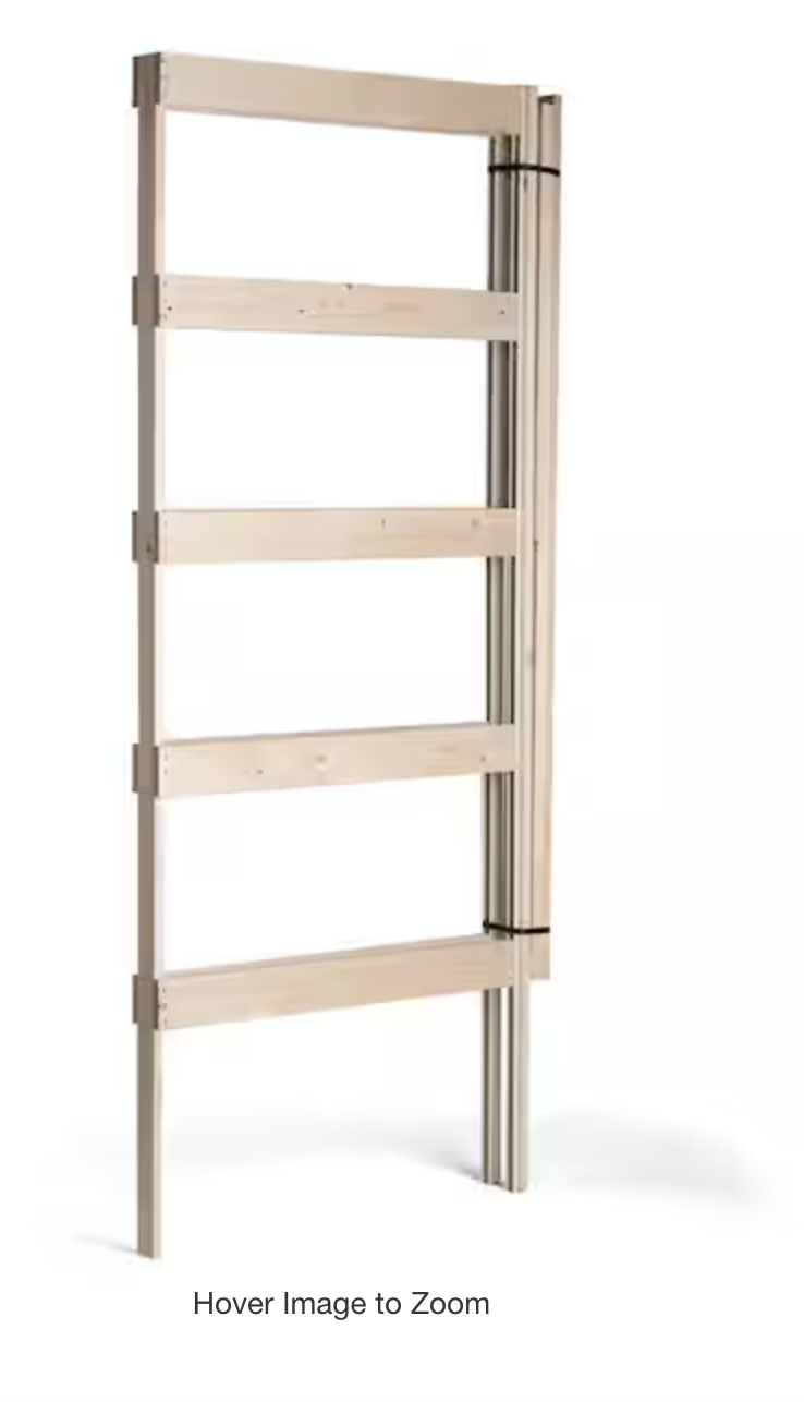

I am about to install 3 pocket doors in my addition. I have done this before but it has been years. There are 2 types of pocket doors readily available at the big box stores. A kit that is pre-built with wooden sides for drywall and a kit that you build in place with metal studs.
Screenshot 2024-09-20 at 8.57.08 AM.pngScreenshot 2024-09-20 at 8.56.46 AM.png
The build in place one is $100 cheaper and comes in a soft close/open variety. I wanted to use that one, but here is the caveat. 2 of these pocket doors will be in the side wall of our walk thru closet, one in my wifes side wall one in mine. I feel like the version with horizontal wooden sides will make for a more versatile and usable wall than 2 measly metal studs. The wooden horizontal one could allow hooks to be used in that wall. The 2 metal studs really do not help much at all at all. I do kind of like the soft open and close option. If I use that one I will immediately buy a backup set of rollers though, in case these screw up 10 years from now and the same ones are not available.
AM I OVER THINKING THIS? OF COURSE I AM! I have done that for every step of the way and I will continue to do so until I am done, that is how I do things. I plan on living here until the cart my old a$$ out on in a wheel chair.
Whatcha think? Also any pocket door tips, tricks, warnings or guidance is graciously accepted as well. HAPPY FRIDAY Y'ALL!

Metal studs may not appear to be as strong, but won't change much with changes in humidity. The strength depends on also having drywall installed over them. I've built walls with thin metal studs. They are straighter, lighter, and strong once put together. The disadvantage, IMO, is if you have to run electric lines through them and then they require the installation of sleeves to protect the lines from the sharp edges of metal.

The wooden ones are very simple and easy to install. The biggest issue is to make sure you use really short sheetrock screws when attaching sheetrock to the horizontal 1x4's so nothing pokes through the wood and scratches the door.

I’ve put in dozens of pocket doors over the years. Generally I prefer the wood framed ones. Not sure if they are still built the same, but the wood frame would allow you to fill in the horizontal spaces with more 1x lumber if needed.
The metal stud kits are fine and if you want to make the frame suitable for mounting things on the wall, you can get the clip kit and some 5/8” cdx plywood:

I'd advise against the cheap ones, though really don't have a comment on metal vs wood. Johnson makes good heavy duty ones also, just go to their website and not the big box. And the soft close and open options are worth gold. Not only will it never slam, but it will pull itself open/closed and STAY THERE.

Well I went with the wood prebuilt ones, I feel like they are stronger. And I am on a bit of a time crunch they seem easier to install. I did not go with the soft open and close. Just one more thing to screw up, although it was VERY tempting. All 3 of these doors will be in our master suite so I will only have to worry about a mad wife tearing them up. Thanks for all of the comments.

Oh man, don't skip the soft open/close. If this is your forever house, you will regret it...forever...

Yes. Pocket doors bounce a lot on open and close and the very slightest out of level like 0.001" will make it open (or close) when you don't want it.
The pocket door frame relies on the drywall to stiffen it.
