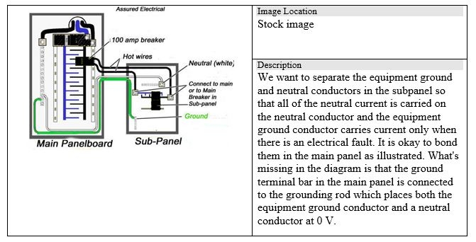

Good morning, I can’t seem to find anyone that can give me a clear answer.
The video below is as close as I have come.
The question is: if the neutral ( in most cases white ) is connected to the same bus bar as the grounds and the neutral is what carries the electricity back to the source ( which is maybe a different topic ) than why are the grounds not energized within the panel ( including but not limited to the exposed ground that I’ve placed on the exterior of my wall to ground the system)

Mostly good info already. A few thoughts from a retired electrichicken:
The neutral and ground are bonded together at the first switch / breaker only. At that point both are also common with the Neutral from the utility, water piping, building steel and any metallic item that can become energized during a fault.
The feed to a subpanel needs to have separate conductors for the neutral and the ground and have separate bars for each.
The ground is not intended to carry current except during a failure / fault, and is only sized large enough to cause a breaker to trip or a fuse to open.
The math is different for Wye and Delta systems. In a delta system the phase to phase voltage is the coil voltage, and the line current is 1.73X the coil current. In a Wye system the phase to phase voltage is 1.73X the coil voltage and the line current is the coil current.
On a Delta system the phase to phase voltage is 2X the low voltage (on TWO of the phases) because one of the transformers has a center tap. Half way between the ends of a 240v coil is 120V. The voltage from the third phase (aka High Leg) to Neutral is over 200V. Instead of half a coil between the neutral and "hot" there are 1-1/2 coils. Although coil / phase to phase voltage is 240V, the High Leg voltage isn't equal to 1.5 times the coil voltage because the voltage in the coils is out of phase (sync) with each other. This configuration has fallen from favor, especially in non-industrial applications. In industry much of the load is 3Ø and 120V loads are minimal.
On a Wye system the voltage from each of the three phases to neutral is 120V and the phase to phase voltage is 208V (1.73X 120V). This system is more widely used for non-industrial applications because every pole in the panel can be utilized and the loads can be balanced better.

Here's how I explain it to my clients:

Also don’t forget that the ground buss and neutral buss are separated in a sub panel.
Beaver Cove. This state is true, in some areas. In some states the neutral is isolated, from the ground
