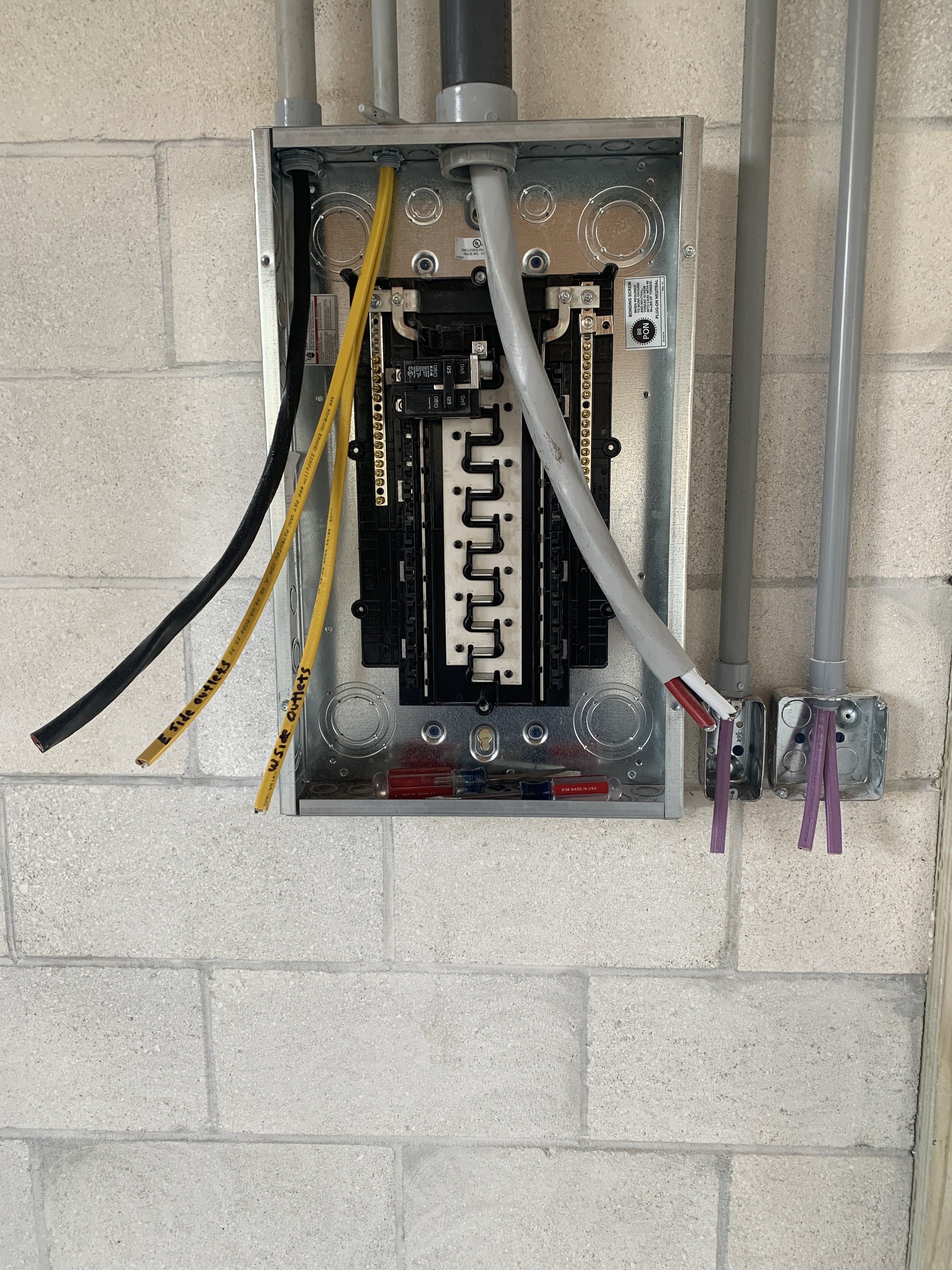

/ Home electrical
Also don’t forget that the ground buss and neutral buss are separated in a sub panel.
I had read this but had not taken the time to look. Sure enough
Thanks for the reminder
Can you tell me why?

/ Home electrical #13
that photo is not actually showing separate grounds, that's a shared neutral ground bar. a separate bus bar would be install if used as a sub panel, you can see the screw holes on the right side.
They only want one central ground to neutral point, deals with potential, they don't want current running over ground unless in safety as it reduces its safety as i "assume" the resistance is a bit higher when there is a current passing through it, that shouldn't be

/ Home electrical #16
In the panel pictured, there is a jumper connecting both of the side bars. On some brand panels you can remove this jumper and add a bonding screw to allow grounds to land on the right bar and neutrals to land on left. But what most electricians do is simply add separate ground busses to the can. In this particular panel, there are also neutral rails added for afci and gfci breakers, so you CANT remove the jumpers. There are pretapped holes for this and every brand of panel sells the buss bars.
This allows for a cleaner installation and ease of wiring.

/ Home electrical #18
I should have zoomed on the photo. That’s a PON panel. I’ve never played with PON breakers before. I think you can still use certain standard breakers with it too.
/ Home electrical #19
The option not to run a subpanel without also running a ground wire went away some time ago. Now you HAVE 2 run 4 wire subpanels, even within the same structure. I dont recall what nec revision this occured.
/ Home electrical #20
Because the neutral at the sub-panel may not be at ground potential.
This would be true if the load on the two phases in the sub-panel is not equal, so there is some current flowing in the neutral. With current flowing, and some small resistance in the neutral conductor, there is a voltage difference between the neutral buss in the sub-panel and the one in the main panel. Probably small, but some.
You want the ground busses in all panels to be a ground potential.
