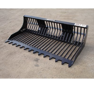

I know your're right IH. My welder doesn't carry the necessary amps and with a pipe bender , a few plates of steel, a couple three gussets I'd have my rock bucket. Its either a grand in tools and materials or a grand for a premade one. I just need one. That little Virnig looks sweet. I think I'd cut off the long side support strap so I could roll back a log or two on it. It even seems to have the right backplate pitch you talked about. Dang if my welder friend that used to live next door to me hadn't moved to Texas, I'd have this thing by now. He had all the tools to fabricate stuff.
   / grapple types #23
After reading this interesting thread, it seems to me someone should invent a "Wood Bucket".
One that specifically addresses the ability to pick up split wood from the splitting pile.
Such as a hydraulic bucket that has rollers on the bucket lip and grapple tips which have small spikes to grab wood and roll it back, much like a wood chipper feed roll. It would be interesting to see exactly what conditions must be met to design within? For a few dollars it could be done.
Hmmm ... see where this is going?

Arrow , in my minds eye you would need to put a cutting edge right across the front of the tynes . This will stop any of the splits wedging between and spreading/bending the tynes . With the cutting edge it would then be an easy matter to "Dolphin swim" the bucket through the pile to get above and below the splits that undoubtably get in the way and stop your entry . Also to be able to lift long lengths , it would be an easy matter to have pin on side straps which could be removed . Maybe some 1 1/2"X3/8" flat bar or angle with a 3/4" hole in each end that would slip over some short Cat 1 linkage pins on the side of the bucket , 4 Lynch pins and their off . A 160 amp welder is as big as you need and a packet of 12P WIA Austarc 3.2mm rods . It will pay for itself many times over through the years and when your finished with it you will get most of your money back when you sell it .

I tell ya IH, when brains were delt out, you and I went to the same store. I've built this thing in my head at least 11teen times. And like you I thought about the front support so the tines would be stabilized. I also had a side delatch system for the long log lengths. I then find a company called Haala Industries and they make almost my perfect bucket except for the smallest being 70" wide. Maybe I'll give thm a call and convince them to make a 60,54 and 48" bucket for us compact owners. I wonder if rebar would be strong enough for the inner tines.

Here's a pic of their bucket
