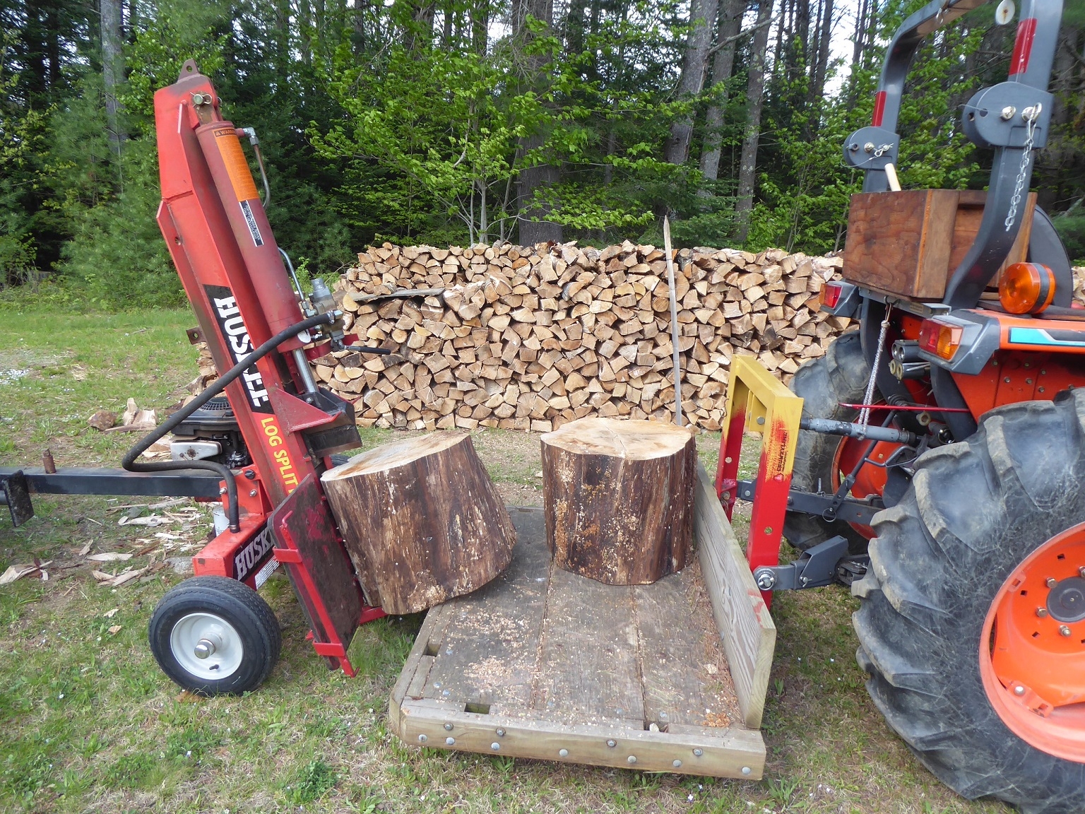

I use the decked carry all as a lifting table for all the big stuff going on to the Horizontal splitter.
Roll the big ones on to the deck, lift with the 3pt, roll the rounds off to the splitter rail.

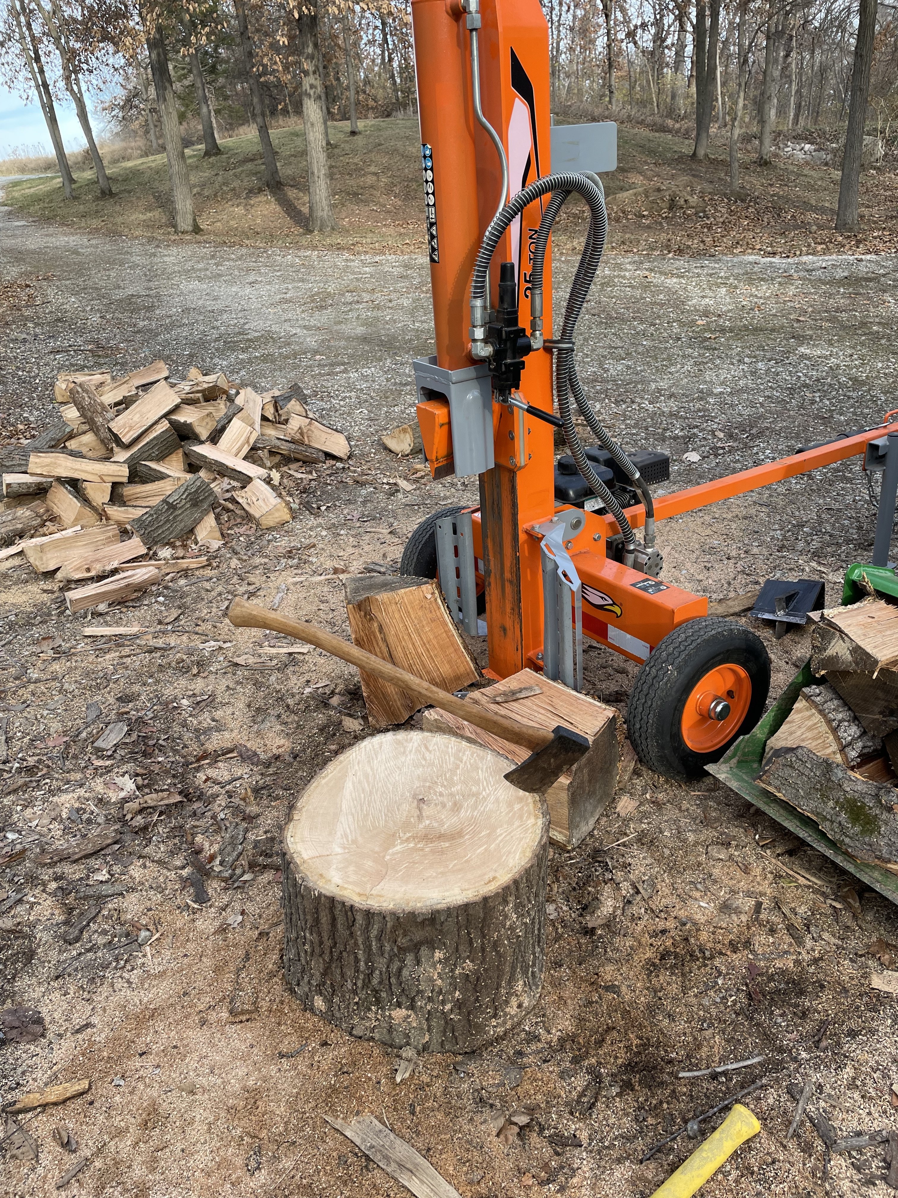

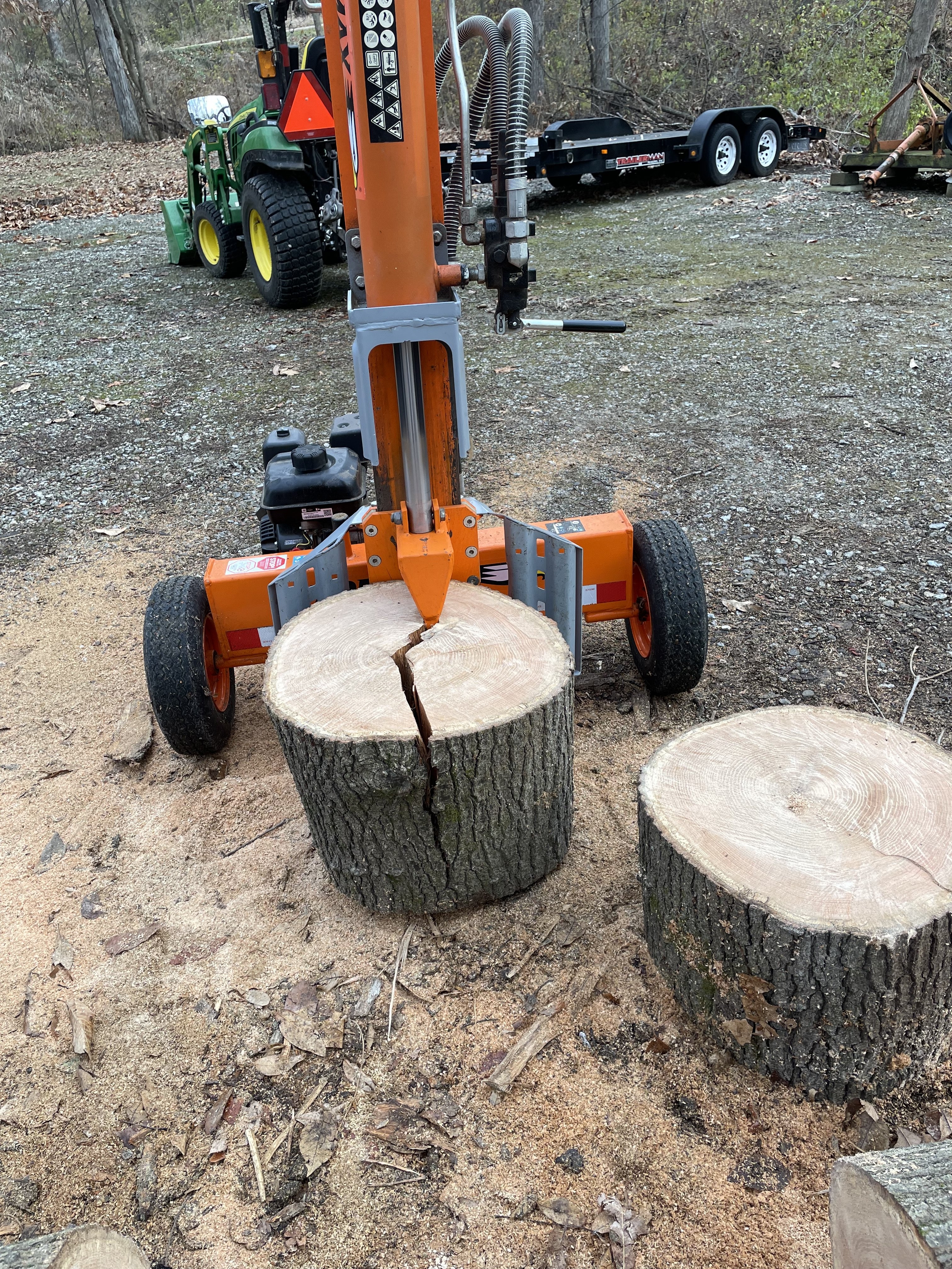

I feel your pain. I'm 37yr old and still very physically capable. Even I don't mess with firewood rounds that large unless I noodle them first. My 461 28" bar full chisel chain takes care of the noodling no problem. I use splitter horizontal and pull tractor bucket right up to splitter level, and use that as my table.

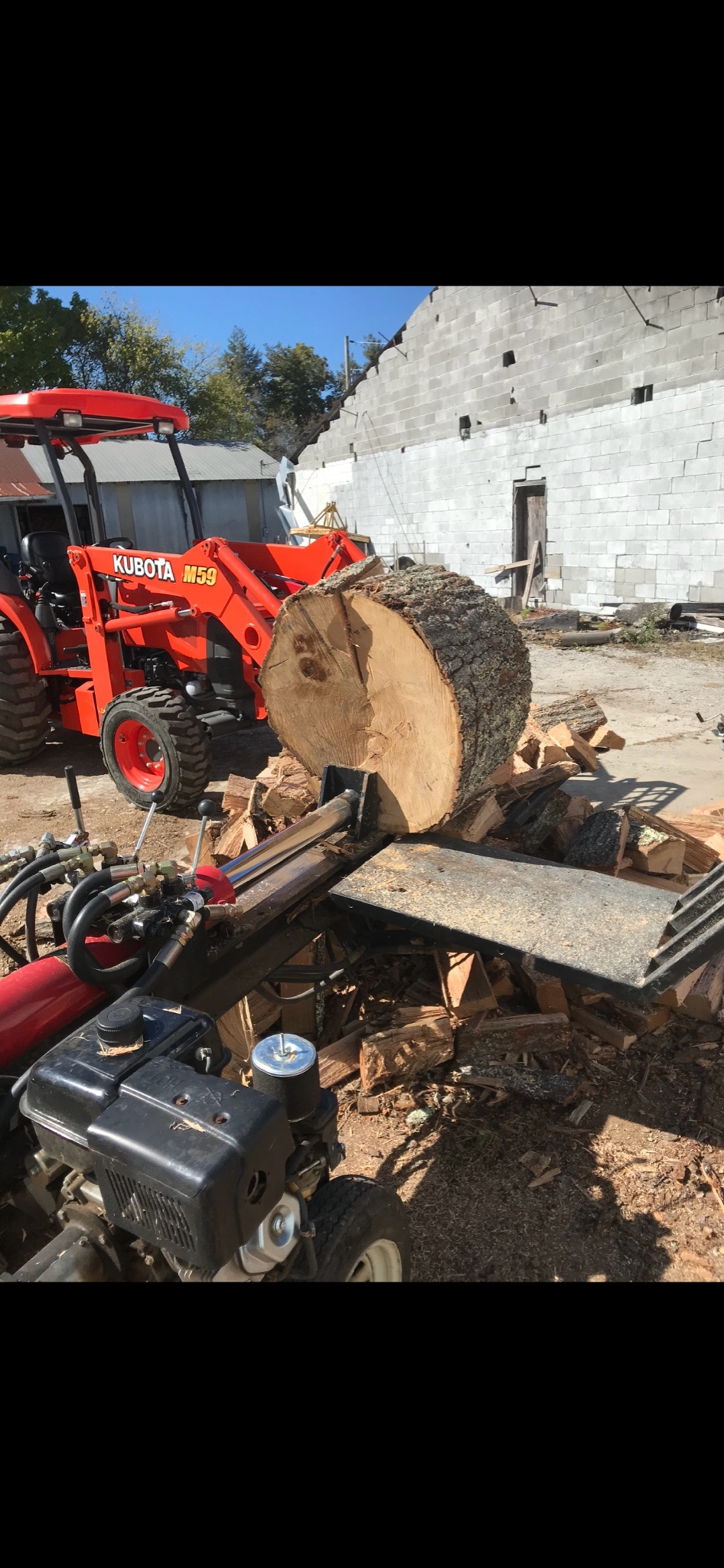

I made a crane with a winch on it to lift the chunks of wood up on the splitter. Too old to wrestle chunks around on the ground to get them into the splitter stand up position anymore.
Got pics?
Our method too on bigger rounds (wife and I). Always interested how others do it though.

Years ago, our PTO pump driven splitter beam laid flat on the ground. We would get tons of free Elm because of Dutch Elm disease and most of it was 36" or bigger. Being that the splitter beam was flat on the ground, the rounds could be rolled on and split. Back then, bending over didn't bother me so much. It did seem easier than using a modern splitter in the vertical position though.

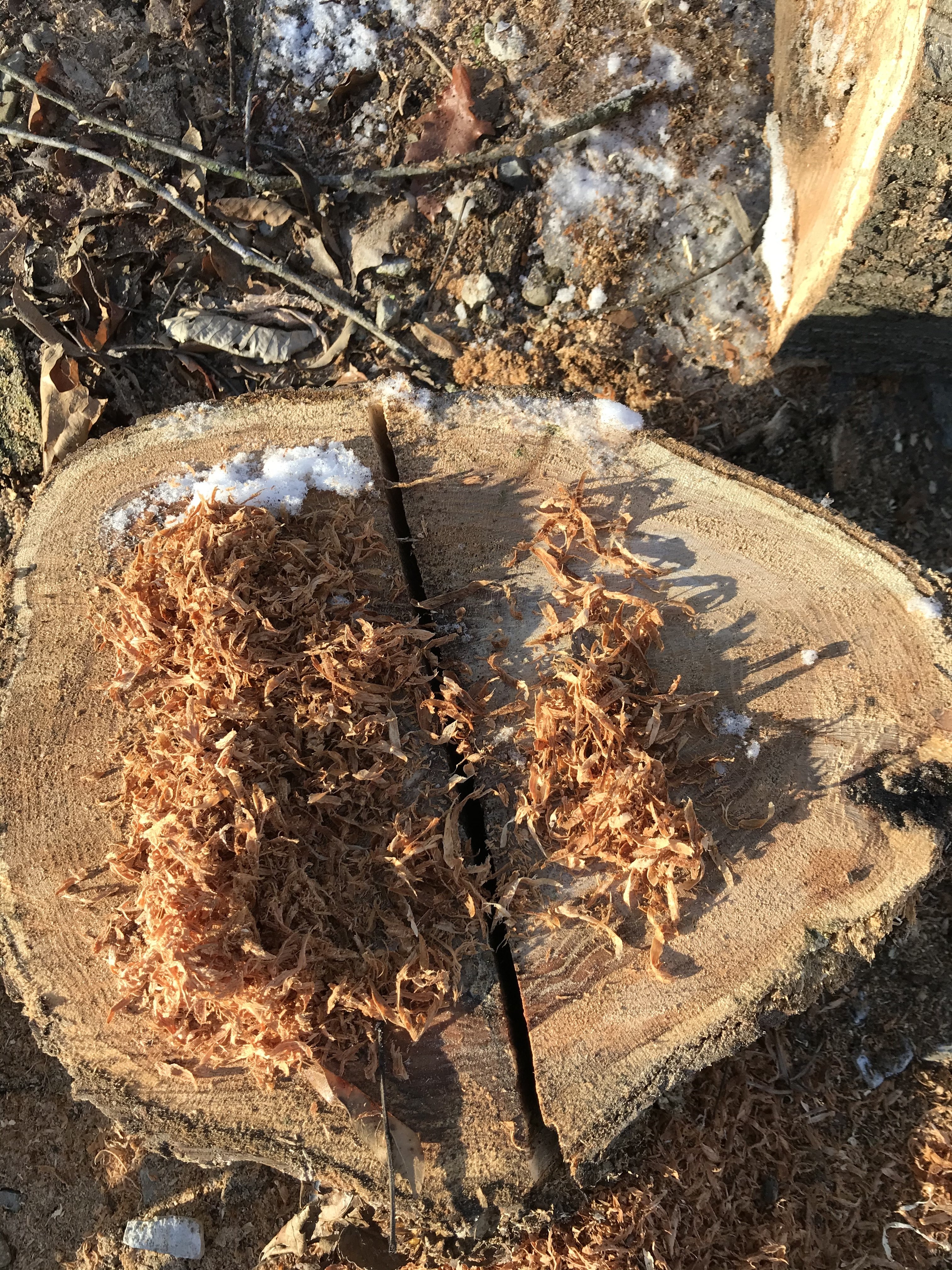

Cutting with the grain. Saw will spit out long streams of linguini-like "noodles". It's an extremely fast way to halve or quarter a round, many times faster than traditional rip cutting.
I like to just make two criss cross cuts with the chain saw across the end of the "cookie" LOL to help hold the splitting wedge in. Split it in quarters.
Yeah, that method works great. But it also works from the side of the round, when you'd rather noodle than cut end grain.
