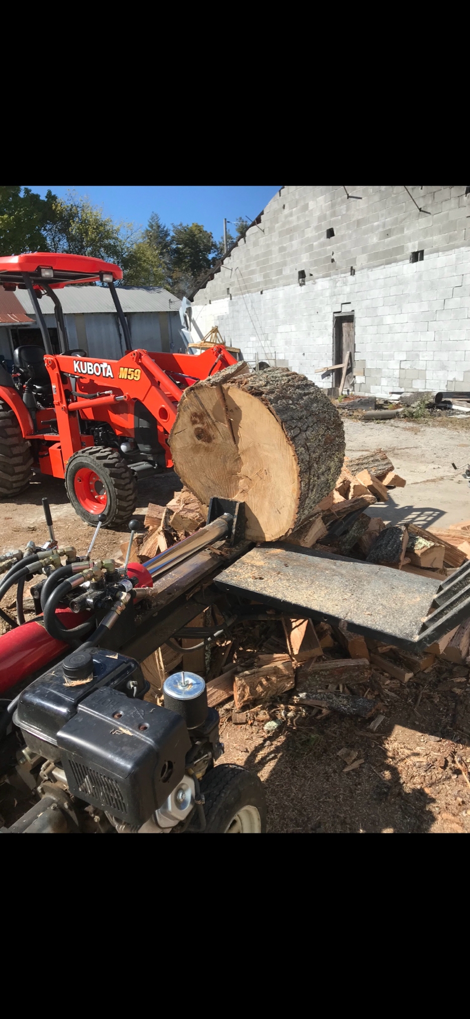

I’ve put pieces that big on my horizontal splitter. One piece stays on the beam. If I’m working with a helper usually they can hold the second piece on the beam and stop it from falling off. If it does fall off then it’s on the opposite side of the lift and I have to use the machine to move them back over to the lift side. If I was working by myself I usually would just noodle a round that size before attempting to split it.View attachment 4184730
A lift on a horizontal would be my favorite coupled with a pass through splitter. I like to stack at the splitter hence the pass through preference.

Ok wait a minute:
Let me get this straight.
You’re picking up a 36” round with the grapple and rolling the splitter under it?
So your splitter is a pass through or moving wedge horizontal?
What happens to the 125lb splits?
One remains on the beam and the other?
It's just a 20ton splitter. I take a slice off the side, and slowly chew it up into more manageable pieces.

I’ve noodled large rounds in the past and also lifted them on my splitter with FEL bucket. Noodling does go fast but probably what worked out the best is I got a splitter that goes vertical and just roll or walk the large rounds into the splitter.
So does the round stay in the grapple while the splitter nibbles?
