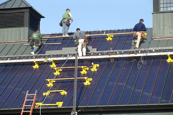

If it were me, I'd take some 2x4's and either nail them horizontally to the roof to act as "safety stairs", or get the metal straps that roofers use to affix to the roof and then put the 2x4's on the metal strapping (sorry I forget the name of the strapping). A lumber yard would have them.
Place them every 3-4' apart, or wherever you're comfortable and go from there.
Are you planning on one metal sheet to cover the entire amount of fall, or will you be over lapping 2 sheets to make a run from the ridge to the eave? (1 piece of metal roofing for the entire fall will be almost impossible for one guy to manipulate, place and screw)
FWIW, once you get the first sheet (row) on, the rest will be easier if you have good rubber soled shoes. (along with safety harness of course). Just my 2¢

They are brackets that you screw down to the roof that are specially formulated to hold a 2x4 or 2x6 as a small platform to stabilize your stance on high pitched roofs. Roofing guys use them all the time.
For an 8-12 pitch, I'd definitely want a few sets.
Depending on your local, you might be able to rent them if you have a good rental store nearby.

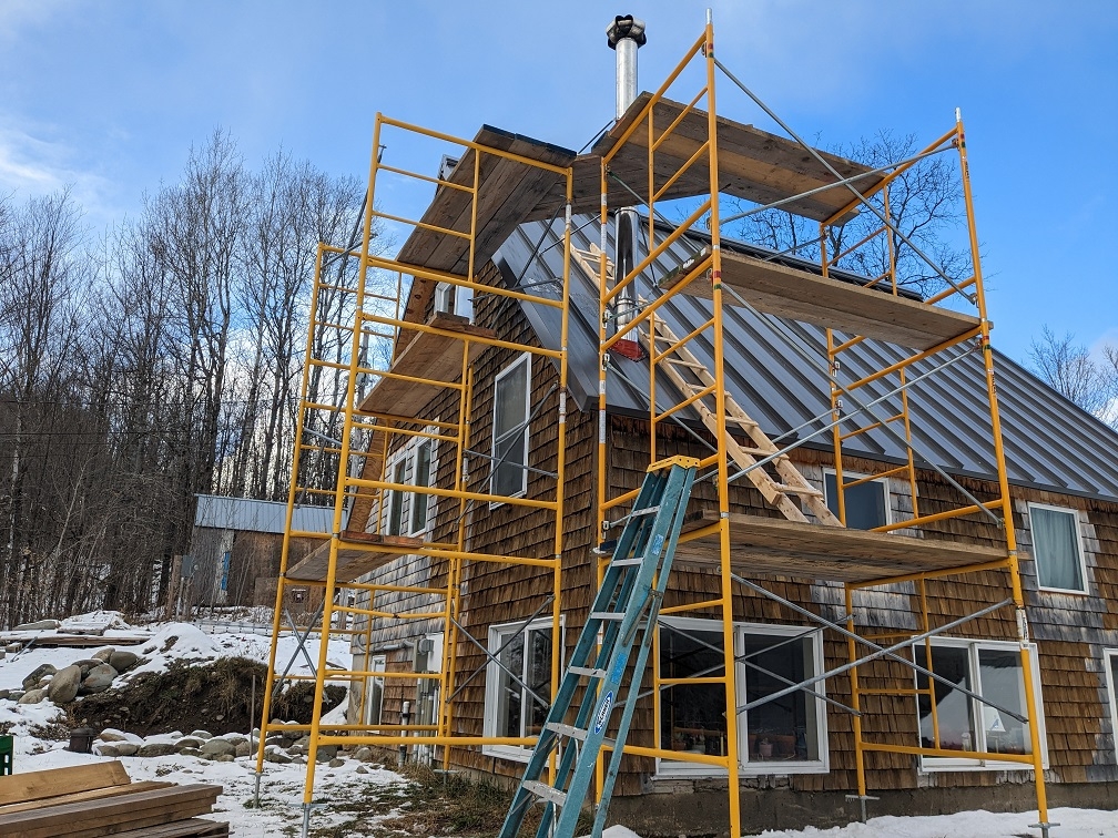

/ Any suggestions #10
newburry you had the same idea as me. I use scaffolding to
paint the ends of the house and use a ladder to get up on it.
I only have this one it sure beats moving a ladder around:
willy
