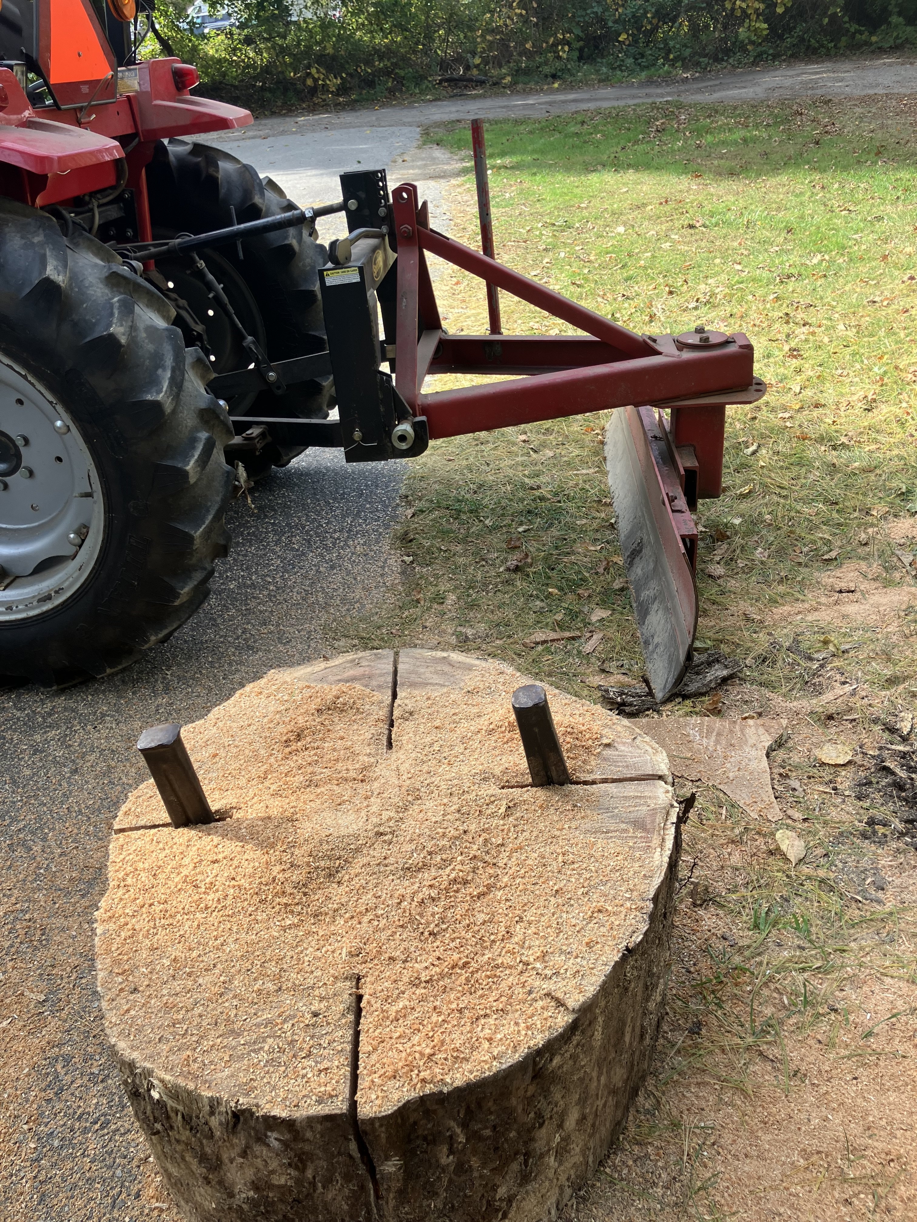

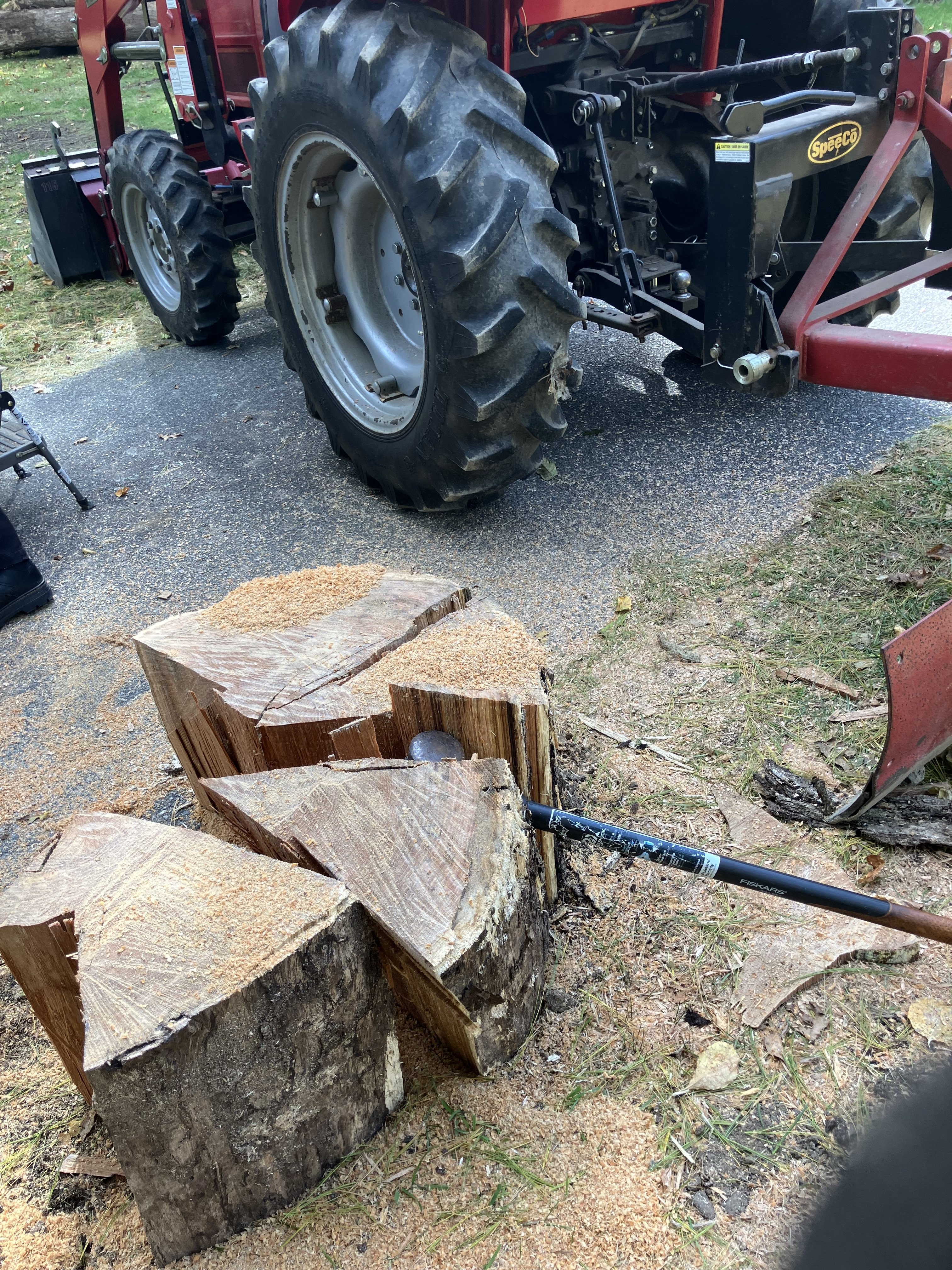

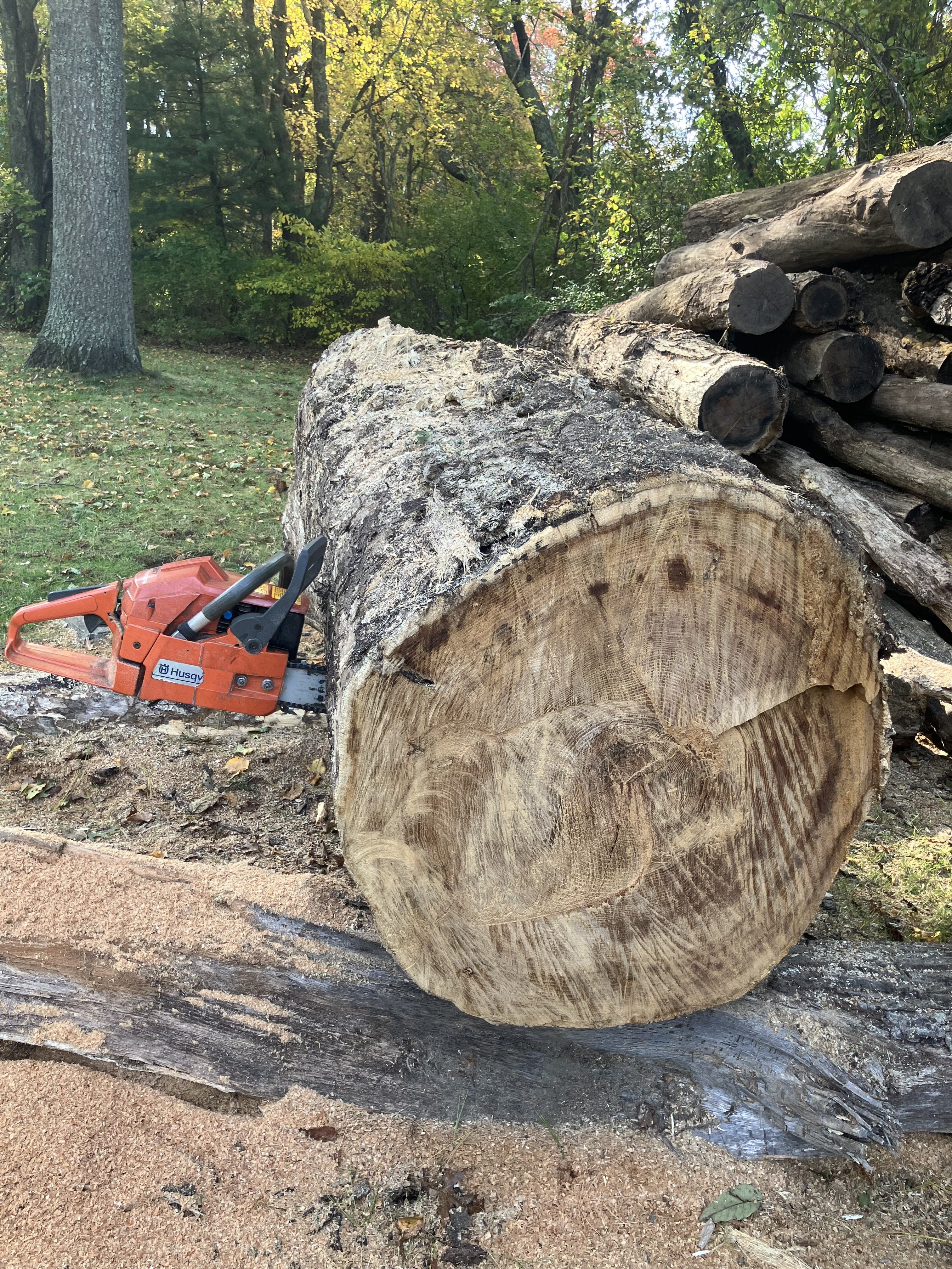

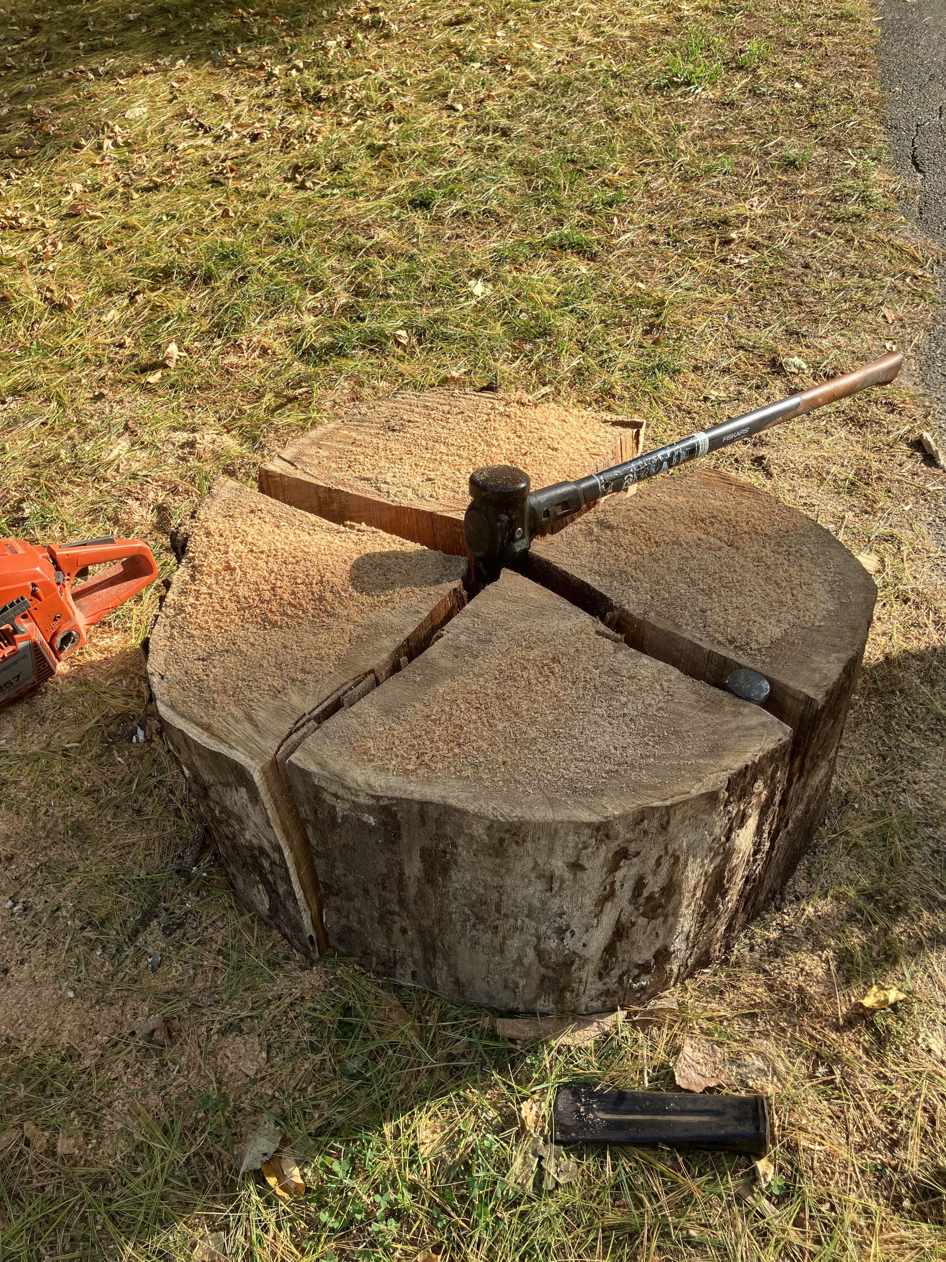

So I timed the difference between noodling and splitting. Now keep in mind. This is with a saw That was just under 60 cc and a 20 inch bar.
When I noodled the 3 foot hunk, it took four minutes or two minutes per cut. I’m sure with a bigger chainsaw, It may have taken half that but what I didn’t like about noodling where the noodles were jamming up into the sprocket area of the saw, which would heat things up.
I then took to splitting the hunks.
That took three minutes to quarter the rounds.
Because of my equipment, my preferred method was the splitting. Saved gas on the chainsaw and the wear and tear on it.
What was nice Was that the quarters split with one whack of the maul most of the time and that saved a ton of time.

It might be fun to try hitting some of those larger rounds with a splitting mall. What I have found is that rather than trying to split across the center, start peeling them like an onion.
I.E. Go for a 4" slab or so off the side. I've done it with oak... that if one isn't careful, the maul will just bounce back.

They were really easy to split as long as the whack was on the edge.
I just needed them small enough to carry to the splitter and let that tool make the smaller wood.
