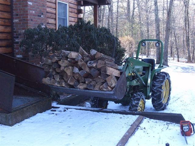

I need to pick up split firewood from the splitter pile and dump the load into a cart and bring it to the wood stack. The bucket on my fel does this pretty miserably bringing in few splits and much dirt. Gotta be a combination that does this much better. Any suggestions?
/ grapple types
#2
Loading the bucket by hand is a PIA.

For what its worth I load my little 2 cord delivery dump truck many times each day with a small Kubota tractor w/ a 60" wide regular bucket. Frankly, I've tried many different ways, scooping & loading with a tractor bucket is only second to using a conveyor...it works VERY good! I'm using an L3400 machine w/ the standard 60" wide bucket, on average I can fill the 2+ cord wood box on my delivery truck w/ about 11-12 scoops. Because time is money in the firewood buisness, and there ain't much margin, I've spent considerable time, effort and energy finding the most efficients ways to handle firewood. That said, if you're having trouble getting a full load into your bucket try coming into the pile at a slight angle...this helps a lot; everytime I come into the pile I come away with my bucket overflowing w/ split firewood on the first try. On average I can fill my 2+ cord wood box in about 13 minutes, from the time I pull up, start the tractor, load, and drive away again is less than 20 minutes. I know of now other way that is as fast and efficient....you won't be this fast w/ a conveyor, even feeding the hopper w/ the tractor. The piles I'm loading from are between 15-70 cord piles, around 12-14' tall.
Making firewood piles w/ a tractor is a joke, doesn't work very well and you'll end up w/ tore up equipment...making the piles works best w/ a conveyor, but when loading a tractor bucket is the only way to go!

I would suggest an effective and cheap way to make your life a bit easier would be to buy a toothbar for your bucket. it will help pick-up many things, including firewood and logs. It will also be a good digger when you need it.
For less then $300 it's a bargain. A bucket grapple, like what I have, will not help pick up firewood.

see attachment for my set-up

Great set-up Northland. If I get a tooth bar, it looks like you have a little play as to how deep in the bucket it goes. May be all I need.
