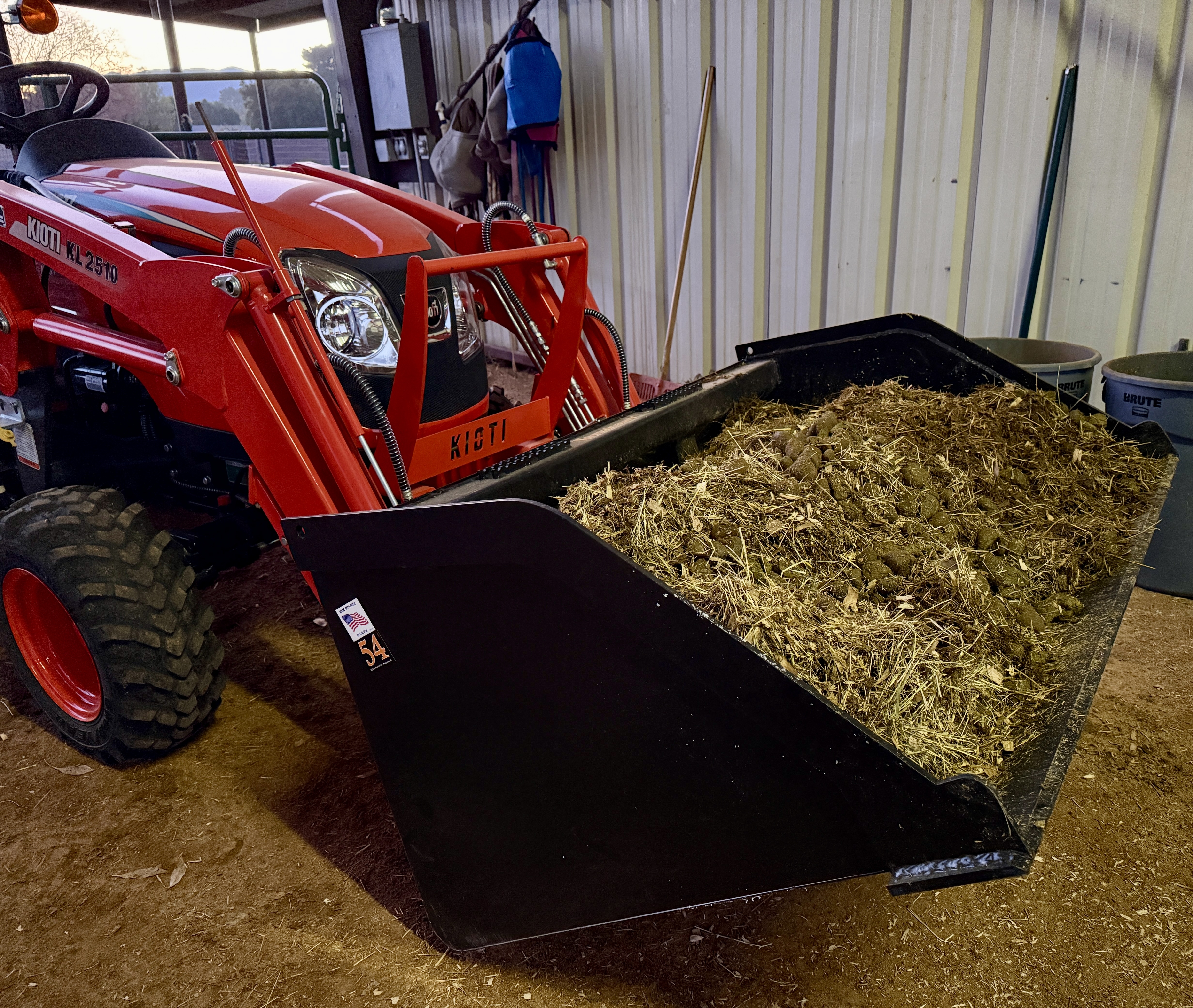

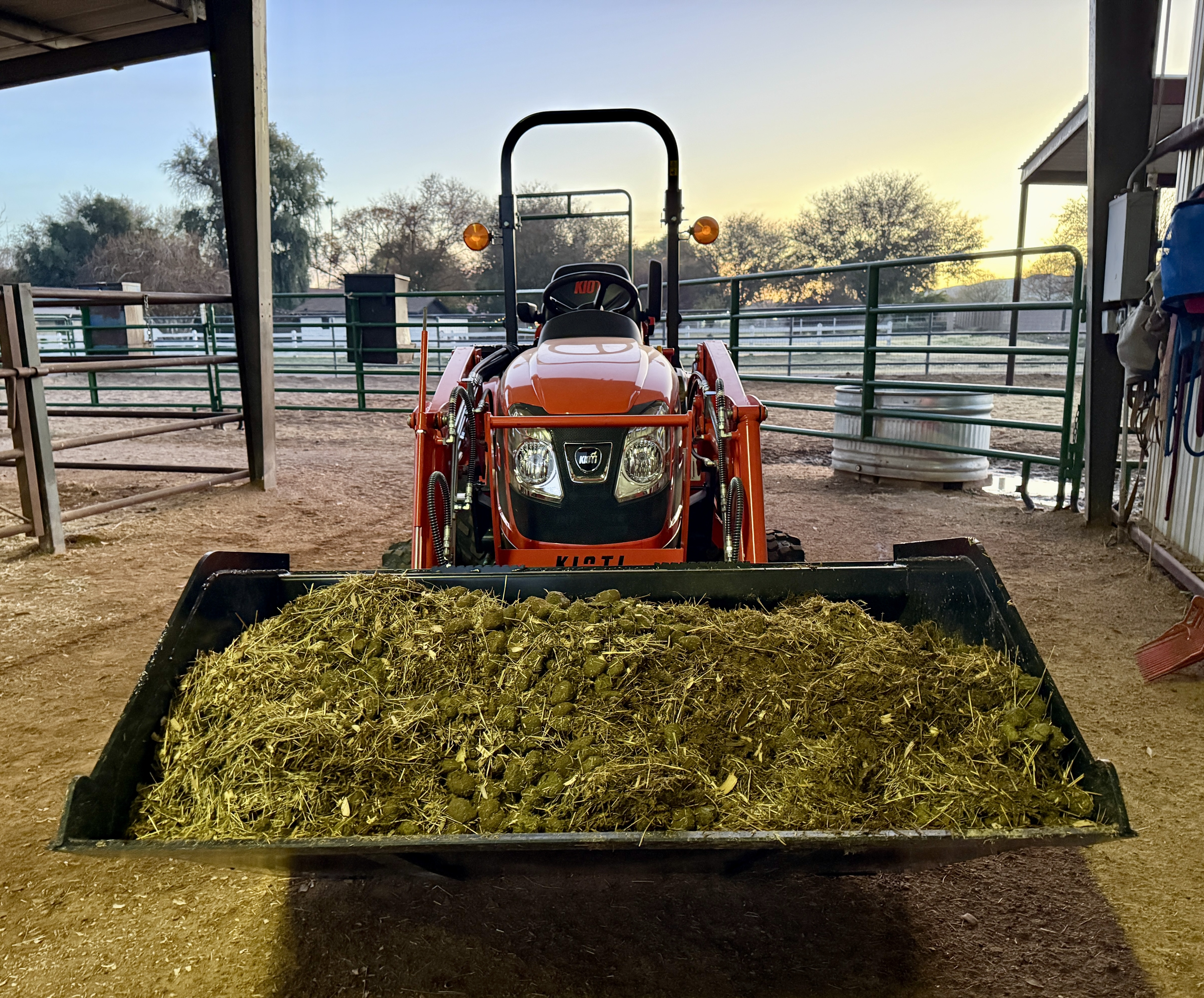

So for a couple months now I’ve been using my oversized bucket, marketed as a “snow” bucket, but from research I think ‘light material’ bucket is the best description.
For use on the farm this bucket is amazing. I haven’t used my OEM bucket since getting the big boy. Granted, I don’t normally do dirt work anyway.
I’ve been using it this big bucket daily for moving manure. I can load it up with a few hay bales and/or feed bags as well. Also, it’s come in real handy for landscaping. I recently lost some trees in a storm and I loaded the big bucket up with branches and other debris.
It has about 3X the volume of the original bucket, yet is no wider and still allows me to maintain the maneuverability of my small CUT while moving a lot more bulky material per trip (as long as that material doesn’t exceed a safe weight limit).
I can’t justify a lot of the really cool attachments, like grapples and such, but this huge bucket is dead simple and works great. I don’t ‘dig’ with it, but I’ve filled it with all sorts of farm stuff and honestly it’s pretty much replaced the bed on my Polaris Ranger in a lot of ways.

I searched a lot of brands and shapes & sizes before zeroing one that offered good volume dimensions without extending past the track width of my tractor. I was also mindful of durability versus weight, etc. I’m not here to advertise a brand, just the new utility I tapped into with the new big bucket.
For a utility tractor the big bucket really has improved it’s overall utility. My little Kioti is a fantastic little unit, but the tiny OEM bucket is really limiting for anything not dirt or gravel.

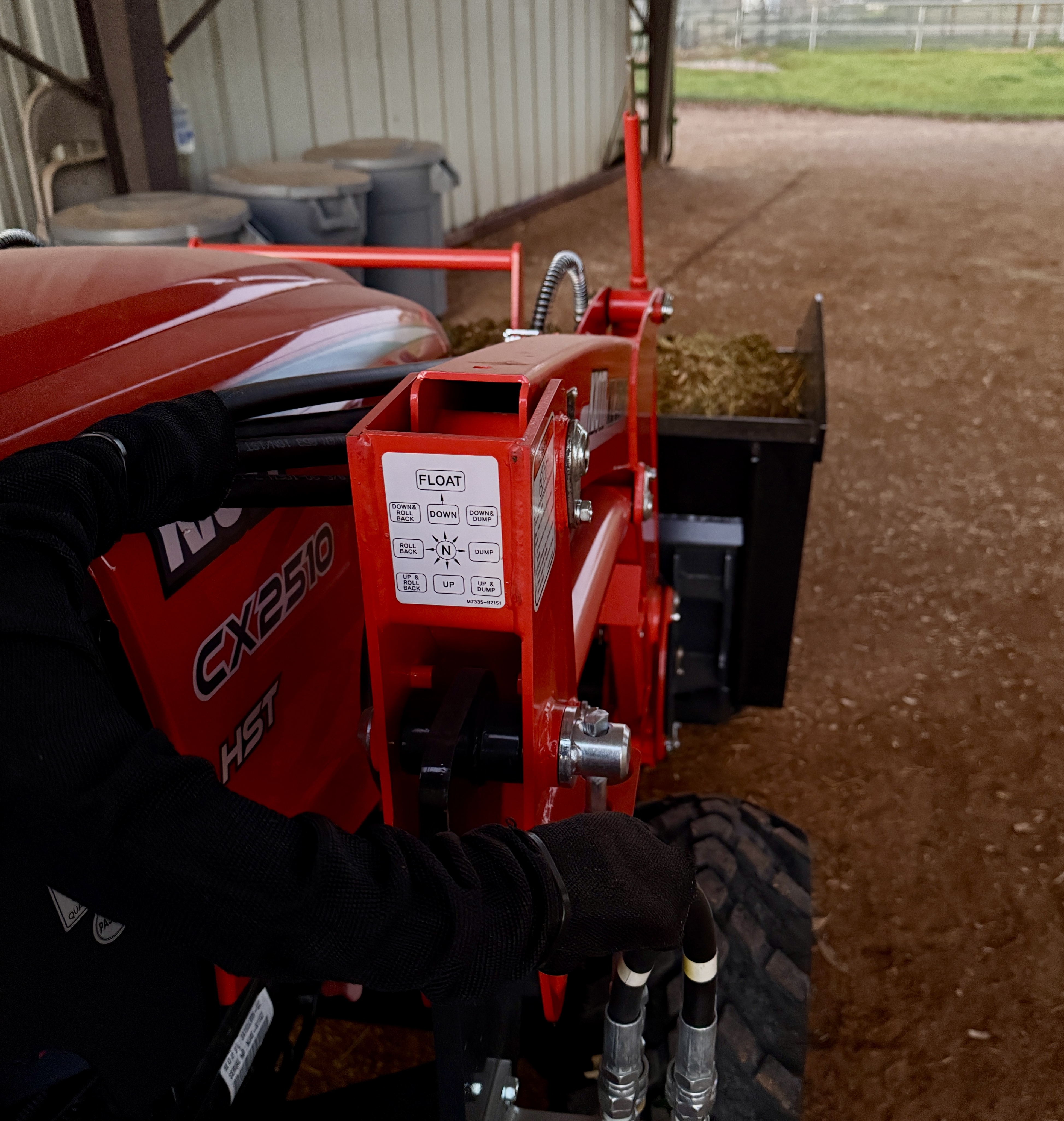

Mine is from Tomahawk. It’s sized for a Toro Dingo, but they were willing to weld SSQA brackets to it. It was a $20-30 up-charge for the custom job, but it was money well spent because it fits my CX2510 perfect at 54” wide.

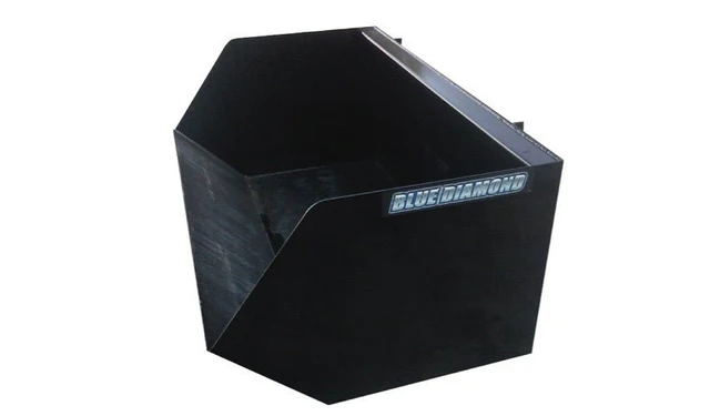

I remember someone posting on here a bucket that was basically a JDQA dumpster, which would be perfect for hauling the 40 - 60 yards of mulch I buy each spring. But I didn't save the link, and now can't find it!
The options from Deere basically amount to a 50% increase for $2k, which I guess isn't terrible, but the one I remember was like a 300% increase for $1600.
I don't need a durable or heavy bucket for carrying bark mulch. Heck, I get more carrying capacity within my loader and tractor weight limits, if the bucket is less heavy!

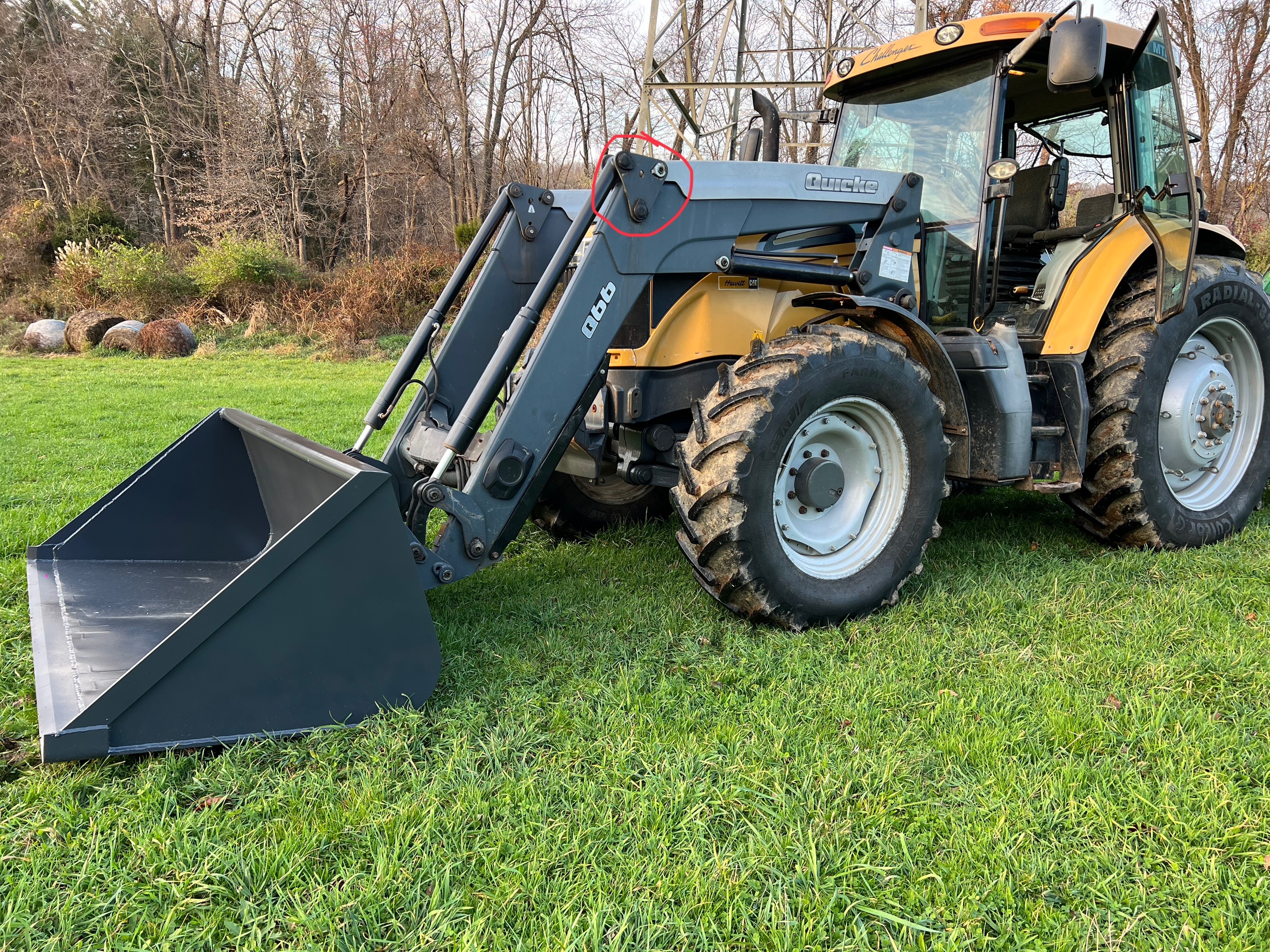

2 The first thing I noticed in the pictures is how narrow your tractor wheels are set. If you can widen them out, and not hurt your ability to mow, disk , chop, you should do so immediately. You could surprise yourself one day how quickly a tractor can be turned over with a loaded, raised bucket
3 Ballat is vital to tractor-loader stability. Get or make a ballast box or add water to rear tires
4 Pay much attention to that front axle. While loading or with a heavy load, tire pressure, condition, and angle away from straight on can instantly make a roll-over situation. (plus 2 above)
5 Some of the tractors shown in the picture are Kioti, and other "lesser" brands ( not knocking your purchase) . They are NOT as stout internally as the Major Brands. My neighbor is now using one the has only front drive on one side. He broke the internal gears from loader work on a 35 hp Kioti
