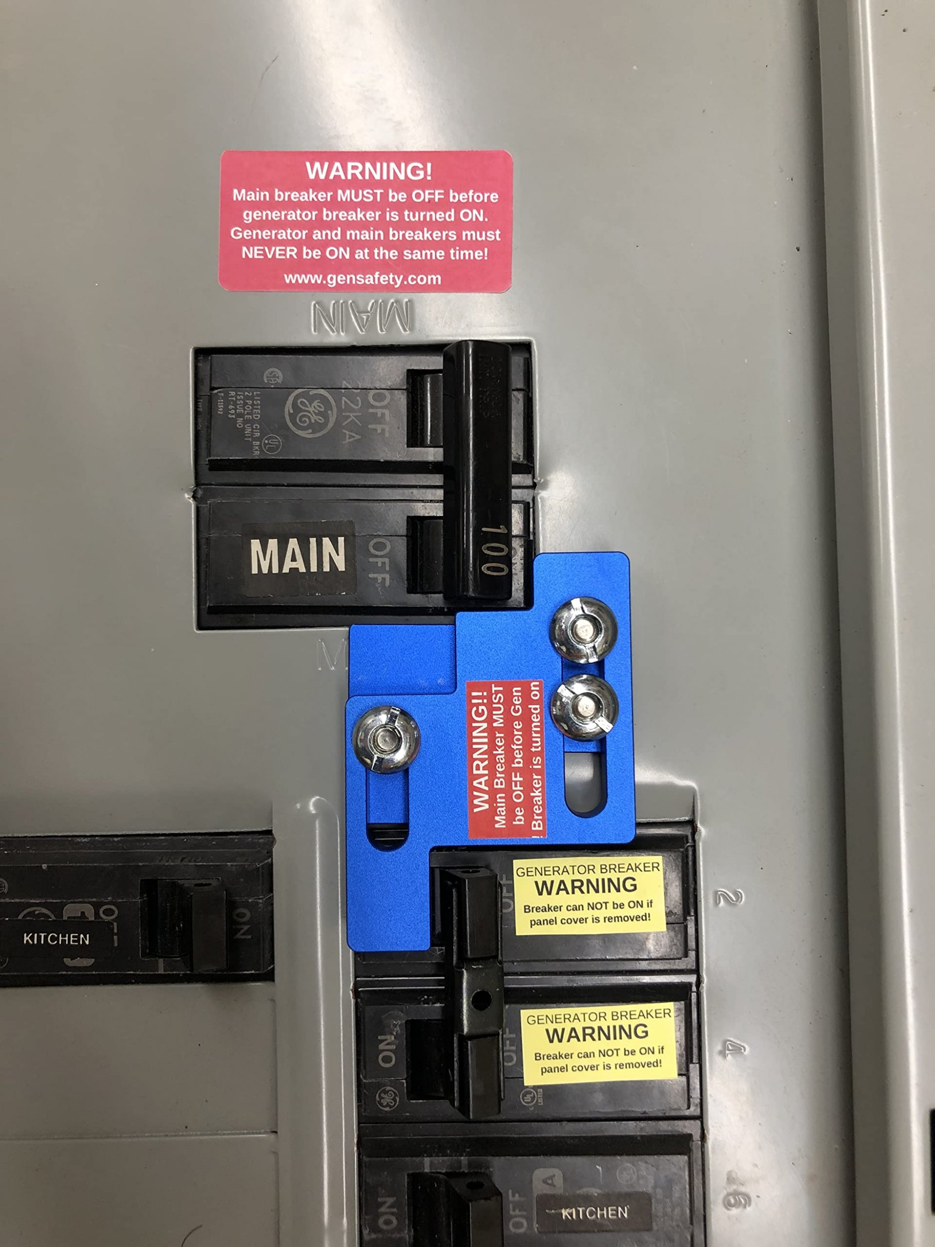

a good interlock for that siemens panel the OP is using, would snap onto and lock into the breakers. but they do make a cheap butterfly interlock that is held inplace with the panel cover. but that kind tends to fall out or get misalligned.

I'm with you on it being a simple, logical, step-by-step process, that, if followed correctly, yields the desired result without injury. I've done it myself. However, it's not something I'd encourage anyone else to do.
Especially with the very simple and effective (and legal) options out there today, like what I've pictured below.
My mother in-law has a similar setup in her house. She used it for the first time in about 10 years a few weeks ago. It's brilliant! Simple elegance. Her neighbor constructed it for her out of scrap plastic.
You can't energize the generator power without turning off the street power first. Likewise, you can't energize the street power without disconnecting the generator power first. I think it cost less than $10 for him to make it.
Anyhow, that's the way we're going at our place. Simple. Cheap. Effective. Legal. Peace of mind. ;)

It is a NEC requirement to have a interlock to prevent a back feed of the utility system from a generator unless it is ul listed for such use.
I will provide you with the code reference when I'm back in my office. Not my intention to be the hall monitor but you are encouraging people to do something that is unsafe and a code violation.

Moss posted a great idea of a simple secure lockout mechanism so main breaker cannot be turned on unless generator breaker is turned off.
