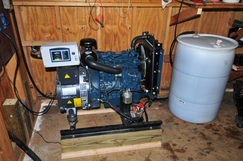

24 KW is a big gen set. I have a 10 KW and can run my two geo heat pumps and everything in the house, except for the stove and hot water heater. On an outage I charge the HW heater once a day, shutting of the heat pumps. It is an 80 gal HW heater, so it easily lasts the family for a day. For cooking we can run one burner, but more often use the convection/microwave to the cooking. On average we burn about 0.3 gal/hr.
Bigger means more convenience, but higher costs to buy and higher fuel consumption. You may look at:
Kubota 12 kW Diesel Generator
or
Kubota 15 kW Diesel Generator
units. They also have a 21 and 25 KW units.

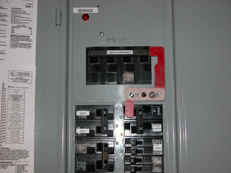

I put my genset in my shed (12' x 20') and ran the feed underground. I purchased it with a 2 wire start control, but have manual transfer. Look at: Generator InterLock Kit - Introduction as a low cost, code compatible transfer, since you already have the feed breaker installed. I also have a 50 gal barrel of diesel fior the genset, as well as a second 50 gal barrel in the shed for the tractor that I can use as well, if needed. With the start control, there are all of the engine protections and I can start the genset from the house when needed.
Paul
Paul
Paul, your strategy is about what I was figuring we would do -- I just need to work out the start/run load for our geothermal system to see if it's even in the cards. Otherwise a 14kW unit will be more than enough.
So how far is your shed from the main home, and what wiring gauge did you run? Did you add an exhaust pipe running out of the shed, or just leave a door open?
The interlock we have is very similar to what you show, but it's a GE part made for the GE panel. As shown, it prevents you from engaging the generator feed breaker when the main (grid) breaker is on, and vice versa. Nice and simple.
I had been planning on a Kubota generator (since I have a Kubota tractor and trust them) but that same company now sells Isuzu units that have notably better fuel economy, so I am thinking Isuzu now....
/ Generator install, sizing, location
One other question Paul -- I see you have a service light to show when the grid is energized, which I also want to do. Can you give details on the type of lamp and how you wired it in? I assume it has to be fused? Thanks.
all automatic transfer switches have a fused 20 amp (actually 2 of them) circuits that tell the transfer switch when utility power has been restored. youll need the wiring diagram from your unit. This applies to auto units only.
Pauls system is a manual transfer switch, so im really not sure how he did his unless its hooked to the mains, and i that test light would have to be rated at 200 amps, which it isnt.(but im sure it works fine...)
Personally my system uses the eyes.... i see the neighbors house light up, i turn my unit off haha
Actually, i have a utility room thats not hooked into my gen panel, so i turn that light switch on. When the light goes on, i know utility power has been restored.

The shed is at an angle to the house. It is about 25' to the corner of the attached garage and about 40' to the house. Overall the conduit run is about 50'. I ran 6 ga wire from the shed for the generator. If you look closely at the picture of the genset you can see the exhaust running out and through the wall (it is the shiny pipe behind the control panel). With this setup I can run the generator with the door closed, but in warmer weather I open the door. Winter I just leave it closed.
The service light was added to the panel. It is a neon light, one side grounded to the panel. The other leg has an additional 10k resistor (to act as a fusible element just in case). I have a porcelain standoff insulator, about 2" long, with a spring (from a ball point pen) attached to the end with a screw, and connected to the other leg of the lamp. The length is such that the spring contacts the main lug on the breaker. Simple system to make contact and safe, as there is a lot of clear area around the lug.
I have since upgraded the system. I built a small circuit (yes I am an engineer) that uses a wrap of insulated around the incoming power cable. The circuit picks up the electrostatic field from the AC voltage and triggers a relay. There is also some logic in the circuit. If power loss is detected, it drives another relay (HVAC heat contactor) that automatically will disconnect the hot water heater. There is a switch on the control to bypass and turn on the hot water heater if needed to reheat the water. If the utility power comes back on, the logic will sound a small alarm beeper if the generator is providing power. This is an annunciator for me (or the wife) that the power is back and the utility can be switched on, and the genset shut off. It only beeps if utility power and generator power are present.
Paul
I believe that the fuel consumption between Isuzu and Kubota are nearly the same. I chose a Kubota for the same reason that my tractor is a kubota and filters, etc will be common between the two.
Paul

T
Paul
That is really cool. Any pics or another thread showing that?
