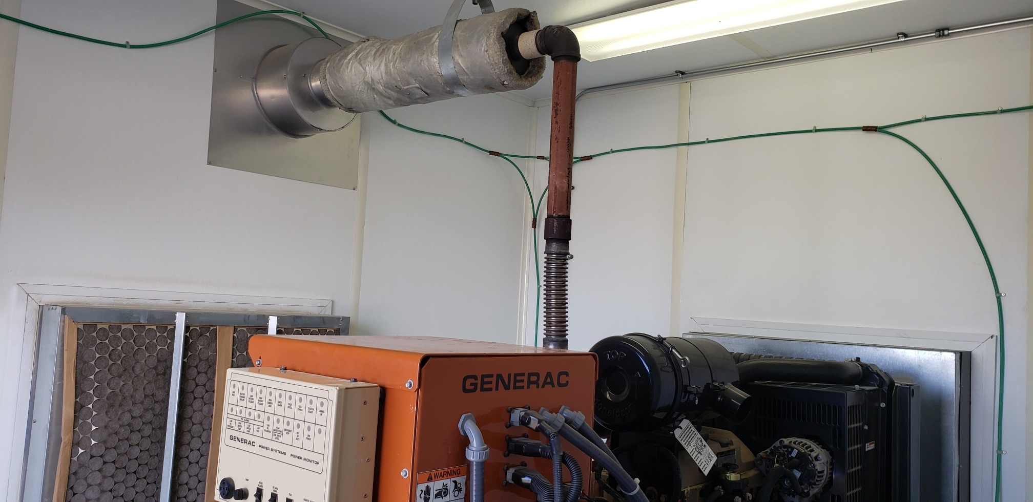

Not really. A new 21KW unit is way north of what I paid for the new enclosure. Least around here it is.
I know exactly what my fuel usage is for both of them. I do have the manuals for both and they state fuel usage plainly. Not that I would ever expect either to run continuous for weeks on it.

So you decided to keep an old generator and just get a new enclosure, for about the same price as a new generator with a similar enclosure?
