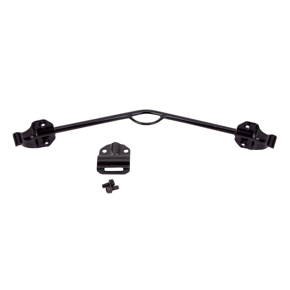

I also have the Honda EU7000is but I have city water, no well.
This genny is heavy, and rolling around is a chore. If anyone needs to move it off the concrete I recommend getting the optional lifting kit.
