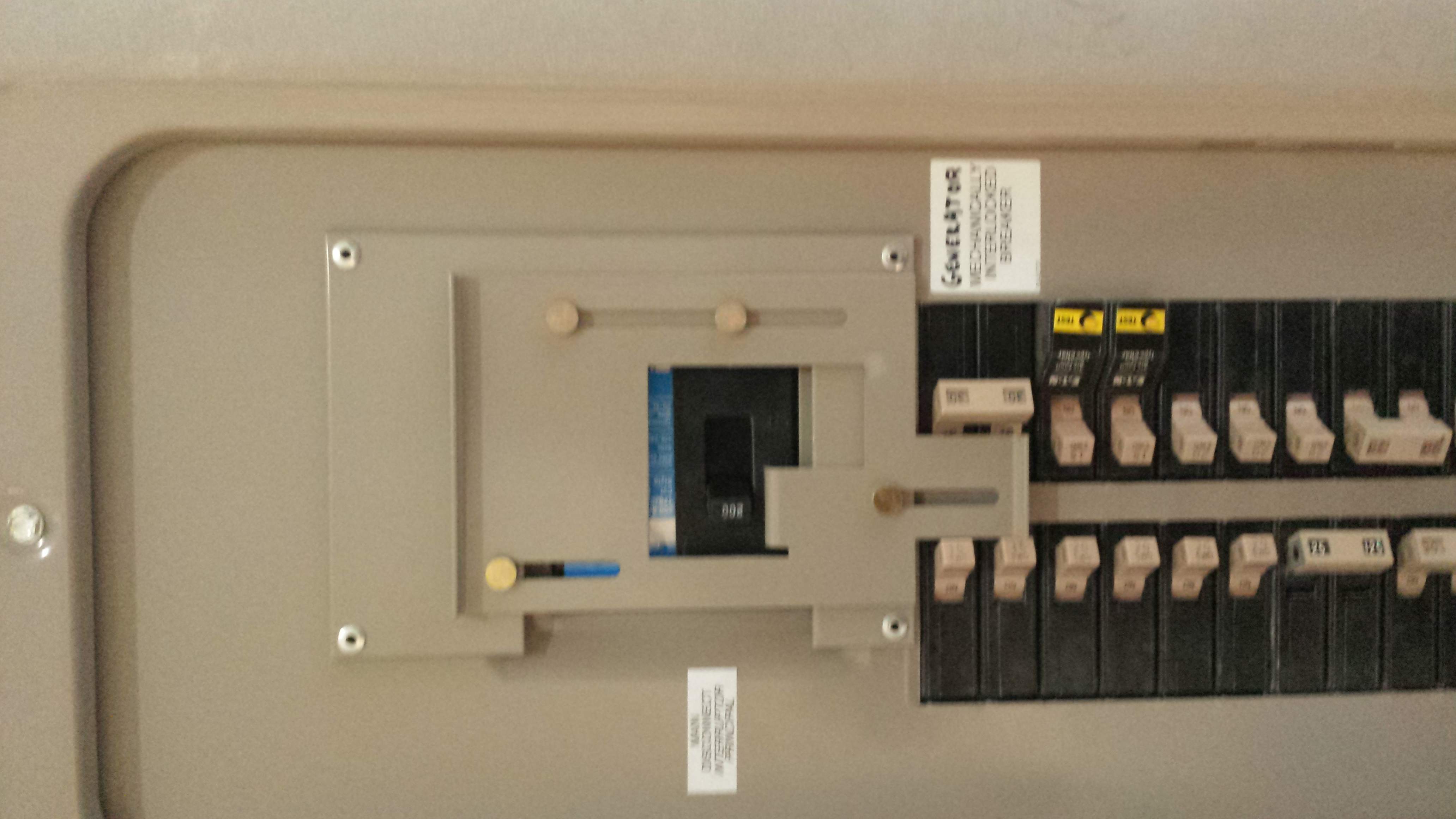

A transfer panel is overcomplicating things greatly. A two pole breaker with a $50.00 interlock kit in the main panel is all that is required for the occasional use of a small generator in a power outage situation. Its safe. It meets code. Its idiot resistant.
   / Generator in a outside building and powering the panel... #74
Agreed.Eazy peazy.
I got mine from a local distributer for the same company you linked to earlier.

So it looks like we have a winner: The original plan with one of these interlock plates installed:cool2:
