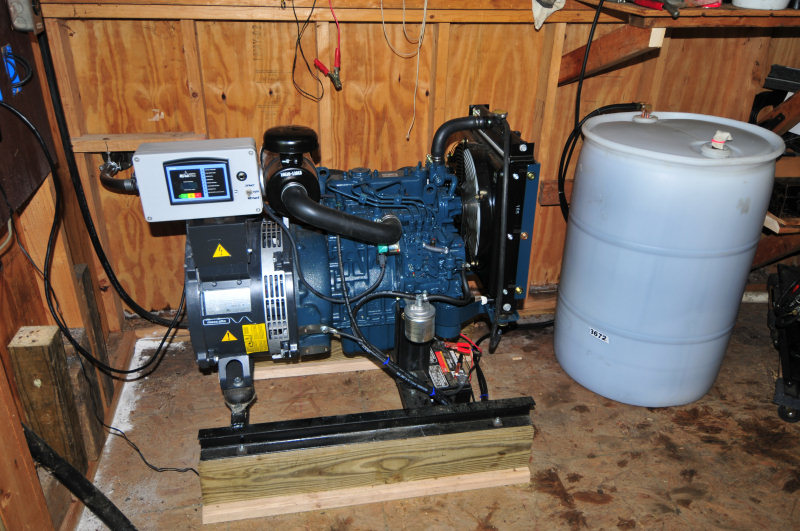

I keep mine in my shed. Exhaust ported to the outside. Window in the rear, or front door can be opened for long runs if needed.
Paul
Paul
Now that's a Binford generator. :thumbsup:
I can't justify that, but if I could.... :D
