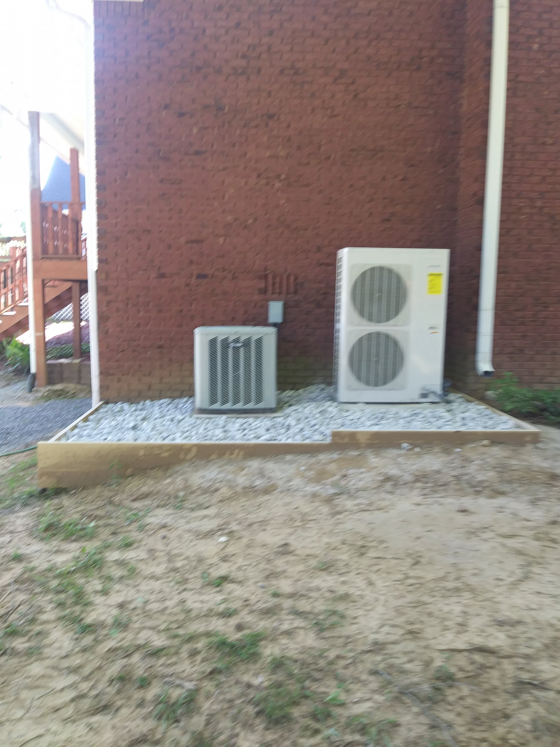

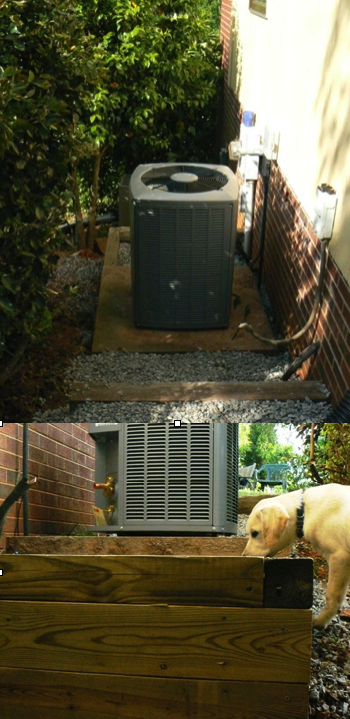

Do pay attention to the way Kenmac has those outdoor units placed outside his home, that is the CORRECT way to sit your unit/units on the side of your home, with lumber and gravel, IMO, even if the house didn't have any grade to deal with.
When I replaced my one outdoor unit below.
I hate dealing with cement pads just due to the weight, but the existing pad was concrete and reused it (harder and harder to find anymore anyways) but I did "box and stone" it. Between lumber and stone and time, it can add onto a job price, but a good contractor should always give the homeowner the choice between the right way of doing it or the cheap way of doing it (putting bricks, rock or dirt trying to level the pad on grade) or let the homeowner do it themselves to reduce the job cost.
If anything, even if your house sits flat on the land without any grade to deal with, and you don't have any shrubs around the house, a raised "box and stone" set up will help any possible incidents of nailing your outdoor unit with a riding lawnmower, and it's "natural snow legs" to raise the unit higher for snow (bigger issue up north).
It plane and simply looks better as well IMO.
