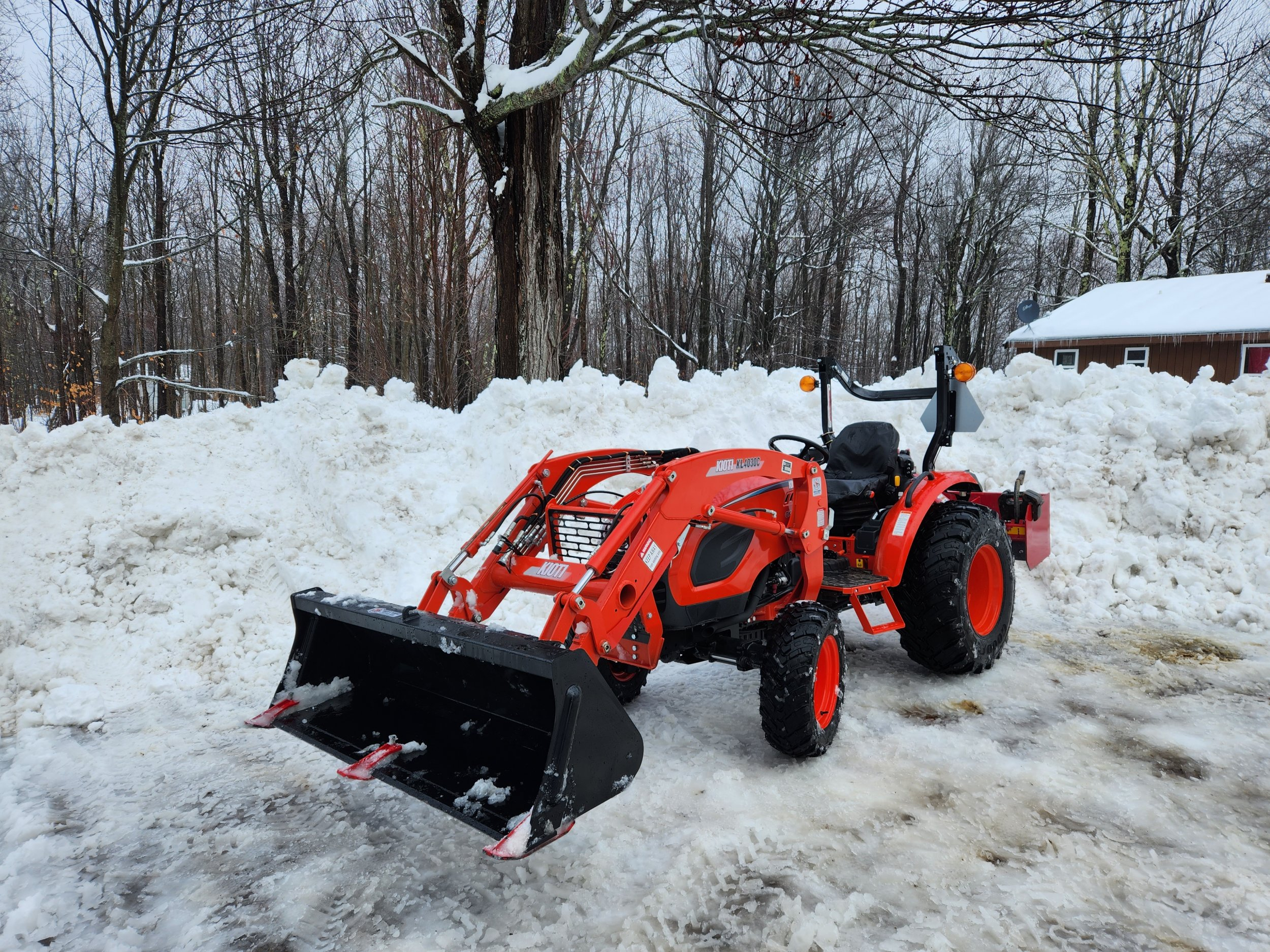

This gives you a good scale of a 2515H . It’s not huge and not small either . It turns on a dime and works well in the woods . I did load the tires and have not had much trouble picking anything up.
It would be interesting if we could figure out a way to do a practical comparison of your 2515H and my L2501 from the viewpoint of actually owning and using them.
Comparison chart posted by a dealer: https://www.kenotractors.com/wp-content/uploads/2020/03/2515R-2515H-Comparison-Chart.pdf According to the chart, the 2515 has a loader lift capacity of 2,200 lbs vs 1131 for the L2501. That is a substantial difference.
Also looks like the 2515 has a suspension seat and a fuel tank located at the foot rest area so no lifting 5 gallon cans up to the hood like my L2501.
