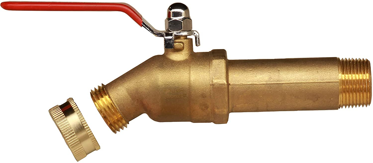

Just a couple comments from experience. I service my electric heater at least once per year to remove sediment and check the anode rod. Did my one year old Rheem about a month ago and found so much sediment in the tank I'll now do the service every six months.
A beneficial option is changing the crappy compression drain valve from the factory with a 3/4 ball valve specifically designed for draining .... about 25 dollars that saves a lot of aggravation.
I'm on a well with a new pump so I also flush the crap out of the pressure tank first. (Our one year old tank had a lot of "mud" and crap in it)
Then ... drain the heater and remove the elements ( I always replace them as a preventative measure cause they're cheap ). I use a wet vac with a length of heater hose to vacuum out the sediment through the bottom element hole..... Also check the condition of the anode through the same bottom element hole. Haven't replaced mine yet but have two anode rods available for when mine shows deterioration. ( I regret not removing the anode once before installation to make sure the factory seal can be loosened. )
We live in a mobile home so the project involves moving furniture and a wall panel to get at the system ....... but after 30 plus years we now have it down to about two hours.

Something to ponder about the "quick flush". Opening a compression type valve does not remove much of any sediment .... at least that's been my experience over the years. I've drained the tank numerous times and when the lower element is removed I find a significant amount of crap.
Even with the dedicated 3/4" ball valve the crap still remains within the tank. This last time it was almost to the level of the bottom rod.
My perception is that it's a "feel good" measure that does not accomplish much of anything. I suspect the type of water you have is critical ....... ours is "hard" well water.
I'm personally glad we do not have a gas unit because the sediment build up & longevity of the tank is predetermined by water quality.
