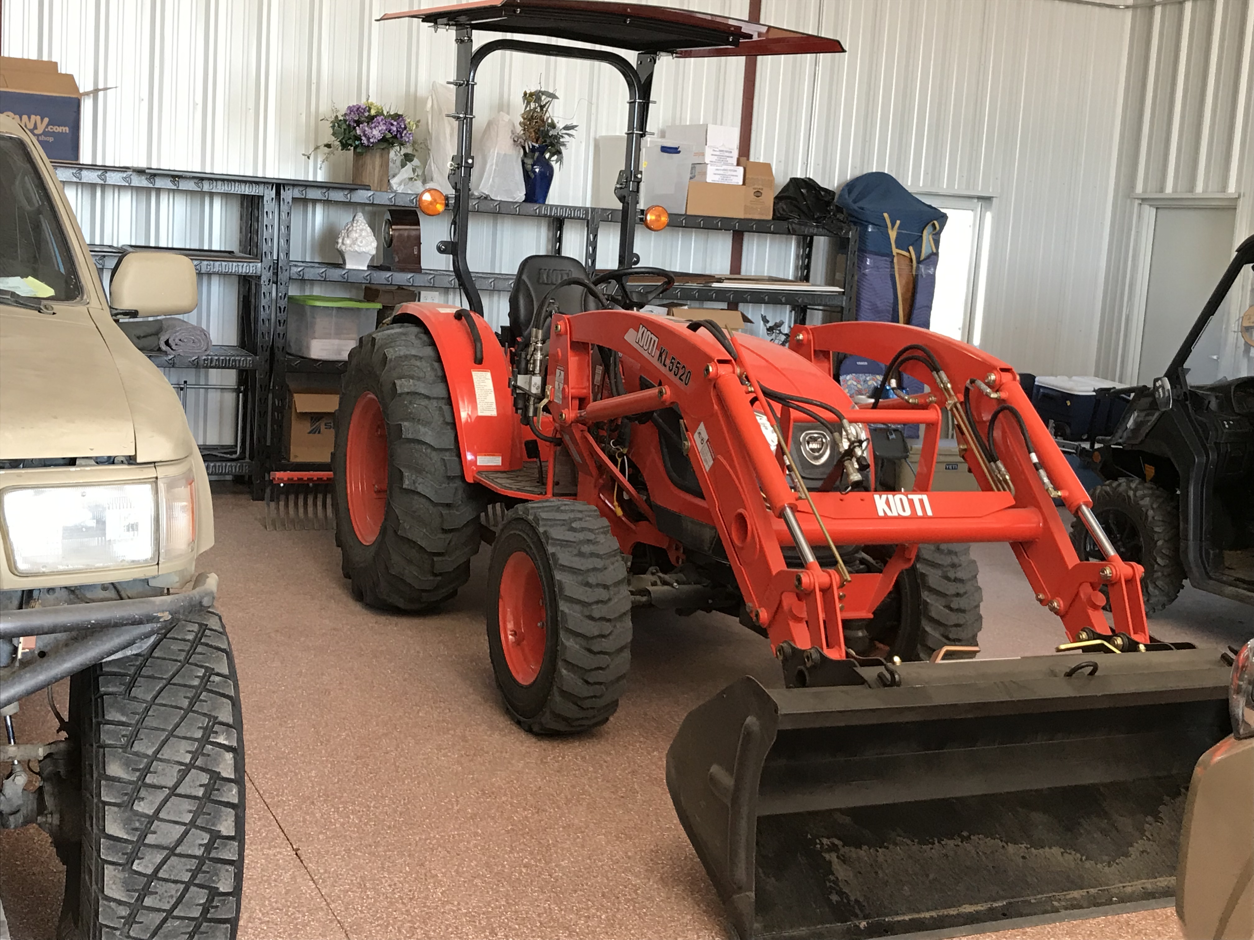

This is the new machine safely in its out building.

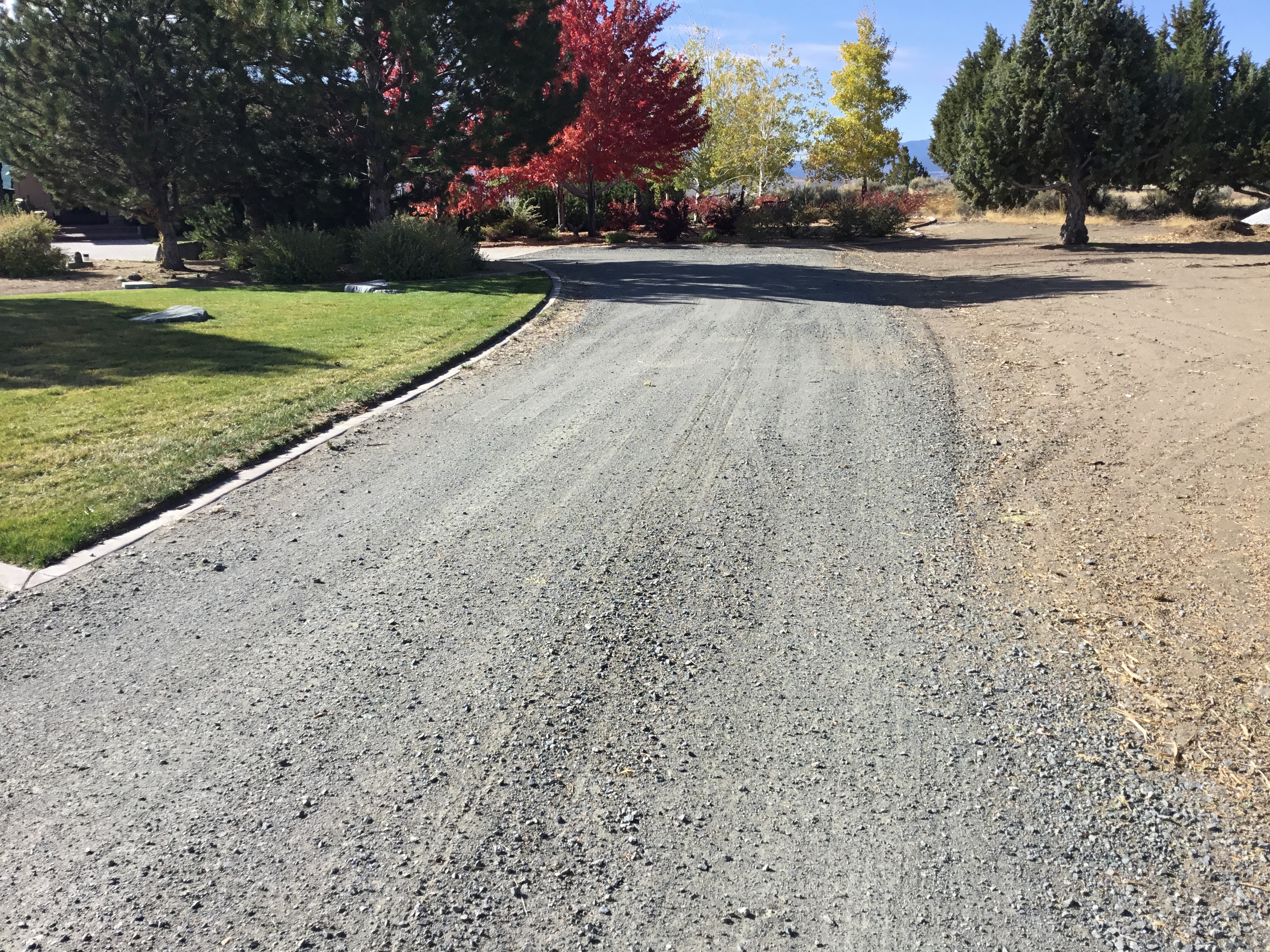

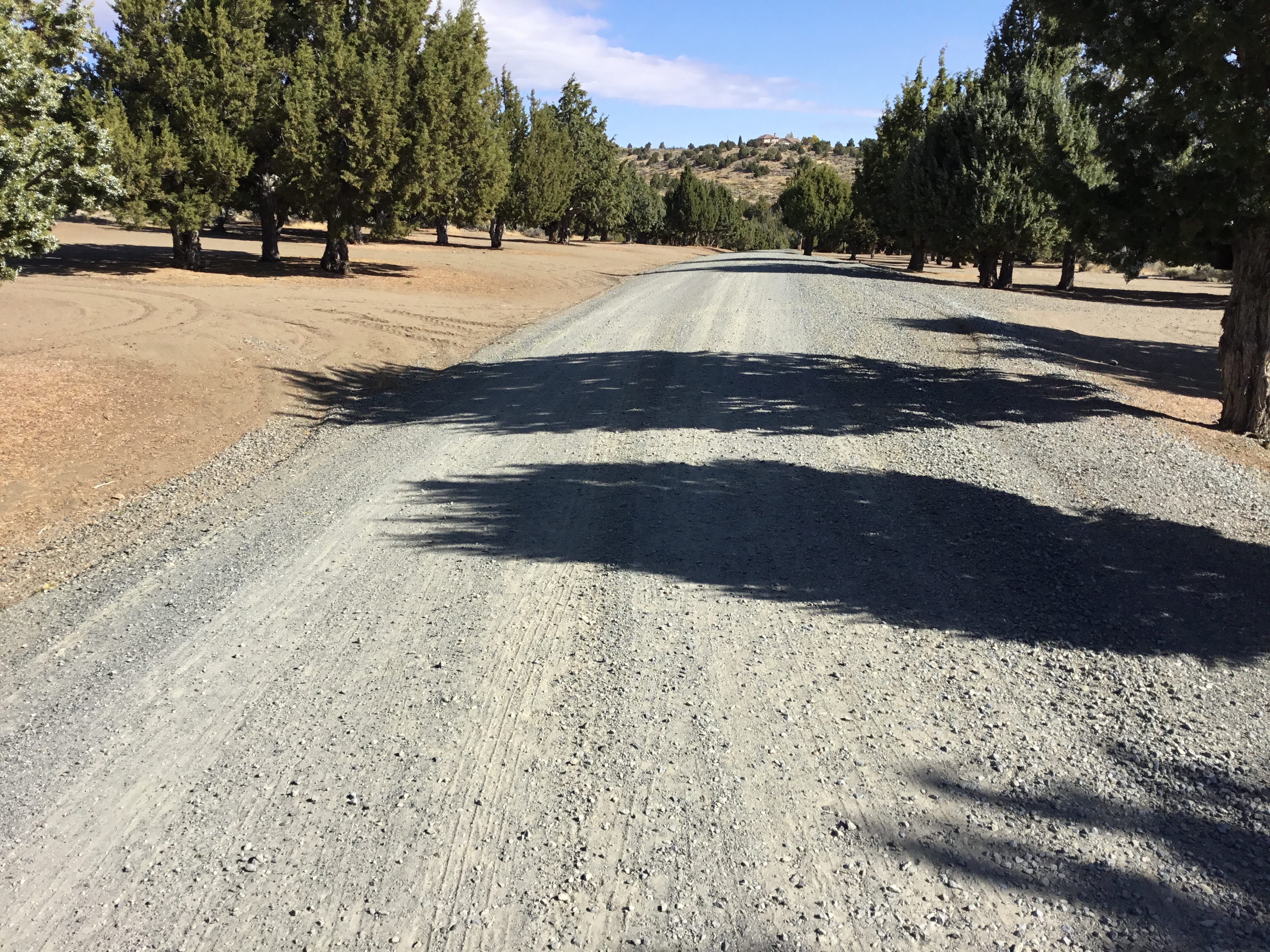

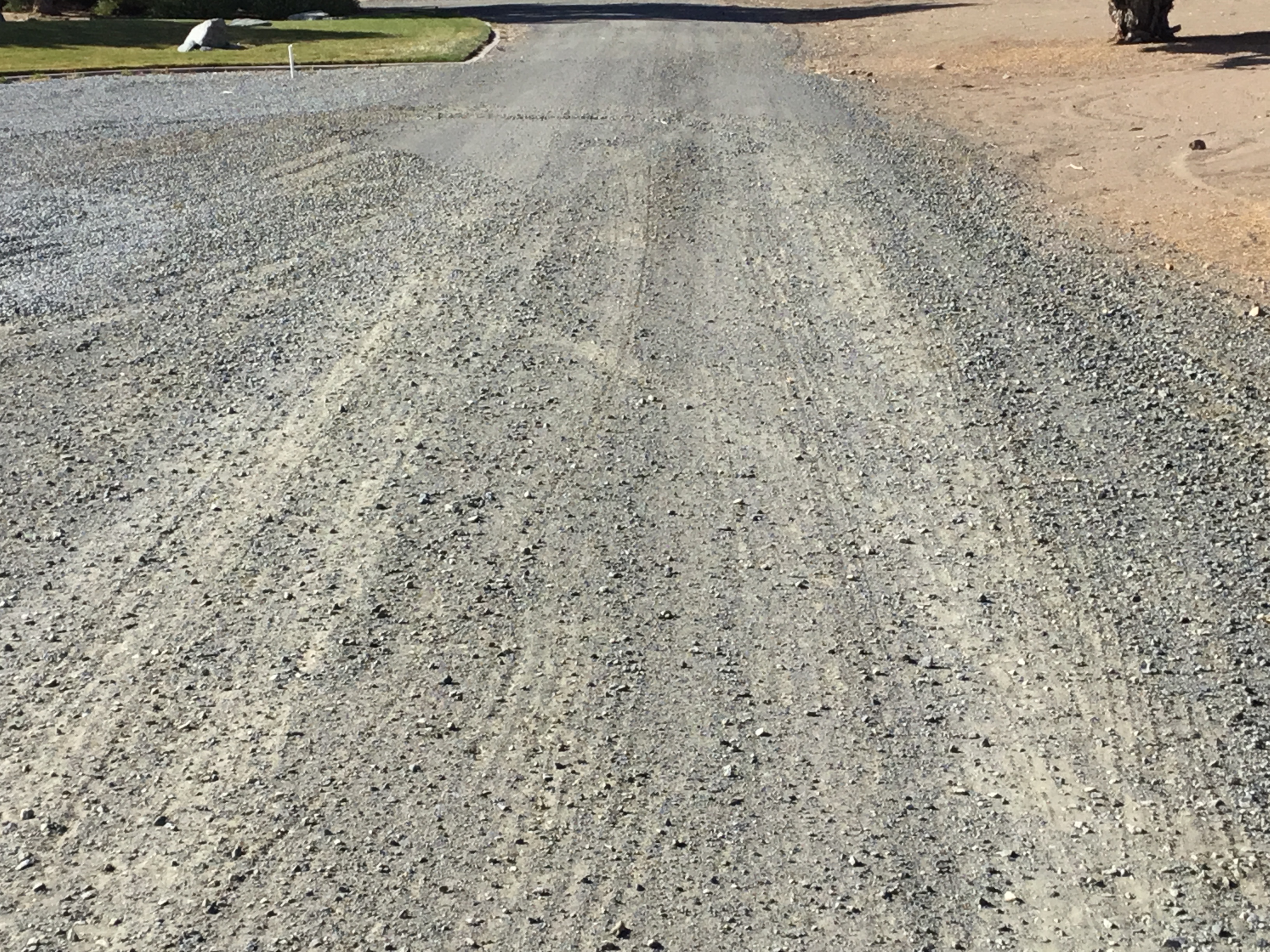

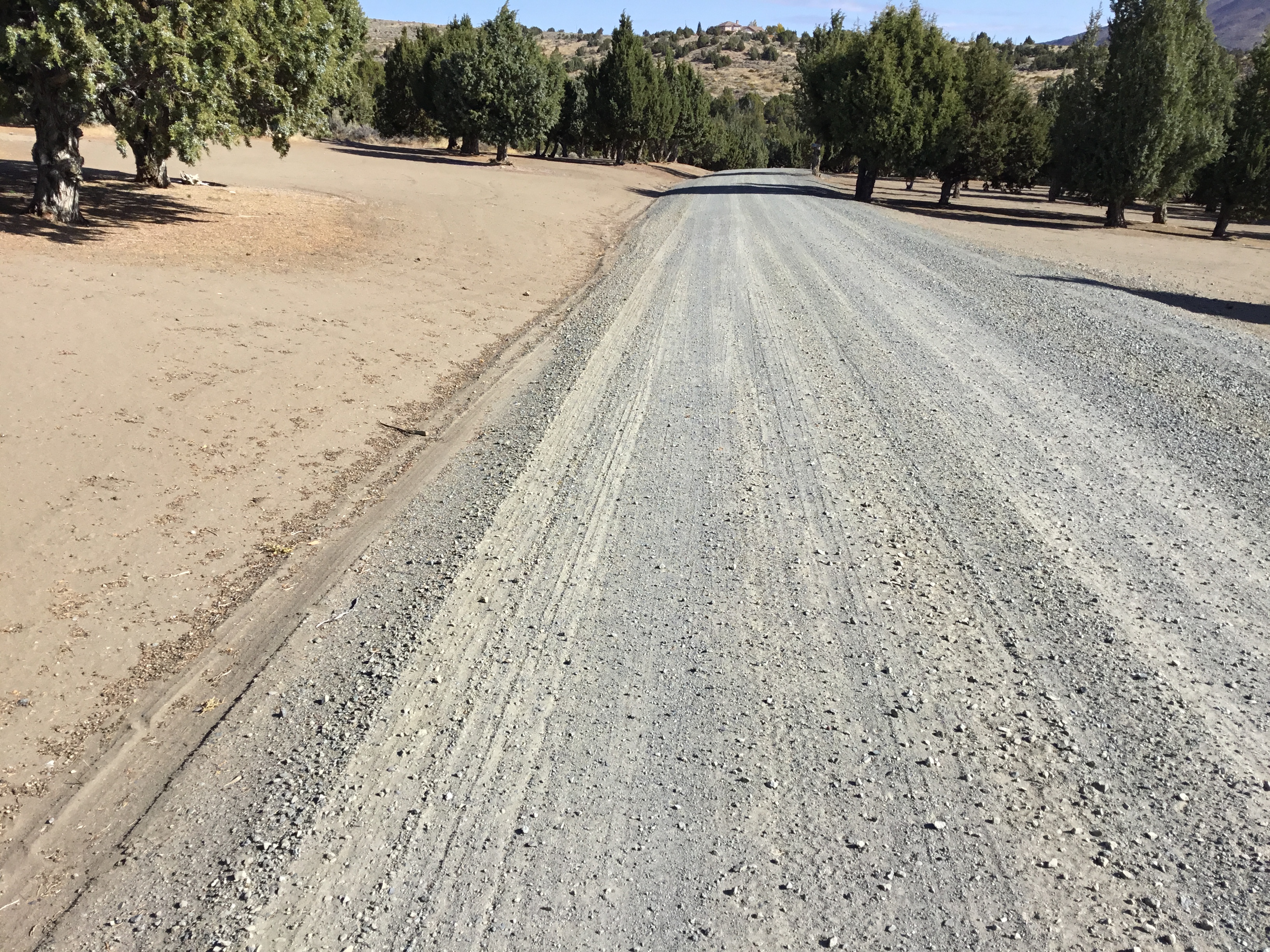

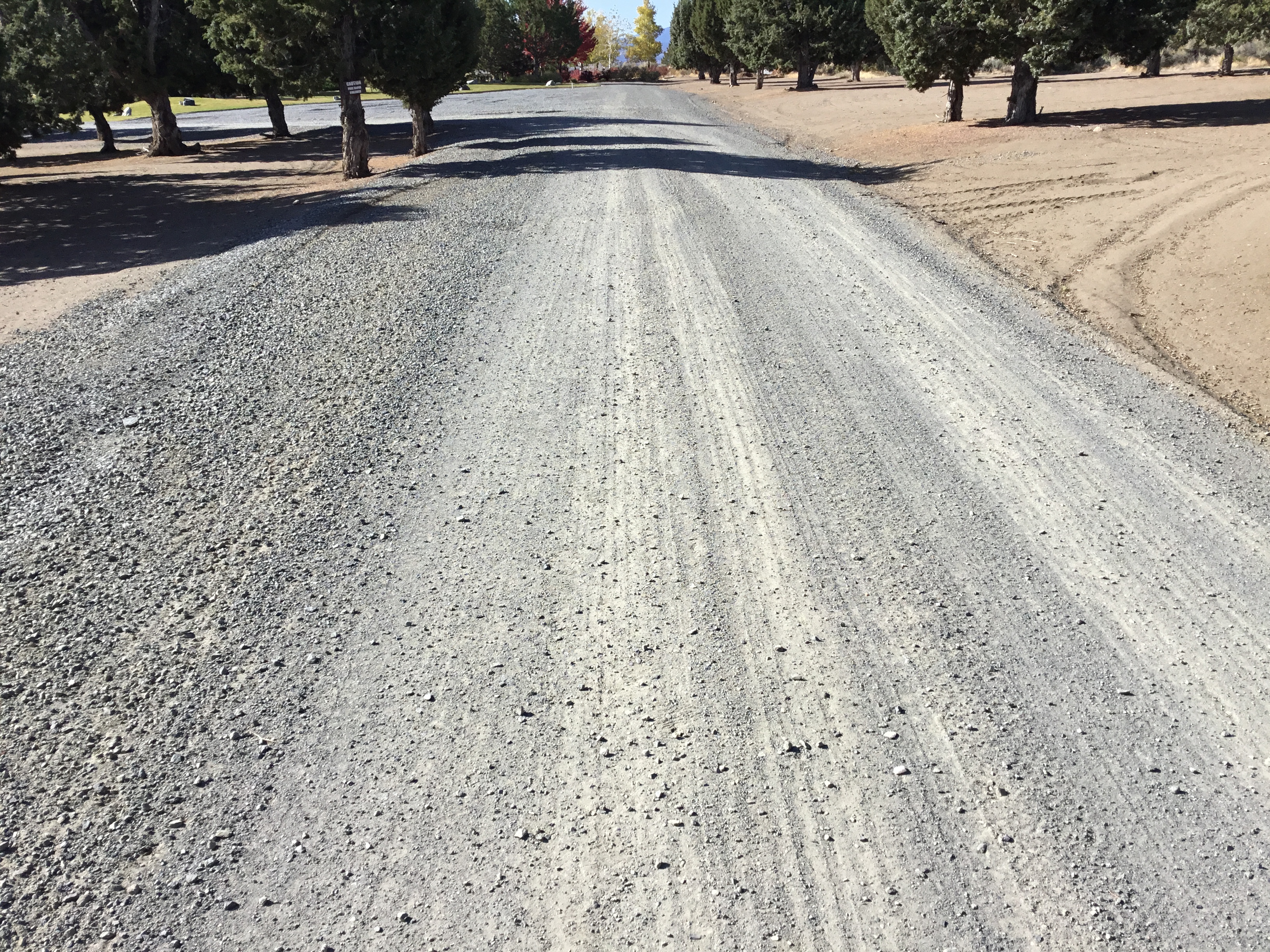

Here are some driveway shots this morning. Gravel more visible on the edges. Main surface is hard pan. No real issues in the summer with no rain but in the late fall/winter the driveway gets rutted and muddy. Gravel has been added periodically but gets disturbed when plowed in the winter.

Thanks for the pictures, they really help assess the situation. My recommendation is that ultimately you will need 2 separate implements. First, a LPGS, this will do the majority of your maintenance. Second, a good rear blade. This will be used to maintain the crown and keep the edges cleaned.
Hi,
Land Planes are great for spreading stuff around, more of a cosmetic touch. But to rough up the hardpan so you don't get the potholes in the same spot you need to "resurface the driveway" kinda change the characteristics of the road, a boxscraper is much more able to dig into the hardpan, it does a really good job of smoothing it out as well. Not as nice a finish as a plane but a plane doesn't dig into the the road either. Also in most circumstances you shouldn't add gravel to the road, add "class A" or driveway topping, it packs hard and you get less transfer of gravel to the sides and it compacts better (hence the Box Scraper to grade it once a year. Have fun thats what it all about.
