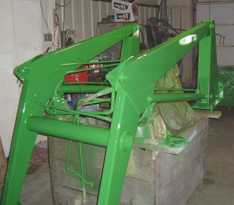

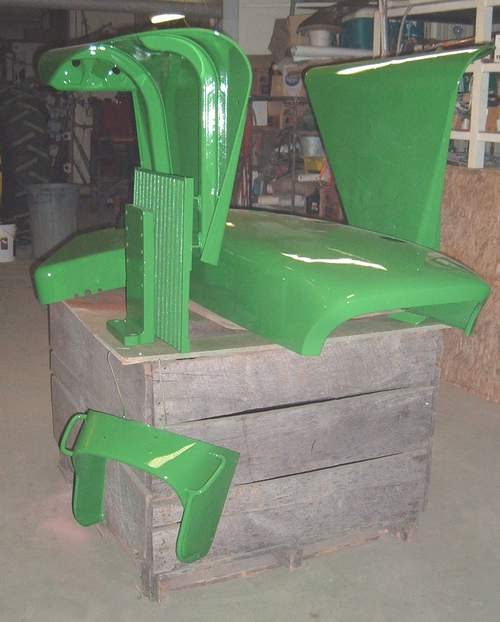

I flip stuff around to paint and used a pressure pot so the gun would spray all position. It's really stripped which helps and my booth is big enough I can lay out a whole tractor.
The pictures might be from various jobs, some this more than once. I like rigging on pallets if I can, turn in progress or stage and can stay up wind put the stuff in the air stream, the booth clears very well.

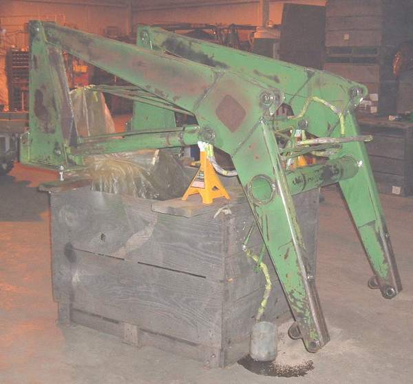

So, I will try to recover some pics. But was a snow grade or groomer. Sander, about 40 or 50 80 grit da, then some 4 inch wire wheel and finally reach with heavy pencil cup style wire
Got it done and on time and budget, when I quoted it they moaned over pricing but when they got it all that went away
They asked us to do more and didnt blink at the quotes.
Only used color, got it all on, it was cool and o waited tje next day to do a second and just dry enough I could really hang a wet top coat on and level the flats
There is some painter spray skill but it mainly looked so good from doing a good cleaning job.
