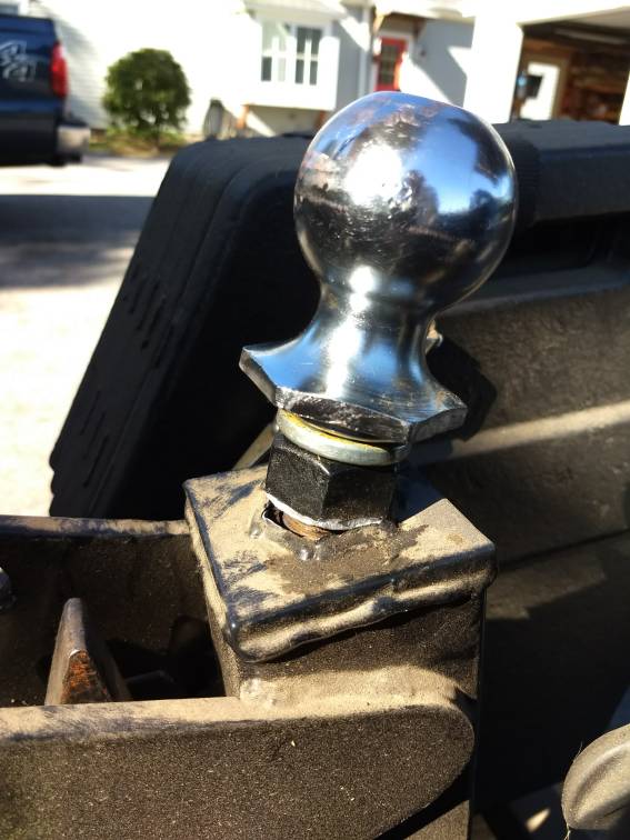

The Franken-ballast has been working great.
Yesterday I was using it to move my 25ft gooseneck equipment trailer. Went to set it down and the ball wouldn't disengage like usual. Found out why....
This scary cold weld was part of the original Countyline trailer mover I built around. I know this was designed for low speed but still seems dangerous as heck.
I ground down and rewelded the nut.
   / Franken-ballast: expensive and poorly planned! #29
Yikes!
Low speed failure might be okay sometimes, but doesn't matter if you're on unleveled ground and the trailer decides it wants to climb up with you into the tractor seat.
Mind did the same thing if not slightly worse. 7 yards of dirt in my dump trailer behind a 100 hp Deere. Wrecked all the treated and broke the bolt. Going to weld a piece of 3/4" plate where the nut was, blow out a hole and weld the ball solid.

Ya, that nut is going nowhere now! Lol.
Hope you didn't loose the trailer. That's a lot of unsupervised weight!
