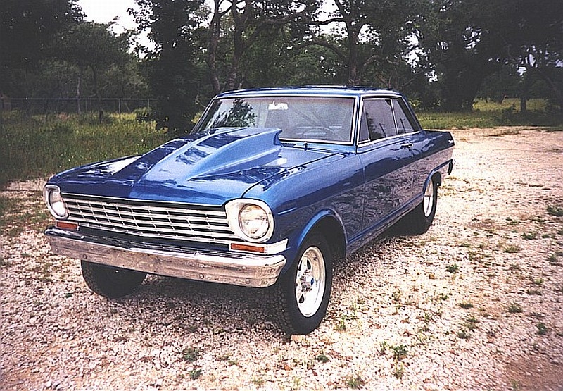

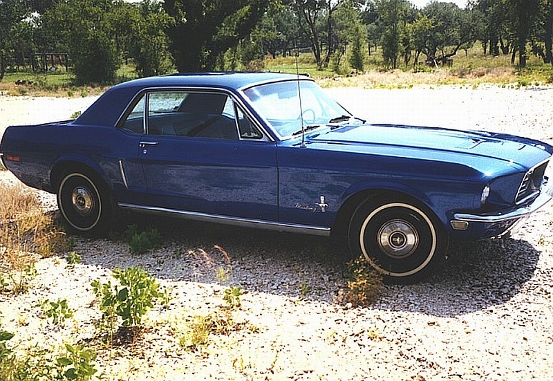

Back when painting was nearly a daily task for me, epoxies were a time consuming headache. If you didn't get your top-coat on within the specified time, it had to be scuffed or the paint wouldn't stick to it. I found it more important to do the metal prep first, use a good etching primer and not try to seal in rust and slag with epoxy.
