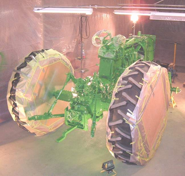

first time painting - should I grind off the thin surface rust or just apply rust converter?

I agree with the phosphoric acid treatment but you need to make sure it is completely dry before priming. It will have a chalky look when dry. If you are painting with a compressor/gun, also make sure your spray air is dry during priming. Use a filter/drier before the hose and blow-out the hose before using it. Drain the filter/drier after each use.
This is cheap insurance when you think about the cost of good paint and all your hard work. Ditto on the excellent welding job. (y) Can't wait to see the finished product. :cool:
Thanks for very interesting comment about dry air. We currently have 95F weather and around 30% relative humidity. I attached an air prepping unit to the compressor (the one that has 2 cylinders, one for oil removal and one for water + pressure regulator) and not a single drop of water was collected while spraying.

You are fortunate to have such dry air. I'm frequently compressing 85-95 degree air with 75-85% humidity. Besides having an air dryer/cooler after my compressor, I have a filter/dryer before each hose outlet. In addition, I use a small "ball" filter at the spray gun. There's a lot of times spray painting is just impossible due to humidity. The evaporation of the thinner will sometimes cause dew to form on top of the paint. This fogs the paint or gives it a dull white overcast.

For the guy doing this job. Get some maroon Scothbrite,,, the painters best friend, scuff it off and spray some shat on it. Put the color on it. A lot of equipment doesnt even get primer, gets color sprayed on it.

The fails come from simple things in this kind of work, didnt scrapa a gob off, on cars its people running their hands on them af6ter eating chips, its from not scuffing after blast where paint sticks thru. Rusts thru where a hole was repaired with bondo.
