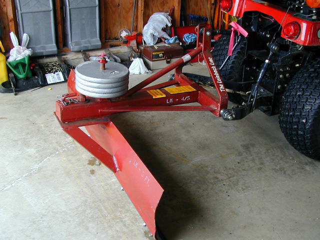

Hi LAX,
I think I got this idea (see attachment) from someone else on this board, but I had this post welded on last year. It allows me to put a/several weights on it and really helps prevent my blade from riding up over the snow.
Good luck and keep having fun. They're calling for 6-12" of snow here by tomorrow afternoon!

Cool idea - may have to try it if I have trouble "gettin' down"...

Funny /forums/images/graemlins/grin.gif Your adding weight to the back blade and I'd prefer mine was lighter. It likes my undulating asphalt, even with the shoes. We are always adjusting our implements to suit. Gettin dialed in.....Half the fun. /forums/images/graemlins/smile.gif

</font><font color="blue" class="small">( Funny Your adding weight to the back blade and I'd prefer mine was lighter.)</font>
For the most part, I love my sub-cut GC2300. But I think the implements for these machines generally tend to run toward the lighter side. On dry-moderate snow, my backblade will keep pretty good contact with the ground, but in wetter, packable snows, it tends to ride up over the snow. The weights really help the blade to maintain ground contact.
