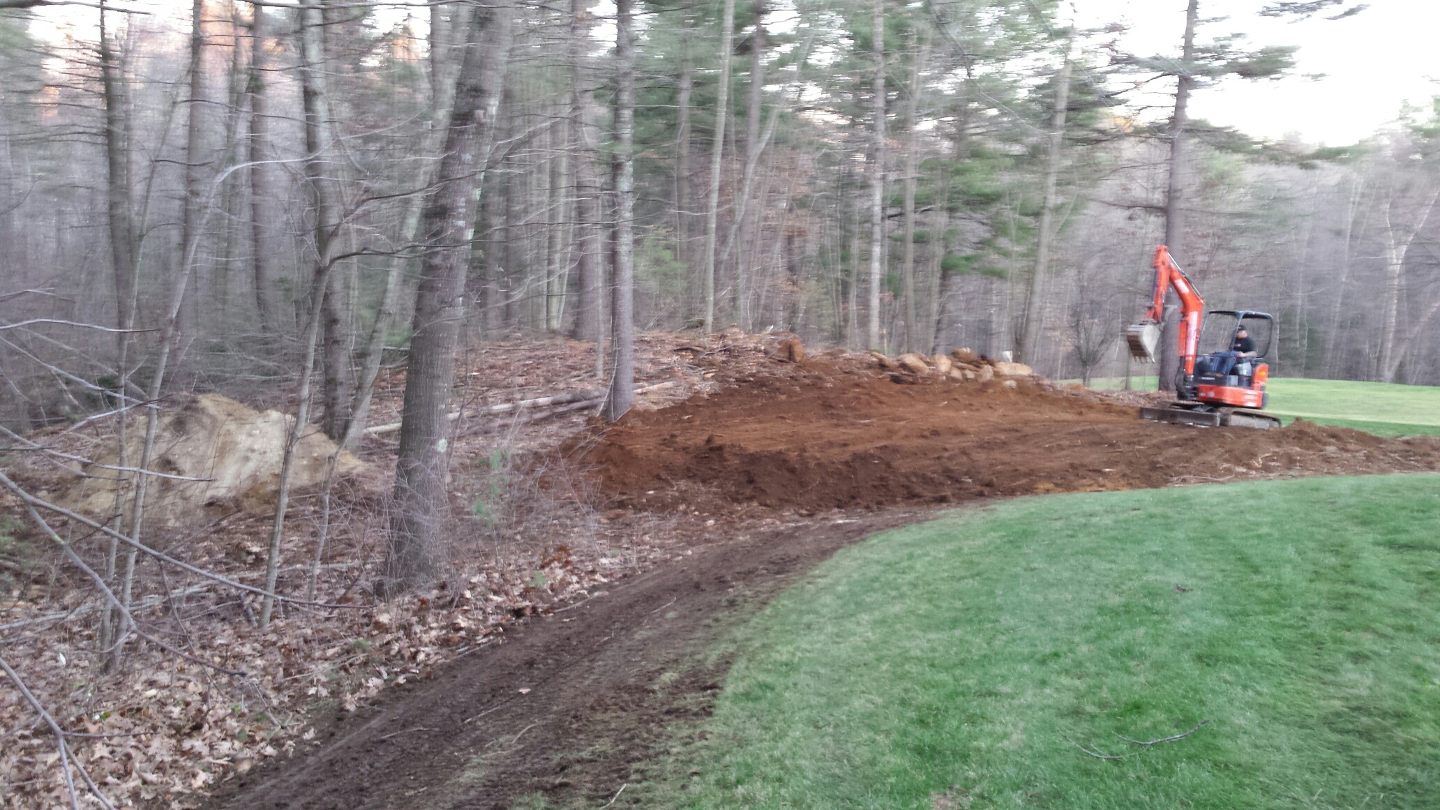

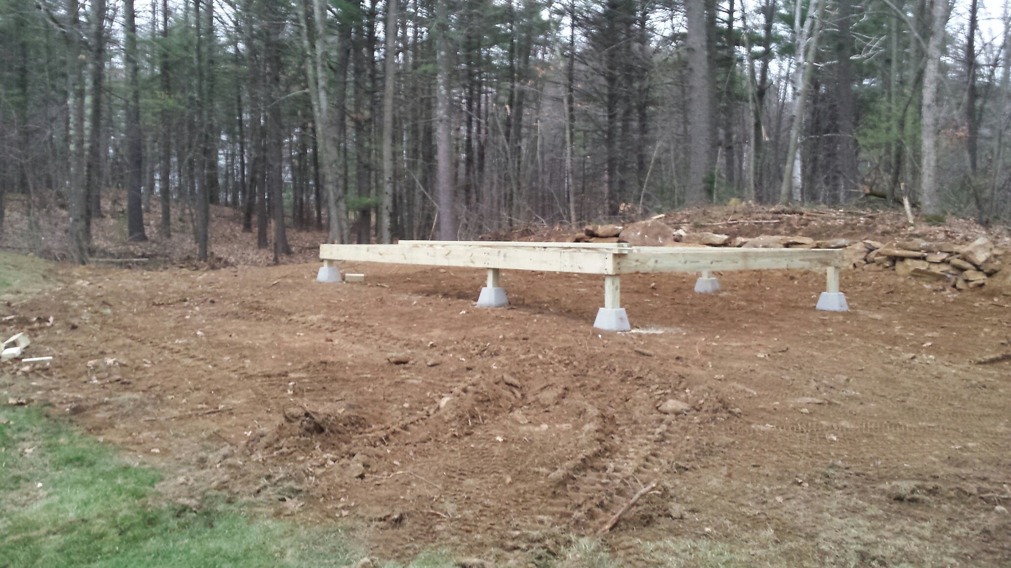

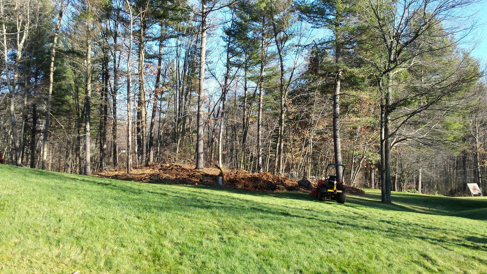

Thanks Boat.
I really don't have man-made obstructions - just trees. I assumed box blades were for dragging long and straight and I am working in areas I clear which for now would require lots of turning. Areas the size you see in the photos in the original post.
The rocks I pulled out were around the size you describe - some bigger and some smaller but none I could not load into the bucket by hand. Much of what I dig up is brittle ledge (shale?) that breaks apart. I am sure I could go slow and feel roots before they did damage. Most of the roots I have encountered have been shallow and less than 1.5".
As for leveling, I did find I used more material than I thought I would to level the fire pit area. In hindsight I should have brought in loam at $10 less per yard and worked that first as I have a back blade and wheeled landscaping rake.
On another project I will be bringing in lots of fill followed by loam to prepare the site for a shed. A HF shelter sits there now. Will the BB work for fill with 3 inch or less stone or is it strictly a dirt tool?
As you can see I have a lot to do as the shed will have a much larger footprint and this temp is out by well over a foot already. The back corner you can't see is touching the pier block.
In one of the photos taken last fall you can see my friend's tractor; now it's mine!
BTW, my tires are filled and with a full bucket of stone and no counter, I had zero rear lift.

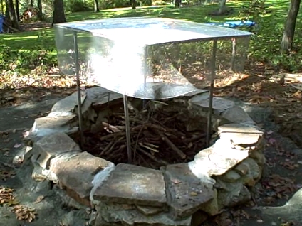

Nice job, Avery.
When I built my firepit, I made it big enough to throw old pallets in. I also put an old hood from a police car over the pit to help knock down any sparks.
Good luck with it.

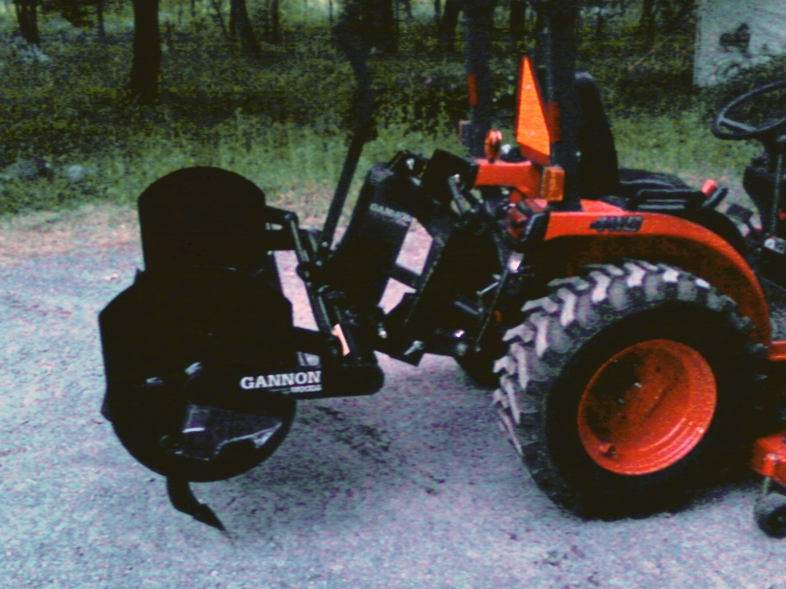

Hi Avery,
Nice work- I think your fire pit site was better prepared than my barn site was...:laughing:
I agree with BotaSkinner and want amplify that unless you want to spend beaucoup bucks for a hydraulic remote setup for your 3-point hitch and/or spend way too much time learning to use a box blade, it would be a good idea to search out and find a roll-over box blade like my [Discontinued, but sold to me new on pallet] 48" Gannon Earthcavator.
http://www.tractorbynet.com/forums/...4-gannon-earthcavator-rollover-box-blade.html
Dirtdog makes a new one, but it's about $1400 plus shipping.
I found my through searching EBay, Craig's List, the tractor and implement sales sites [including Sweet Tractor] and especially by supplementing that through separately emailing as many re-sale vendors as possible to ask them to keep an eye out for one in the 48-60" range, figuring that if I got one bigger than recommended, I could always just go slower or not as deep.
The 48" Gannon is plenty heavy and can make our little 2011 B2320 sit-n-spin in place if I get it into just the wrong stuff, but generally they're a great match for each other.
Also consider weighting your tires, especially if you want to get the best out of both your FEL and a BB.
Happy tractoring,
Thomas
PS: Here are some pictures of our tractor and ROBB.
PPS: "Will the BB work for fill with 3 inch or less stone or is it strictly a dirt tool? "
We use ours with #1 and #2 crusher run all the time [1 and 2" average for the larger stones mixed with fines], and it works well.
We pull it forward with the back facing blade deployed on the ground and it works really well for spreading and smoothing that way.
We also back drag with the bucket with the PTB on with good results.
Thomas
