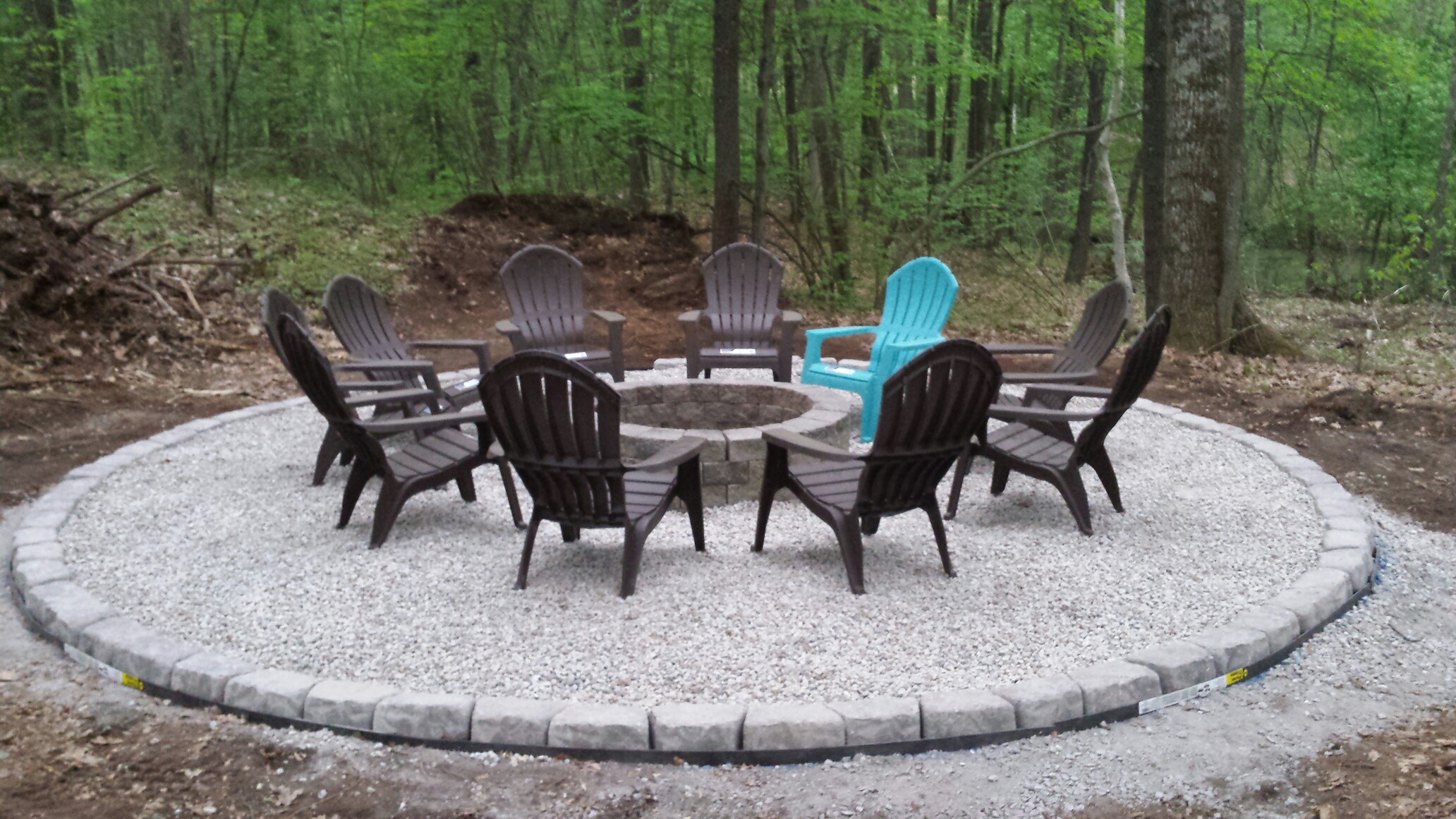

Hey gang,
I usually rip through projects from start to finish and never stop to snap before and afters. Since this is my first project using my B2320, I decided to slow down a bit and take everyone along for the ride.
SITUATION: Wife is tired of the old fire pit.
MISSION: Build a new fire pit in the woods on level ground.
EXECUTION: Use the tractor to level terrain and haul materials thereby justifying said tractor.
SERVICE SUPPORT: Wife and 3 strong young men.
COMMAND and SIGNAL: Take 1 guess...

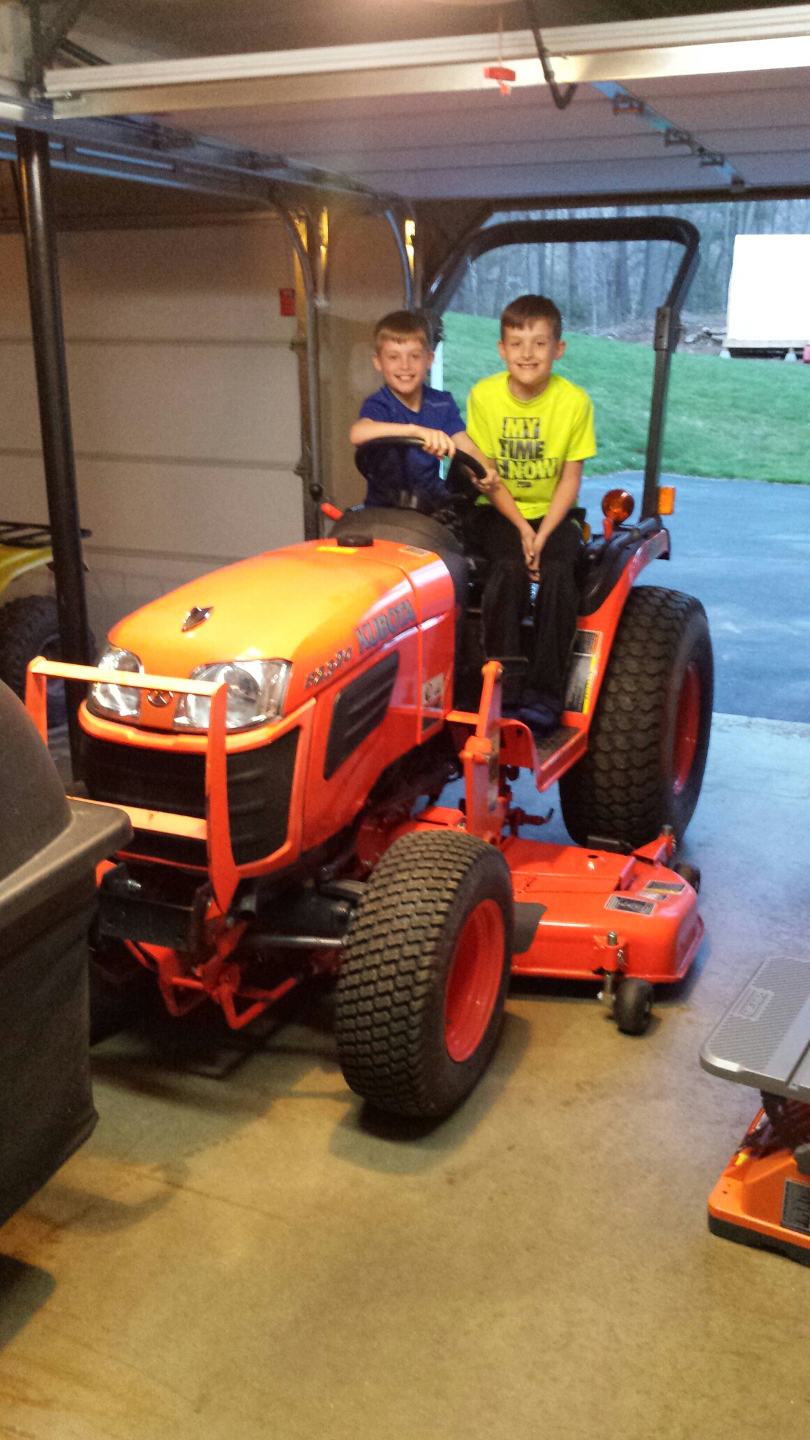

Here we go. First I had to get one of these...

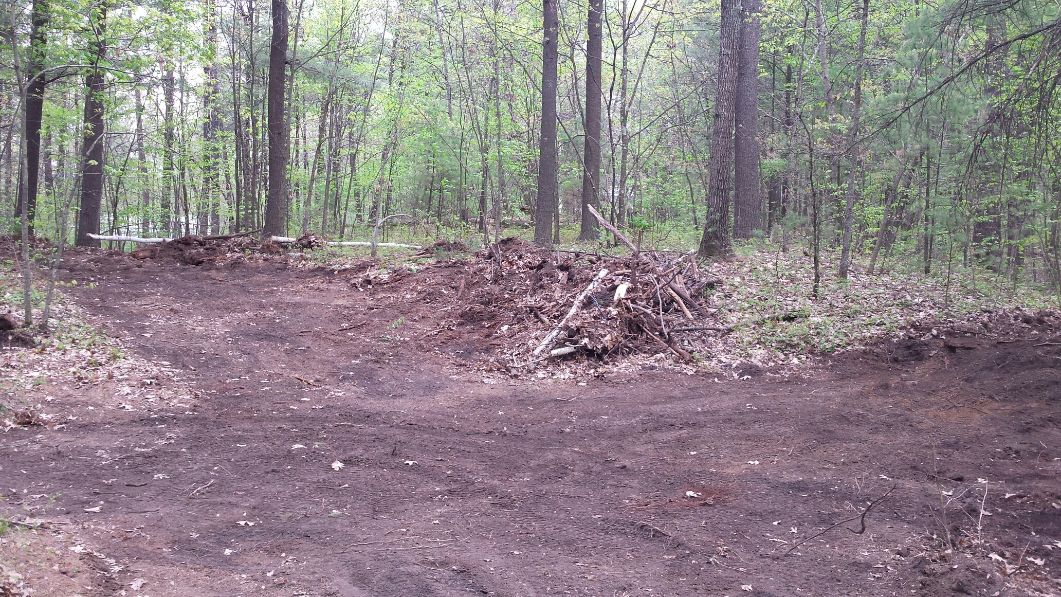

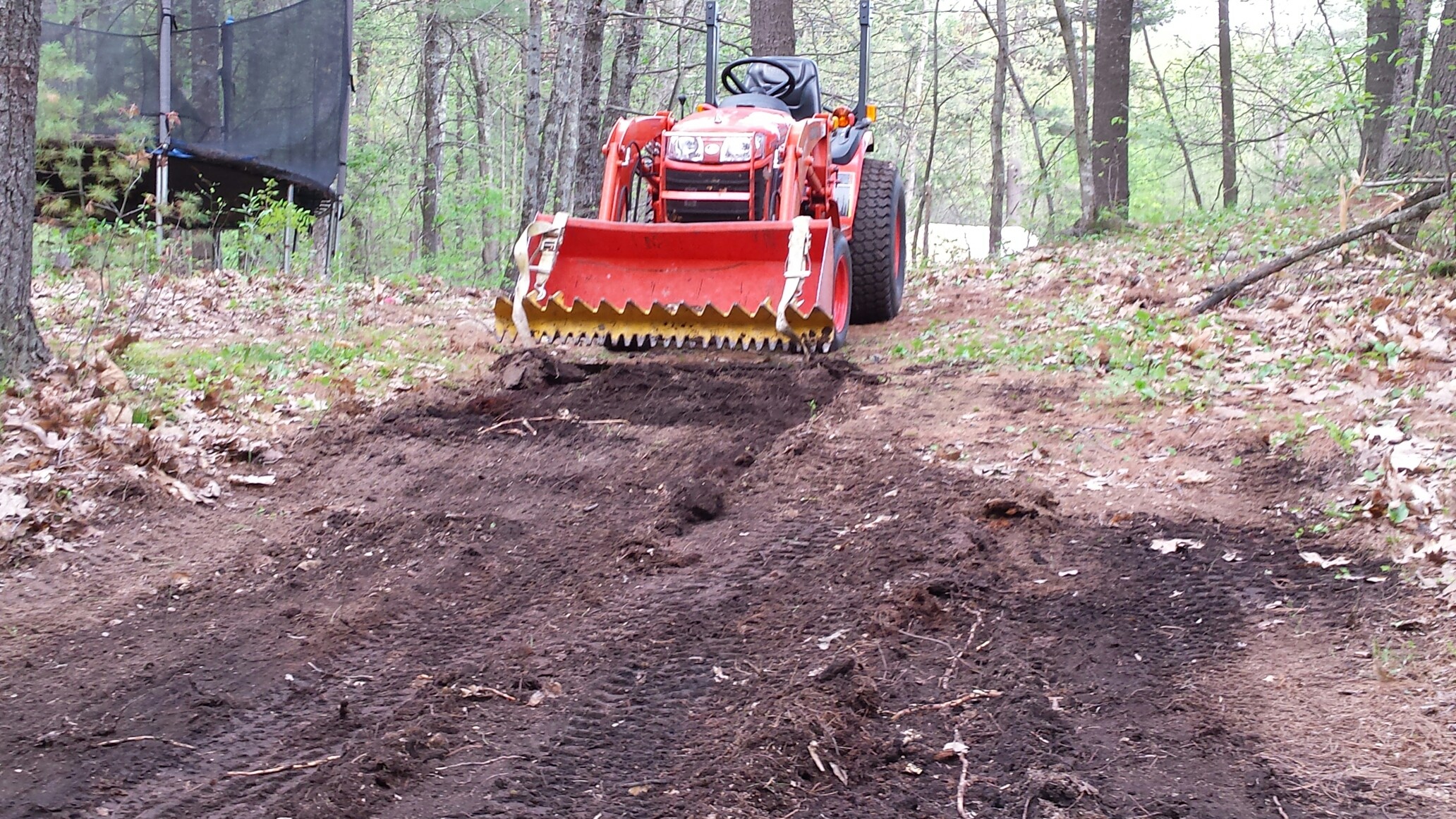

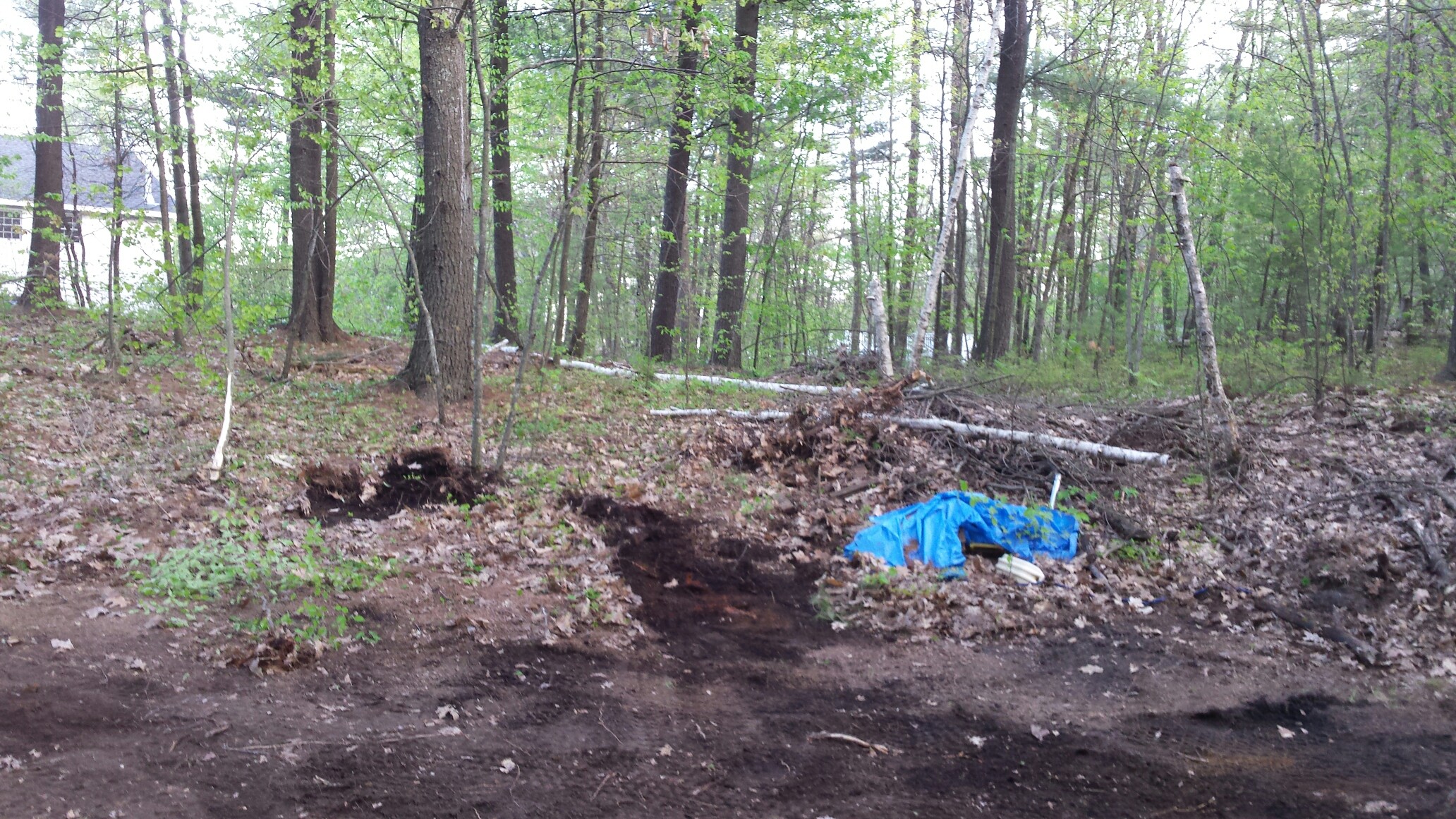

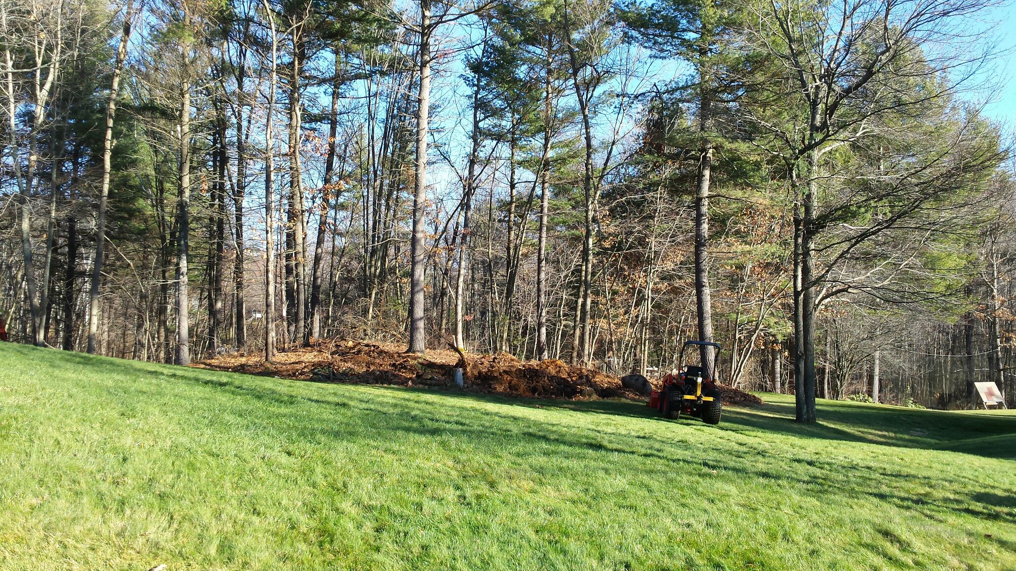

After learning a bit about the machine, I headed to the woods to pick out a spot. Far enough in to feel like I'm away but close enough to run to the house for "supplies". Here is what I started with (I had already begun to rake)...
/ First project with my B2320 WITH PICS
About 2 or 3 inches of forest duff had to be scraped off. I don't have a tooth bar for digging but I do have a Ratchet Rake which came in handy. Cleared about 1000 sq ft as there are plans for more out here in the future. The trash piled up quickly and made me wish I had a grapple. The rake revealed quite a few chunks of ledge, all of which were manageable.

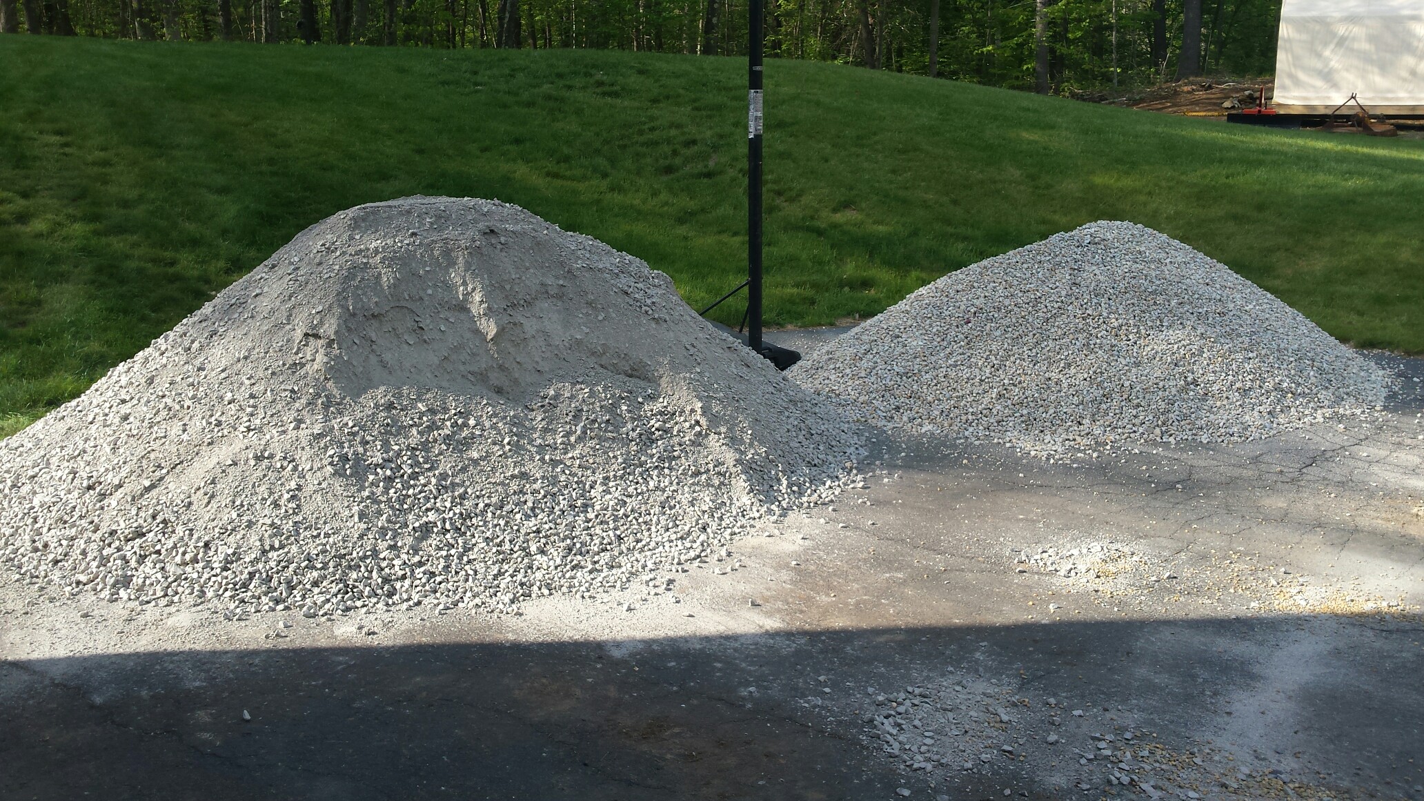

6 generously measured yards of crushed gravel and 5 yards of 3/4" stone. Nothing fancy but a big haul for a small tractor - I'd say about 15 tons.

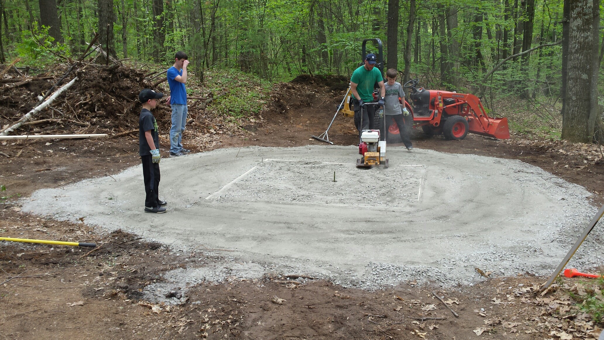

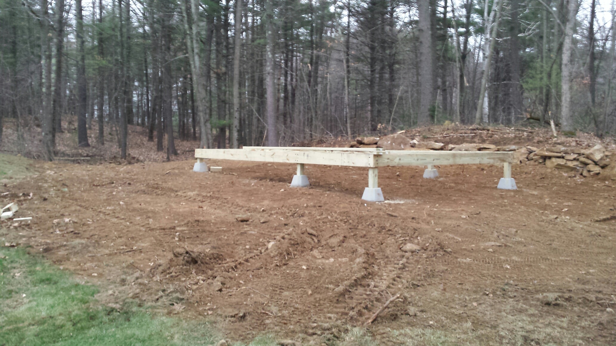

The family really stepped up. This was a back breaker at times. For layout, I pounded a 3' steel steak in the rough center of where the ring would go.
Next, I made a square frame from 4 2x4x8 studs. I leveled the square and held it fast using available stones and 12 inch galv spikes pounded through holes drilled through each end.
I drilled another hole for the center steak through a straight 2x4x10 and used it as a compass. I laid out a 20' diameter using marking paint.
Then came the crushed stone for fill, bucket by bucket. As I poured, the fam raked and we screeded by spinning the 10 footer around resting on the square frame to make a flat plane.
When we had a flat 20' circle, we compacted and laid out 2 more circles with paint: 1 for the perimeter and one for the pit to keep it perfectly centered.
Finally, I put down a weed barrier and filled with finish stone. I still need to lay loam around the edges and grade it out so there is no step and no erosion of the edge. We will likely place low greenery around the ring to hold the soil and give it a nice transition. Picked up some very nice steel torches that will go into pvc sleeves in the ground. It came out pretty nicely.
Gravel and stone from local landscape supplier, fire ring blocking repurposed from an old retaining wall, and everything else from the big blue box. For reference, I have just shy of $800 in it including chairs and torches.
Next time I will order the crushed gravel from an excavating supplier in town for about half of what I paid the landscape supplier. I wanted to see how this came out first as the excavating co. has a 15 yd minimum.

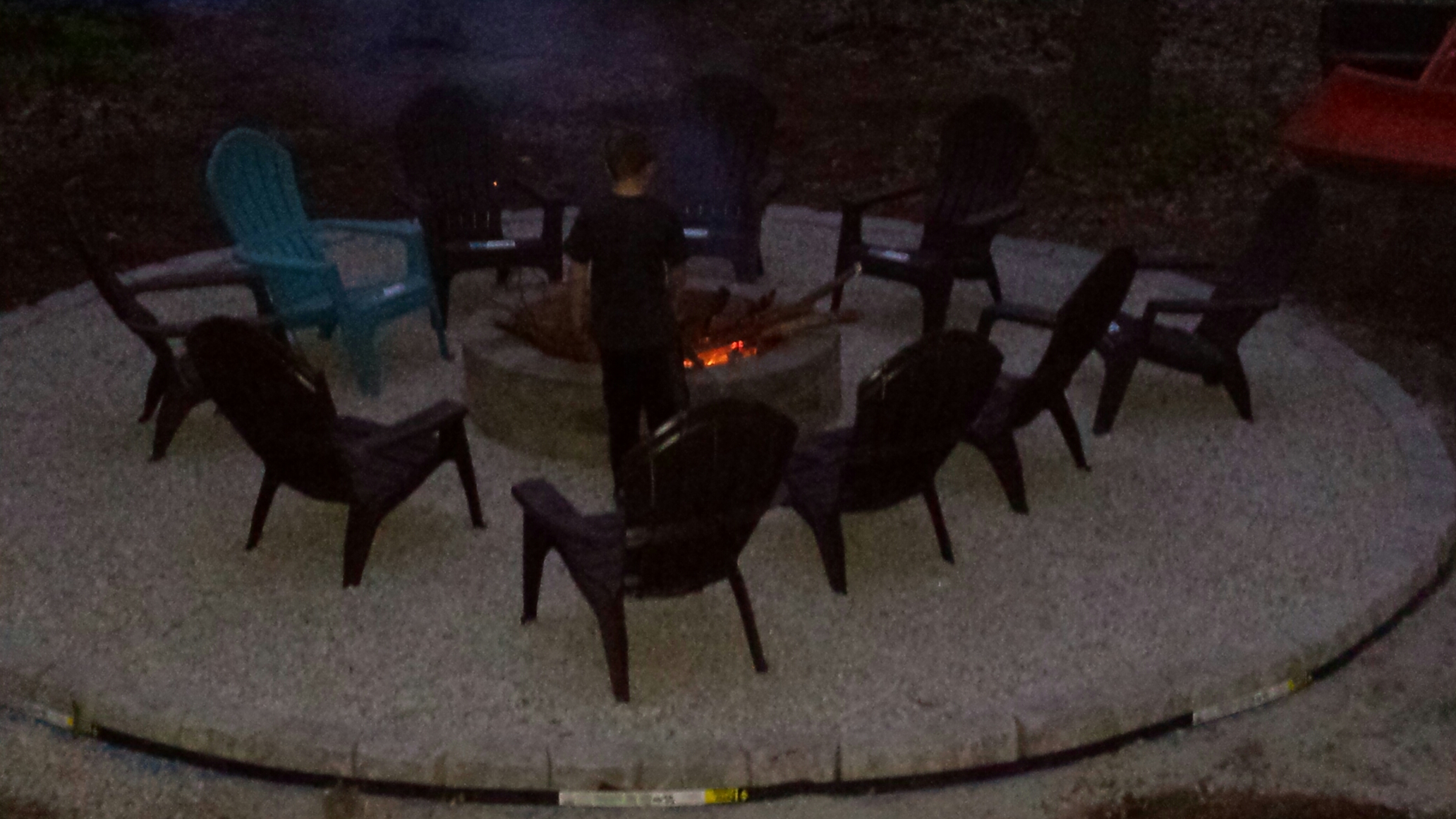

It was a long, dirty, hard workin day and a perfect night for a little fire and a few burnt hotdogs. Happy tractorin, Amigos.

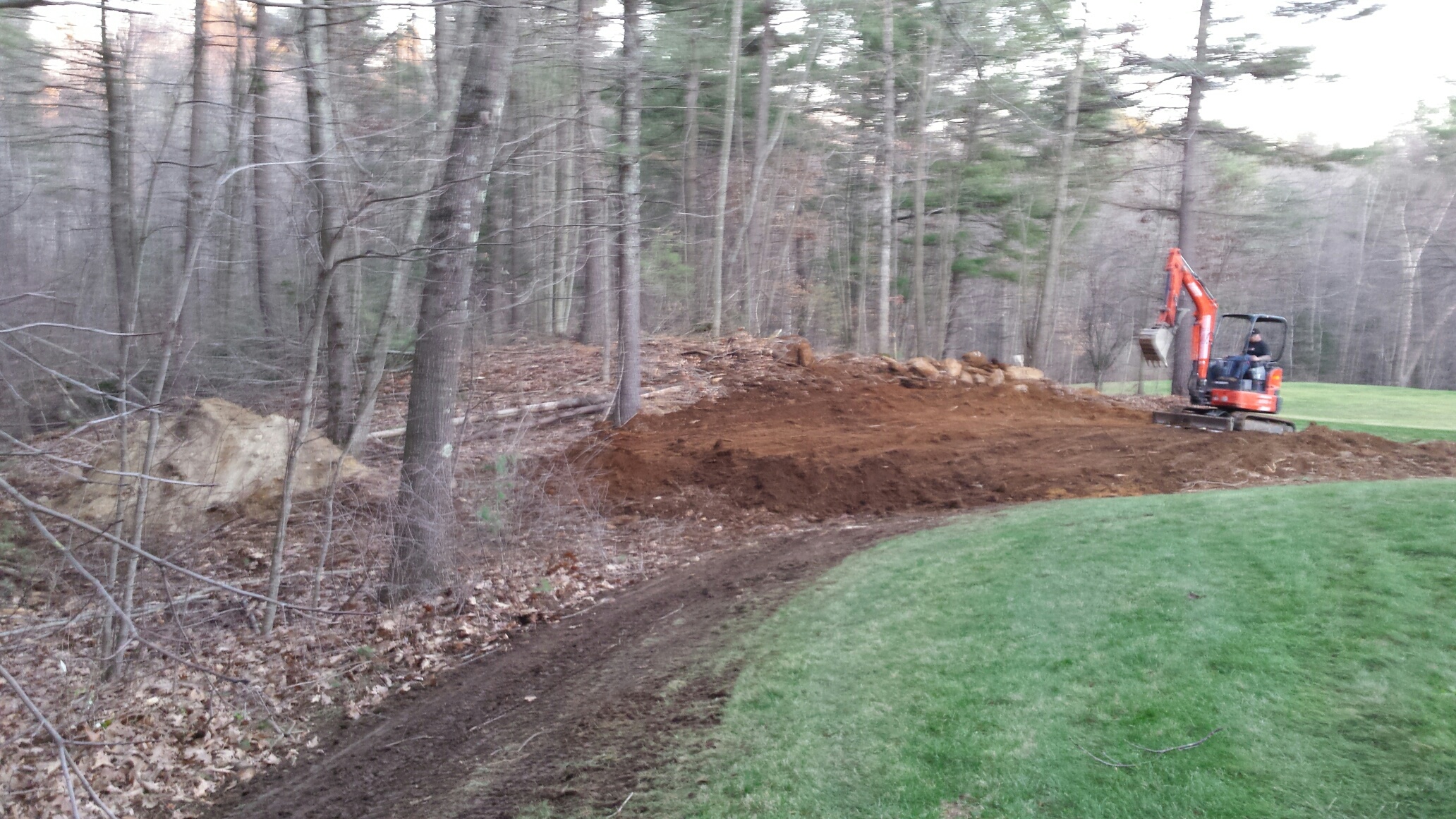

On another project I will be bringing in lots of fill followed by loam to prepare the site for a shed. A HF shelter sits there now. Will the BB work for fill with 3 inch or less stone or is it strictly a dirt tool?
As you can see I have a lot to do as the shed will have a much larger footprint and this temp is out by well over a foot already. The back corner you can't see is touching the pier block.

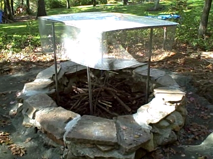

Nice job, Avery.
When I built my firepit, I made it big enough to throw old pallets in. I also put an old hood from a police car over the pit to help knock down any sparks.
Good luck with it.

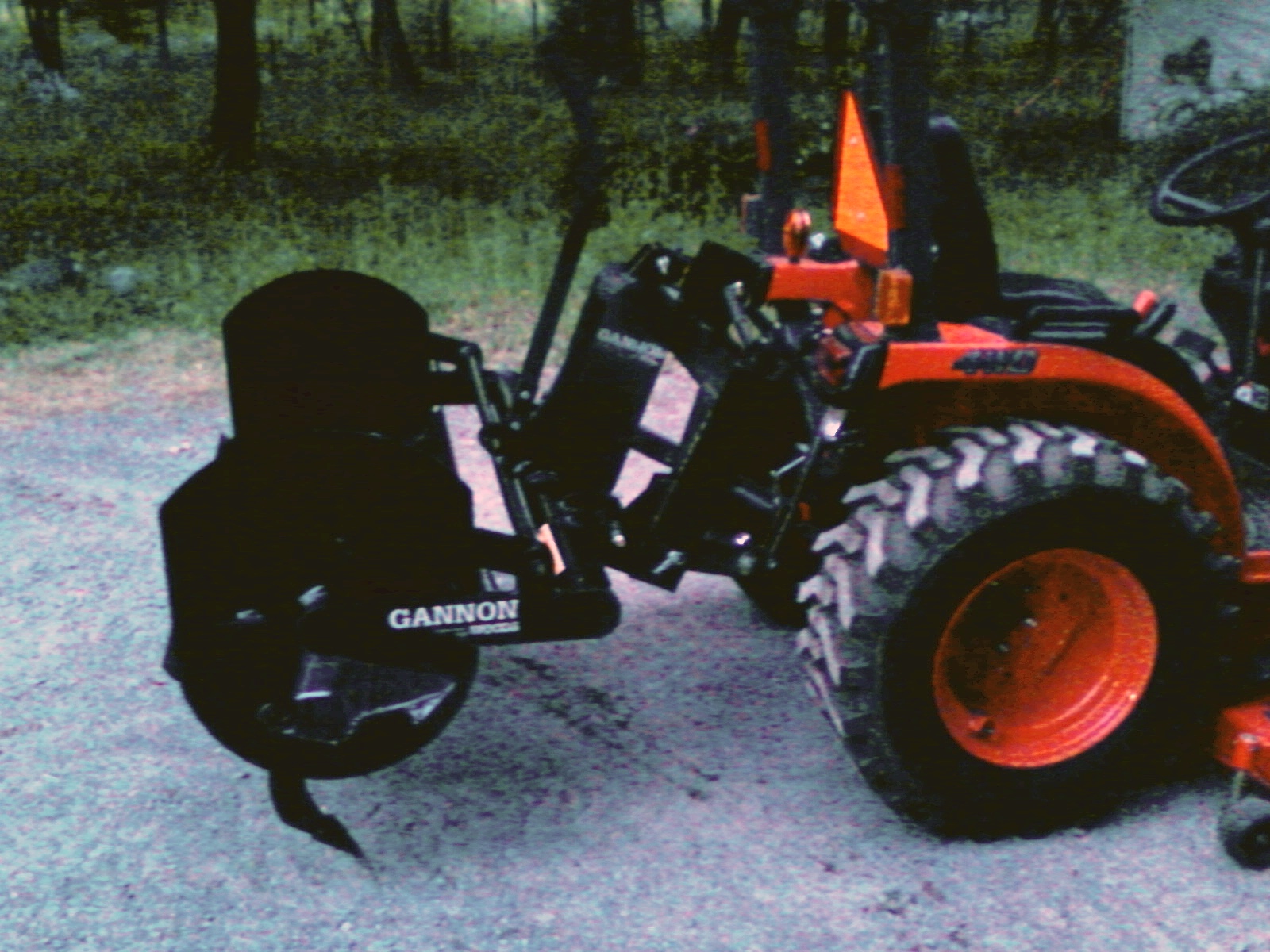

Hi Avery,
Nice work- I think your fire pit site was better prepared than my barn site was...:laughing:
I agree with BotaSkinner and want amplify that unless you want to spend beaucoup bucks for a hydraulic remote setup for your 3-point hitch and/or spend way too much time learning to use a box blade, it would be a good idea to search out and find a roll-over box blade like my [Discontinued, but sold to me new on pallet] 48" Gannon Earthcavator.
http://www.tractorbynet.com/forums/...4-gannon-earthcavator-rollover-box-blade.html
Dirtdog makes a new one, but it's about $1400 plus shipping.
I found my through searching EBay, Craig's List, the tractor and implement sales sites [including Sweet Tractor] and especially by supplementing that through separately emailing as many re-sale vendors as possible to ask them to keep an eye out for one in the 48-60" range, figuring that if I got one bigger than recommended, I could always just go slower or not as deep.
The 48" Gannon is plenty heavy and can make our little 2011 B2320 sit-n-spin in place if I get it into just the wrong stuff, but generally they're a great match for each other.
Also consider weighting your tires, especially if you want to get the best out of both your FEL and a BB.
Happy tractoring,
Thomas
PS: Here are some pictures of our tractor and ROBB.
PPS: "Will the BB work for fill with 3 inch or less stone or is it strictly a dirt tool? "
We use ours with #1 and #2 crusher run all the time [1 and 2" average for the larger stones mixed with fines], and it works well.
We pull it forward with the back facing blade deployed on the ground and it works really well for spreading and smoothing that way.
We also back drag with the bucket with the PTB on with good results.
