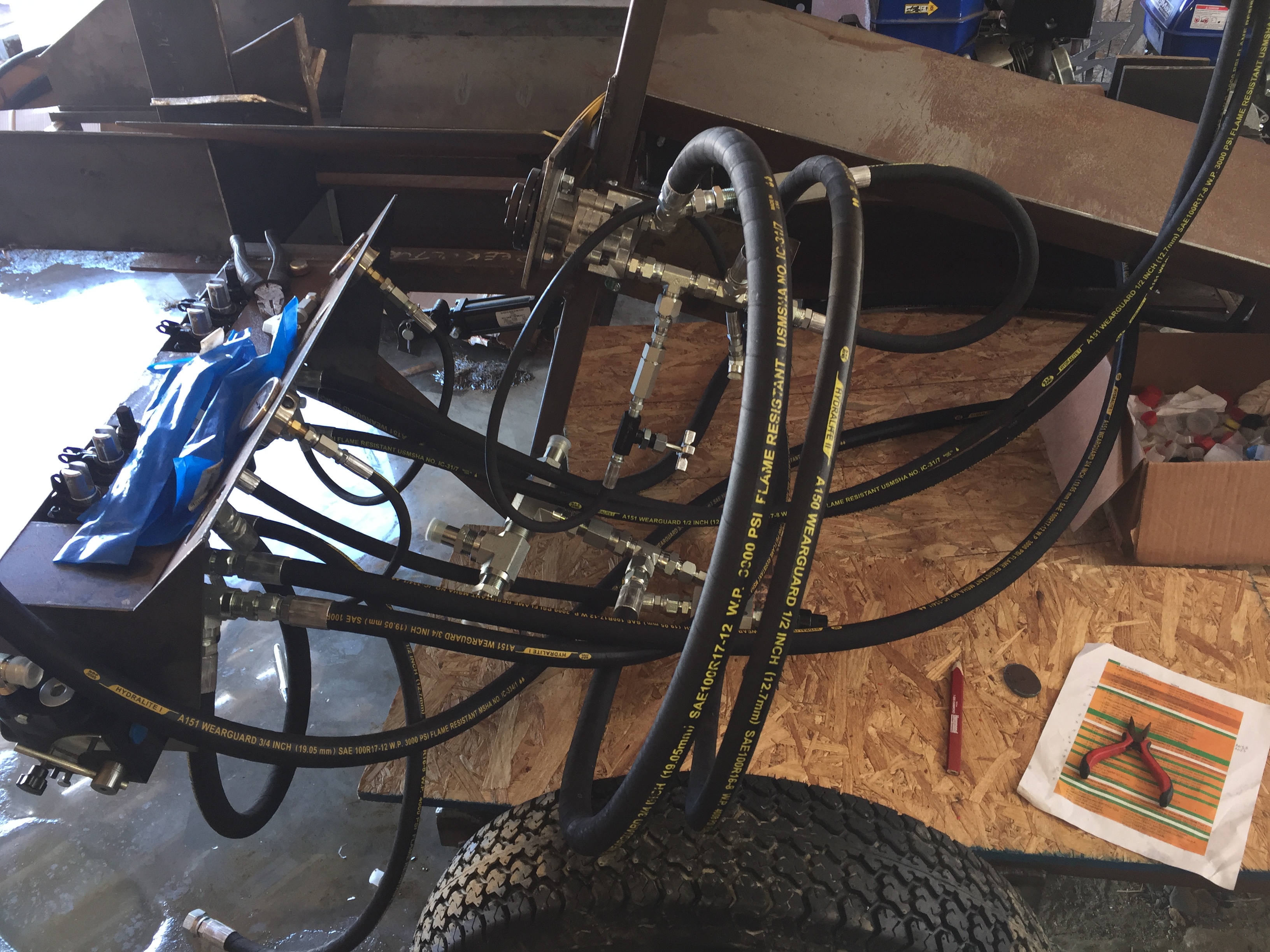

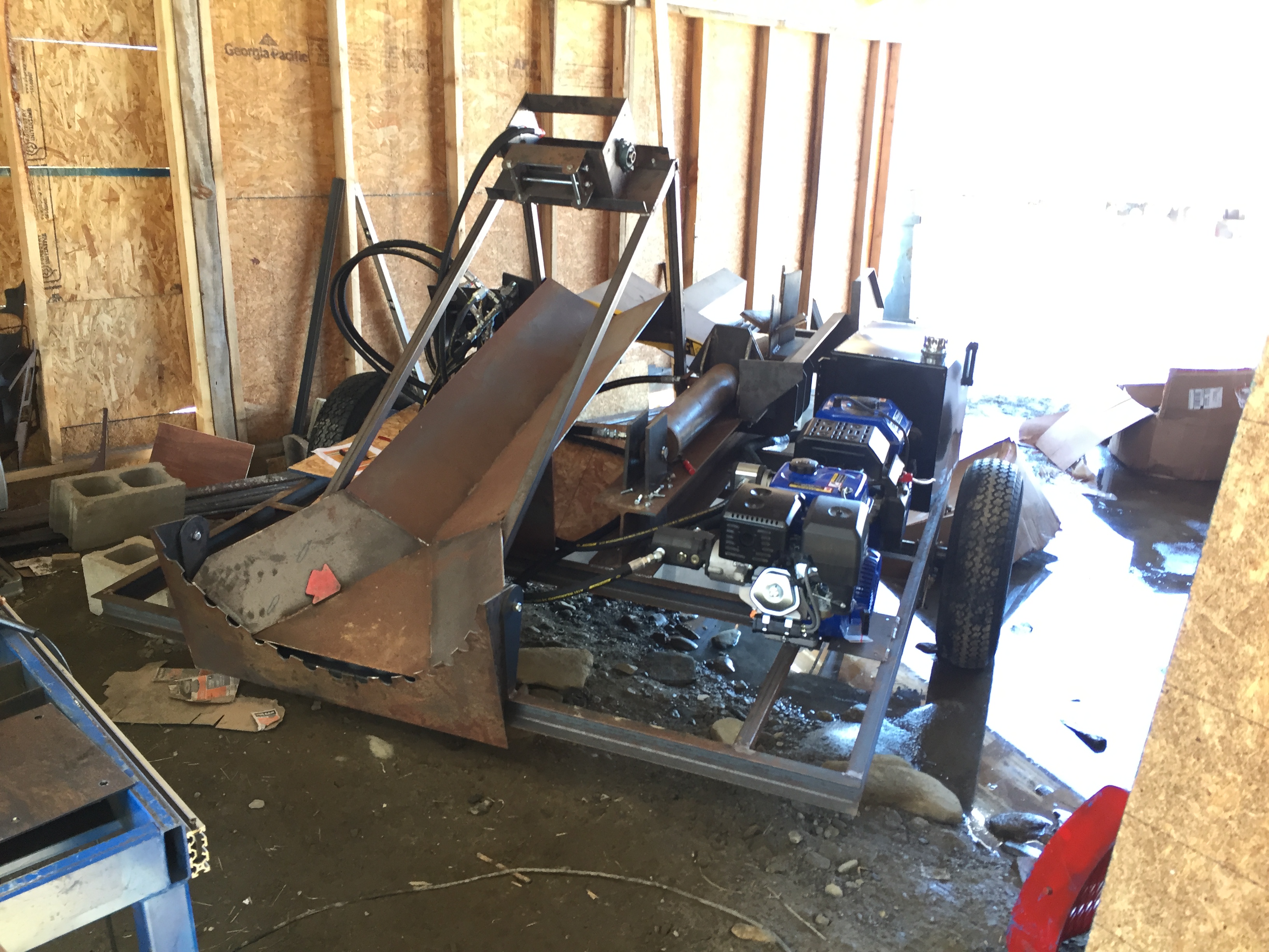

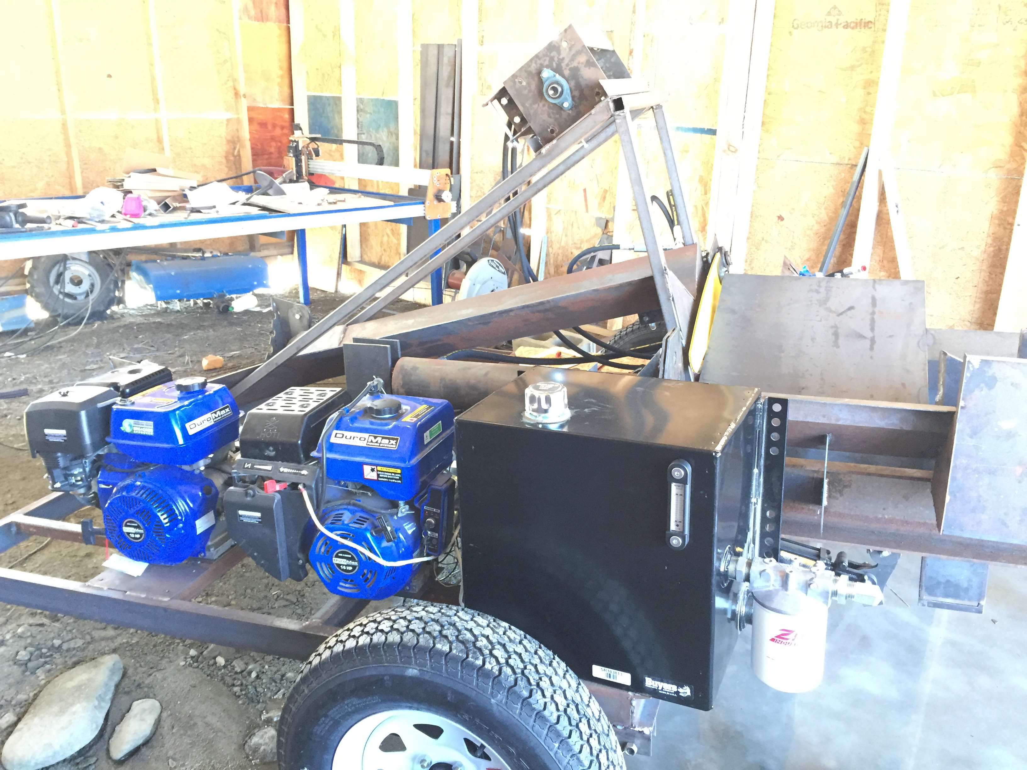

The winch type firewood processor finally got an update. :)
My apologies for the mess!
