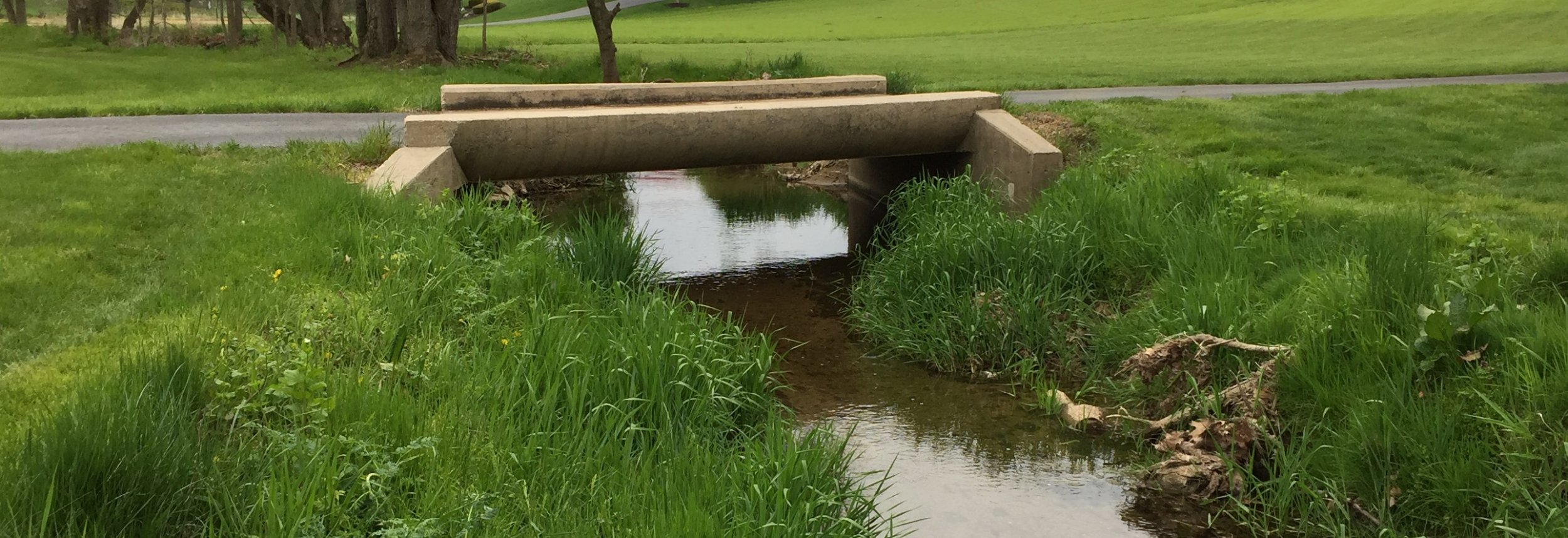

Here's the bridge to our place. The bore is 16' wall to wall inside and around 4' above the average water elevation. I told the engineer it needed to be strong enough for fire trucks / dump trucks. I'd have to check the old drawings for good dimensions, but IIRC the footers are 9-ish feet down, walls are a foot thick, deck is 10" or a foot and the sidewalls stand about 6" above the deck.
The property is a piece my FIL sliced off a farm, and it took 3 years of dealing with red tape between the time he said he'd sell us the land till we "bent" ground. Start was too slow to say we "broke" ground :) The creek had a large U bend that ran from the other side of the bridge in the picture to about 50' behind where the camera was for the picture. The engineer calculated that building the bridge in the flood plain and eliminating the U bend cancelled out. He had to work with runoff figures far a rather large area of land. The process was started around 1986 and although I can't recall the cost, it wasn't cheap. The bridge itself wasn't very expensive. The GC we used for the house did it as a change order for less than 4 grand. I was going to build the bridge myself, and even got a quote on the rebar, but with such a bargain price - plus I was doing the electrical, plumbing, HVAC, central sucuum, etc - it was nice not having that to deal with.

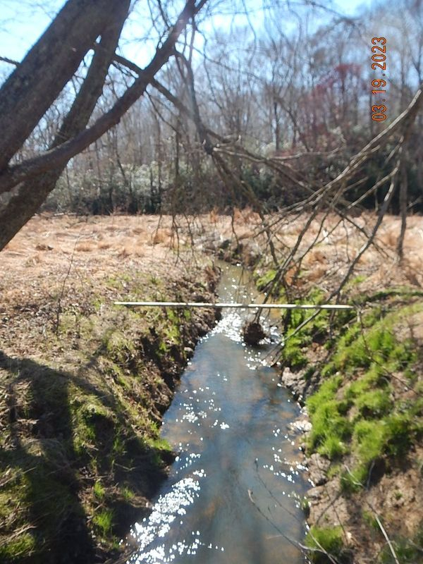

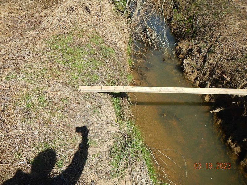

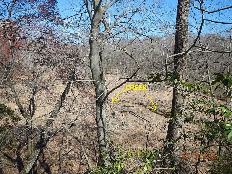

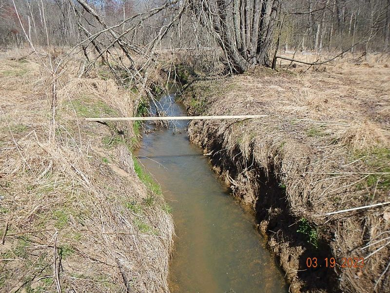

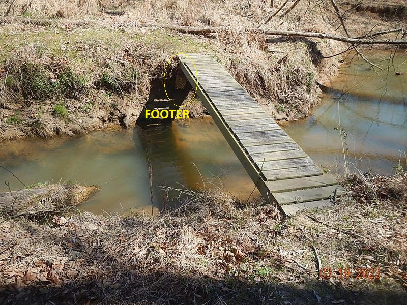

I figured I would start a new thread for how to design/build an abutment,, as my other thread was about beam sizing.
So, my creek runs through a bottom that is about 100 yards wide and absolutely flat.
The soil is silty clay,, problem is when I put in a foot bridge 10 years ago, I concreted the post in about 1.5' back from the bank,, but over the years the bank has washed away, exposing the footer.
So, I will be putting my Tractor bridge in upstream about 100 yards,
The 2x4 in the picture is 12 feet long,, and has 1 and 2 foot marks on each end (black lines)
The water is somewhat low for this time of the year, but gets a few inches lower mid/end of summer.
One summer it did dryout,, and most spring/summer it over flows it's banks once or twice, putting a foot or so of water across the whole bottom.
View attachment 789368View attachment 789369
Any Ideas on Abutments? I am very skilled in Masonry and structural concrete.
I was thinking trying to dig down even with the bottom of the stream (even with the top of the bank) and pouring a footer about as high as the water is now,, (this would be easier if the water goes down come late summer.)
Then forming and pouring a abutment wall on the footer.
Other idea was to get some used "sheet Piling" about 4' long and driving it down just below the lowest part of the stream bed, digging out behind it about 2' back, and back filling with concrete and stone.
No mater what, I want the abutment to abutment distance to be no tighter than the top of the stream bank,, I do not want it to be a constriction when the bottom floods.
Any ideas or words of wisdom??
Another point to consider is your creek photos show no riparian vegetation on the banks. With bare soil exposed the banks will continue to erode, costing you soil and silting up something down stream. One technique to address this is to plant willows along the banks. If you can find some willows, cut short sections of branches and shove them into wet soil, nature will do the rest.
