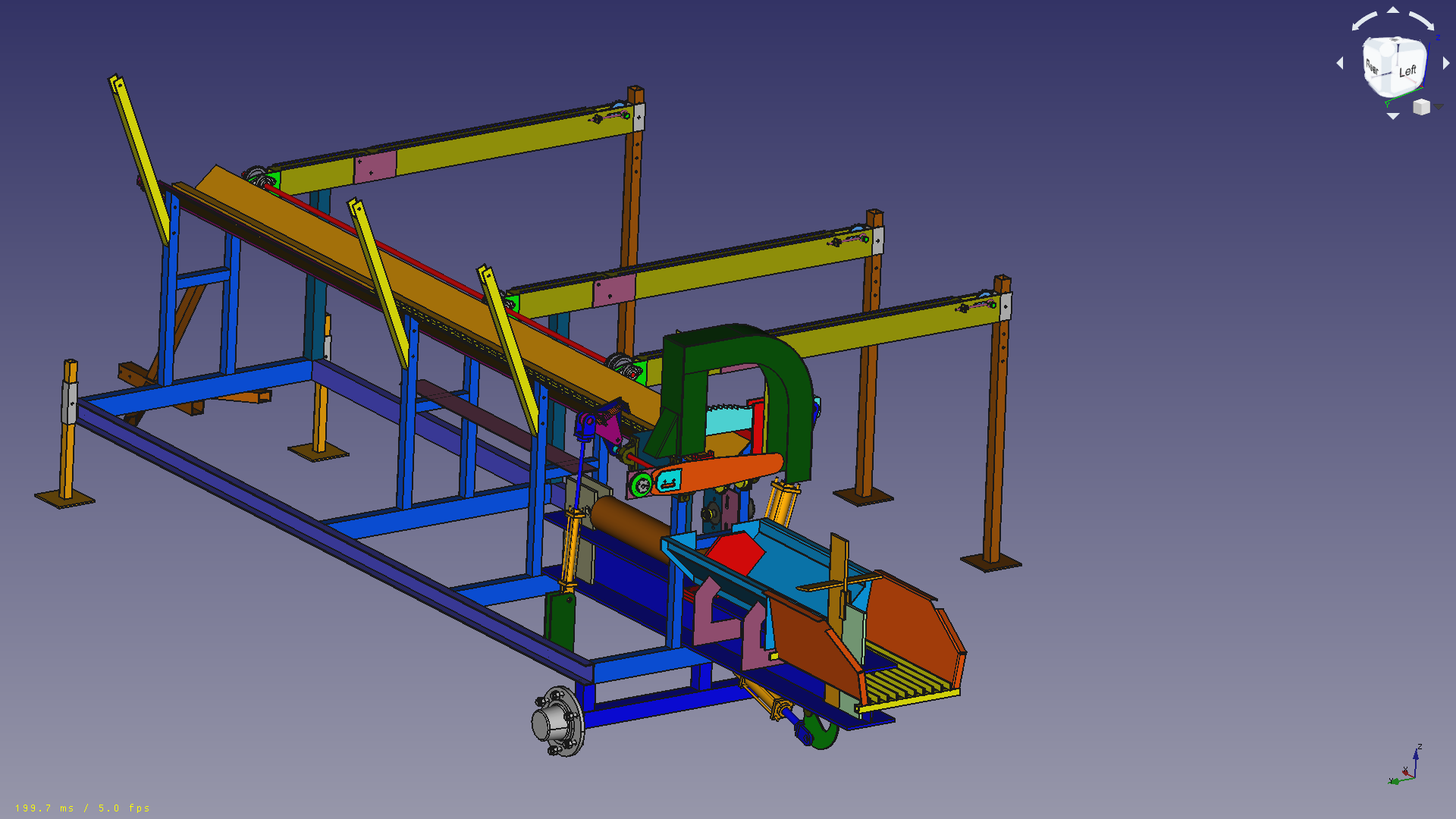

Yes it is great improvement not only in hours but in hard labor. A friend of mine saw my processor and ordered one for himself, but it is a slightly different style, as we doesnot want to use another machinery to lift the logs on the deck, while he is skidding 30ft long logs from the forest. This is the current design so far, and its a paid job so I have to have it ready in 2 weeks :confused2:, maybe thats a better approach you may be interested in, as it utilizes a winch to pull the logs. Screenshot from 2018-12-24 06-39-48.png

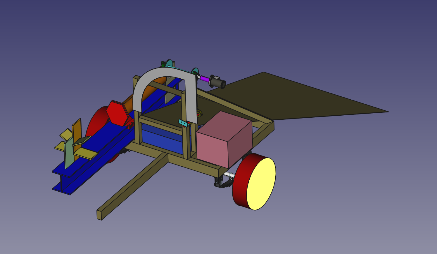

From Wallenstein i improved (imho) the negative thing that the splitter is at the opposite side of the operator. It is very often a need to adjust the log or something. For this build I will use a 16hp from Harbor Freight, for some reason I love how robust and cheap are some Chinese products :) and use a 2-stage pump 22gpm/7gpm with a 5in cylinder. Another thing I do not like on the wallestein is the 2 rectangle profiles for the splitter instead of a W-beam. My calculation show that it is not even close as strong in side-bending force when a knot hits the horizontal knife on the 4-way. I also going to use the full auto cycle valve (extend & return) because the customer wants to use a mechanical chainsaw, so he does not have to keep his hands tied there. Hud-son has a similar model the Badger, which again has some negatives. The controls are above the wheel, which again is not a convenient location for the operator if you do long hours there.

I have contemplated a few changes on the wallenstien platform also, and agree with you on the position of the log splitter. I will most likely put the log splitter directly inline with the feed table. The direction of flow will also be from the front of the trailer to the back of the trailer so I can position the trailer directly in front of my wood shed. That way I can cut and split and the wife can take it from the outfeed chute and stack it. The basic design will be very similar to the one in the link below. I like how simple but effective it is. I love how at 1:09 in the video you can see the chainsaw operator toss his cigarette but in the saw dust pile.

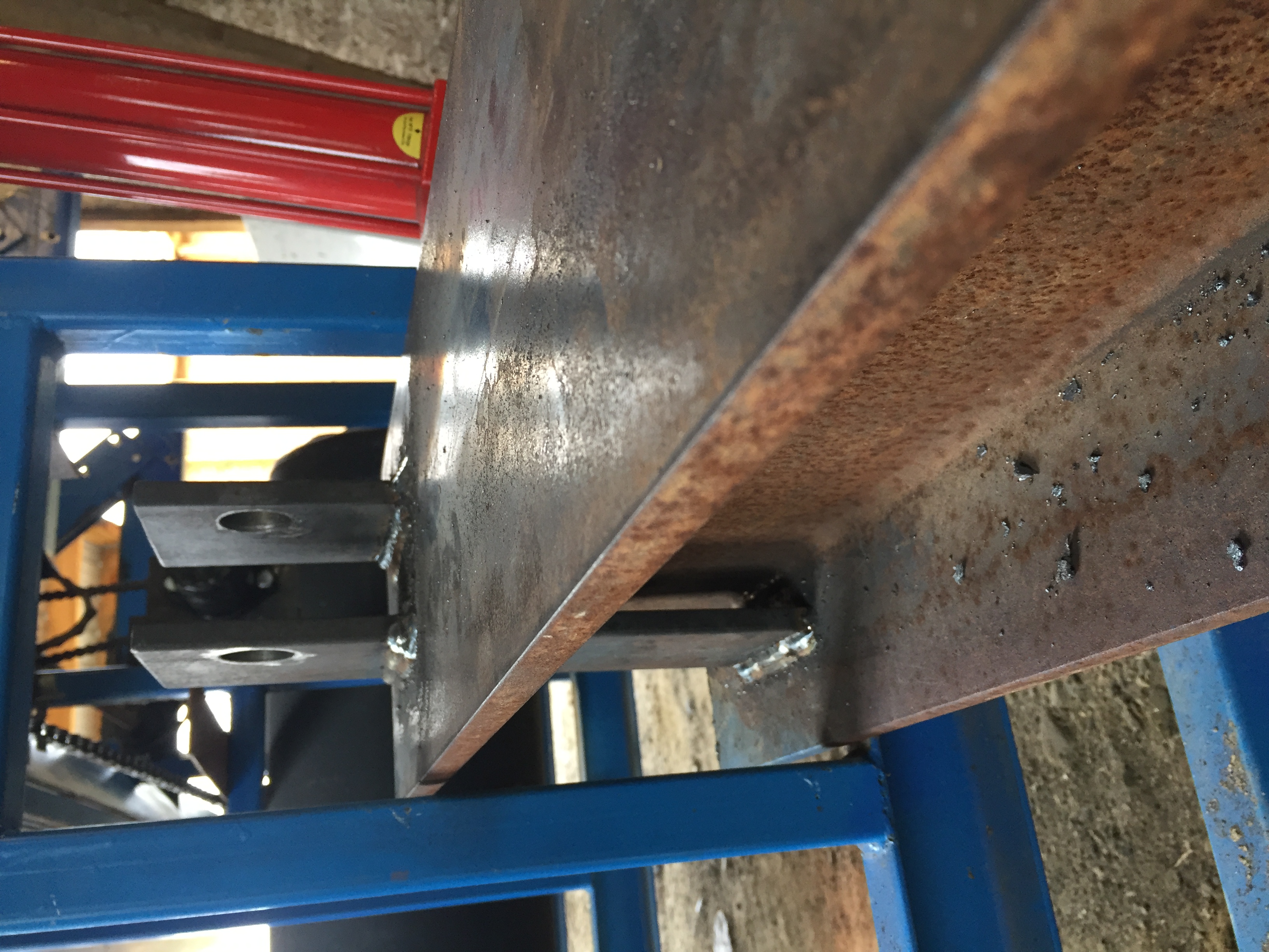

I my own firewood processor I have implement a W8-31 beam. But on my friend's processor I am thinking to go with a a W10-49. It adds about 100lbs but I know it will not get destroyed if as knot gets on the outer horizontal knife. 30tons of force is a lot.
L120, can you plz helpme with the FEA? I can provide you the splitter .step files (or .fcstd ifyou work on Freecad), can you tell me if a W10-49 is a overkill? I have hard time to analyze the complete splitter assembly in Freecad

Yeah, these are cool! Everybody has a different need guys. I am selling firewood, as a side income. My guy who ordered the winch processor that I showed above is logging year round. Even though that processor is not like the big brothers, it will really boost his operation as he will be able to process 40ft long logs, as soon as he skids them out of the woods with his skidder. Ido not have a skidder, but I have a regular tractor and I have a grapple (that I also designed and fabricated myself) and I will load 12ft long logs on the deck.
Everybody has different needs. On the chainsaw chains vs circular saw the answer is easy though :) The circular is way faster. It does not need frequent sharpening.But you need 50hp+ (from what I have read). So for the rest of us a chainsaw chain is good enough.
12sec cycle is not bad, but I assume you get that with a 4in cylinder. which imho is not strong enough if you split hardwoods 4-way. But everybody has different needs :)

I agree that everyone has different needs so if you are building your own equipment, no matter what it is, build it to the specs of what YOU need it to do, not what others need it to do. In my opinion, if you are looking for a processor that doesnt need any other equipment like tractors with forks or grapples to load the wood onto the processor, the second design that Polmidis has shown would be the best option. But having said that you will have to get the logs out of the bush to the processor. This is the reason I am building one of that design, even though I do have a tractor with forks and grapple. It just saves me one more step I the whole process. Park the processor at one end of the log pile and pull off the pile with the winch. Sounds easy to me.
Correct me if im wrong but isnt the W beam that you are talking about, a wide flange I beam with a heavier flange and web. I just never heard them called a W beam before.
The 12 second cycle time is with a four inch cylinder. Around here most of the firewood is either jack pine, spruce, or poplar and in the past 17 years of cutting firewood I have seldom had a tree over 16 inches so a four inch cylinder will work good for me and the trees I have around here.

You are correct about the W-beam. It is just a name we use to order steel :) Do I understand correct that you use softwoods poplar for firewood? Here in Maine these are not acceptable for firewood.
Hi...sorry I didn't see your reply.
I work with AutoCAD all day everyday in 2-D design for restaurant planning & engineering. Determining a W10-49 would be better left to a structural engineer OR look on the internet for specs.
I had to do this when I vaulted my living room ceiling having to build 2-beam to carry load. Found all the formulas. That was all fun on CAD, but a bugger to drywall ! lol PS...it looks great.
