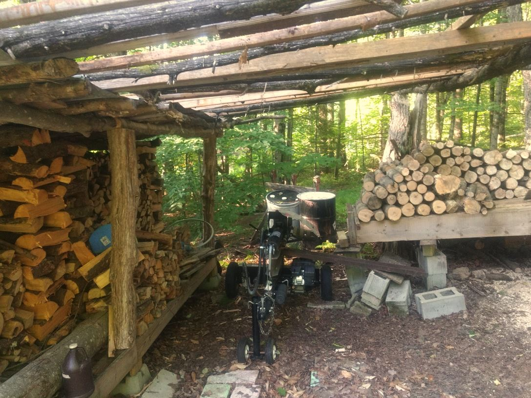

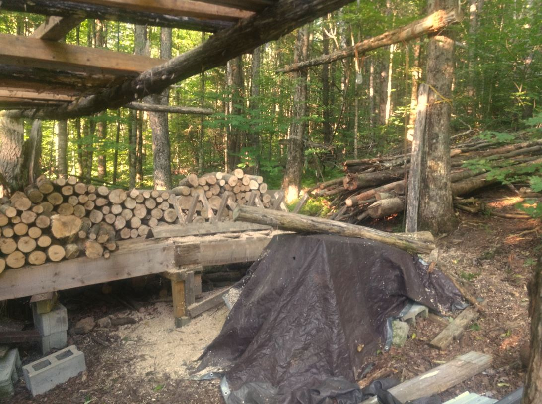

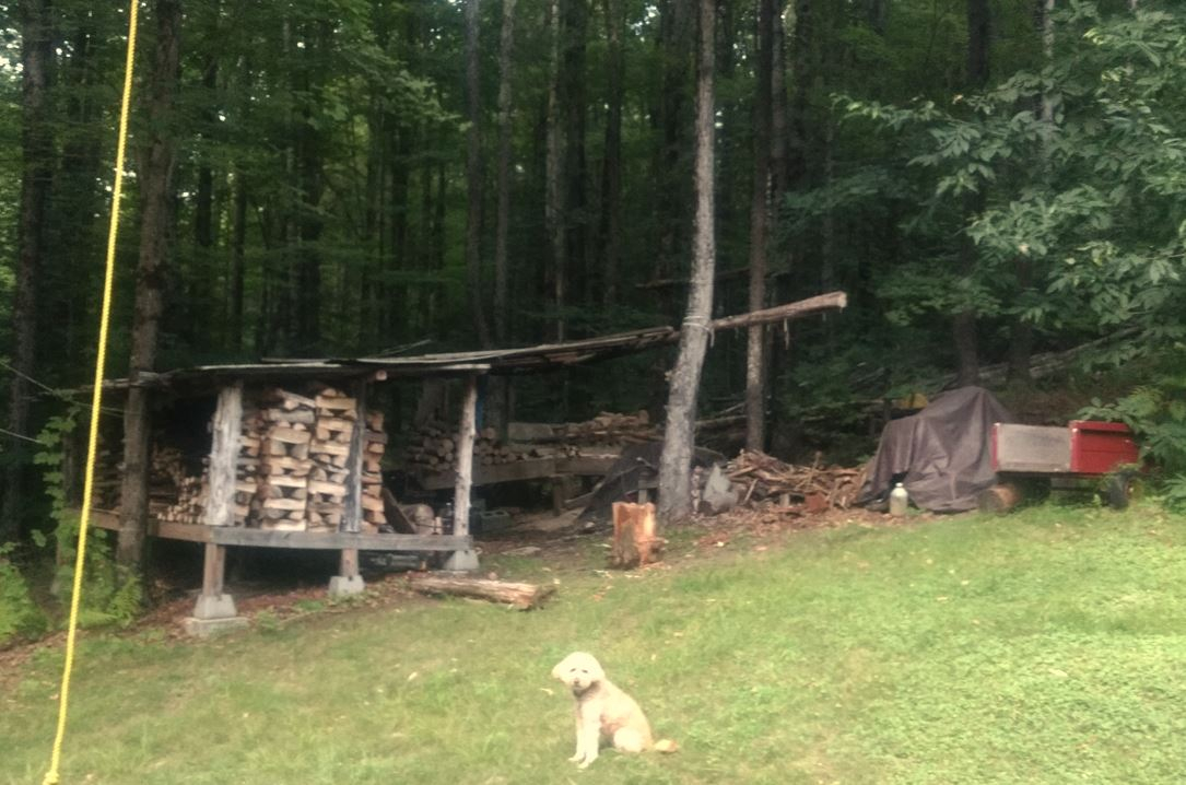

Everhard, you make a good point regarding the ample space to stack multiple years worth of wood, I should look into expanding my platform. The challenge there is finding enough sunlight. Over the years I have been working on efficiency, started with a rope over my shoulder to drag the logs down the hill. Sometimes the hill/snow was enough that the log lead me down, other times... i think i compressed my spine. I now have a portable winch, huge advantage!! The "hill" also helps with the landing-to-stack; pics below. From the platform, it is a short walk to the stack on the back deck.
If not a full blown processor, I at least need to upgrade my block-n-tackle (strung with 550 cord) method of pulling logs off the landing to the sawbuck. The sawbuck did not survive this season. Not sure if I can build a hydraulic winch/sawbuck in a way that could, later on, be scabbed onto a processor...
The allure of building something and 'hopefully' learning about hydraulics is very strong. I recently finished a boat trailer to utility trailer conversion and bought a small stick welder when my gas rig couldn't make up for my lack of skill. I need a project to continue its 'justification'. ;)
