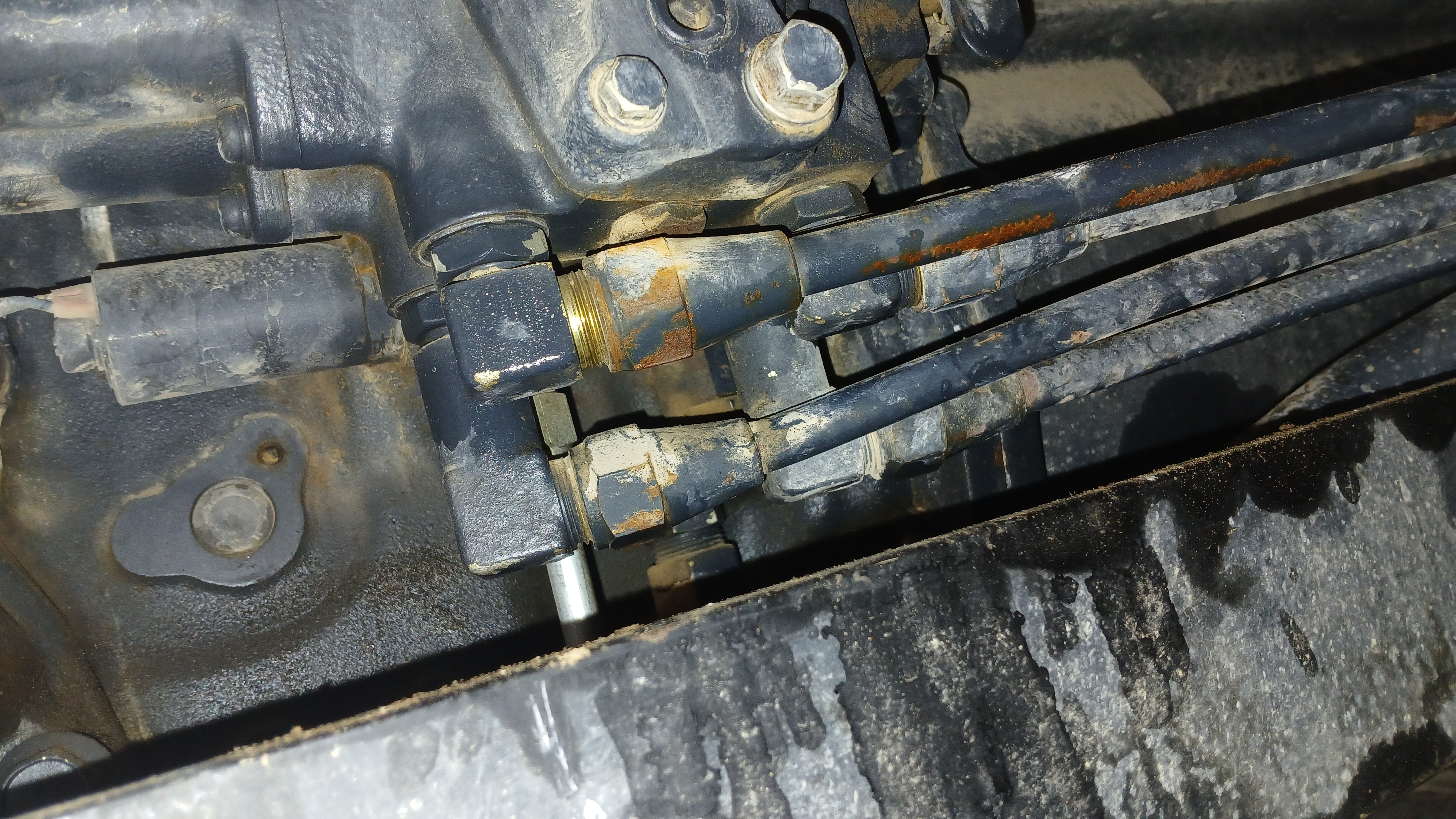

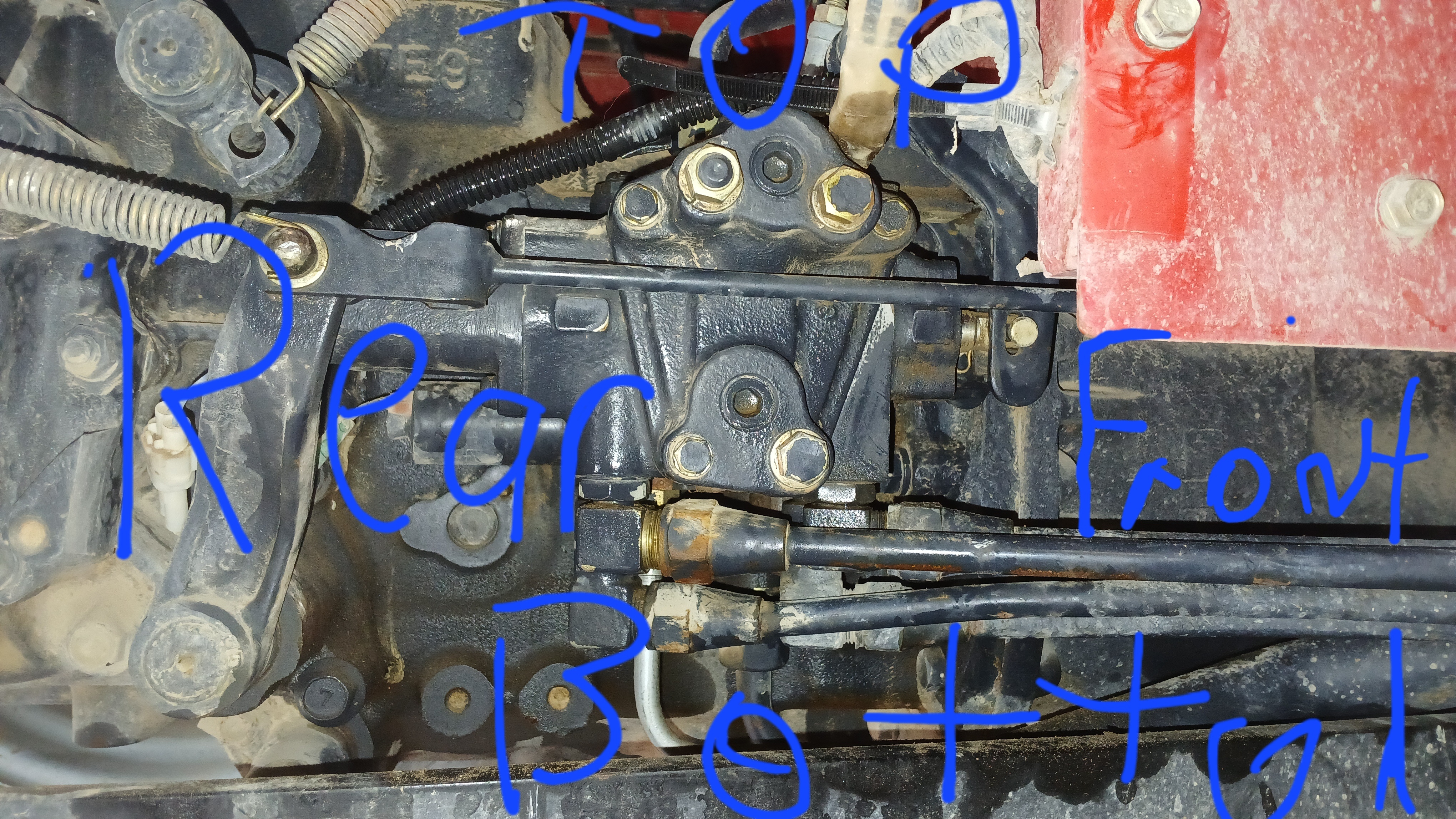

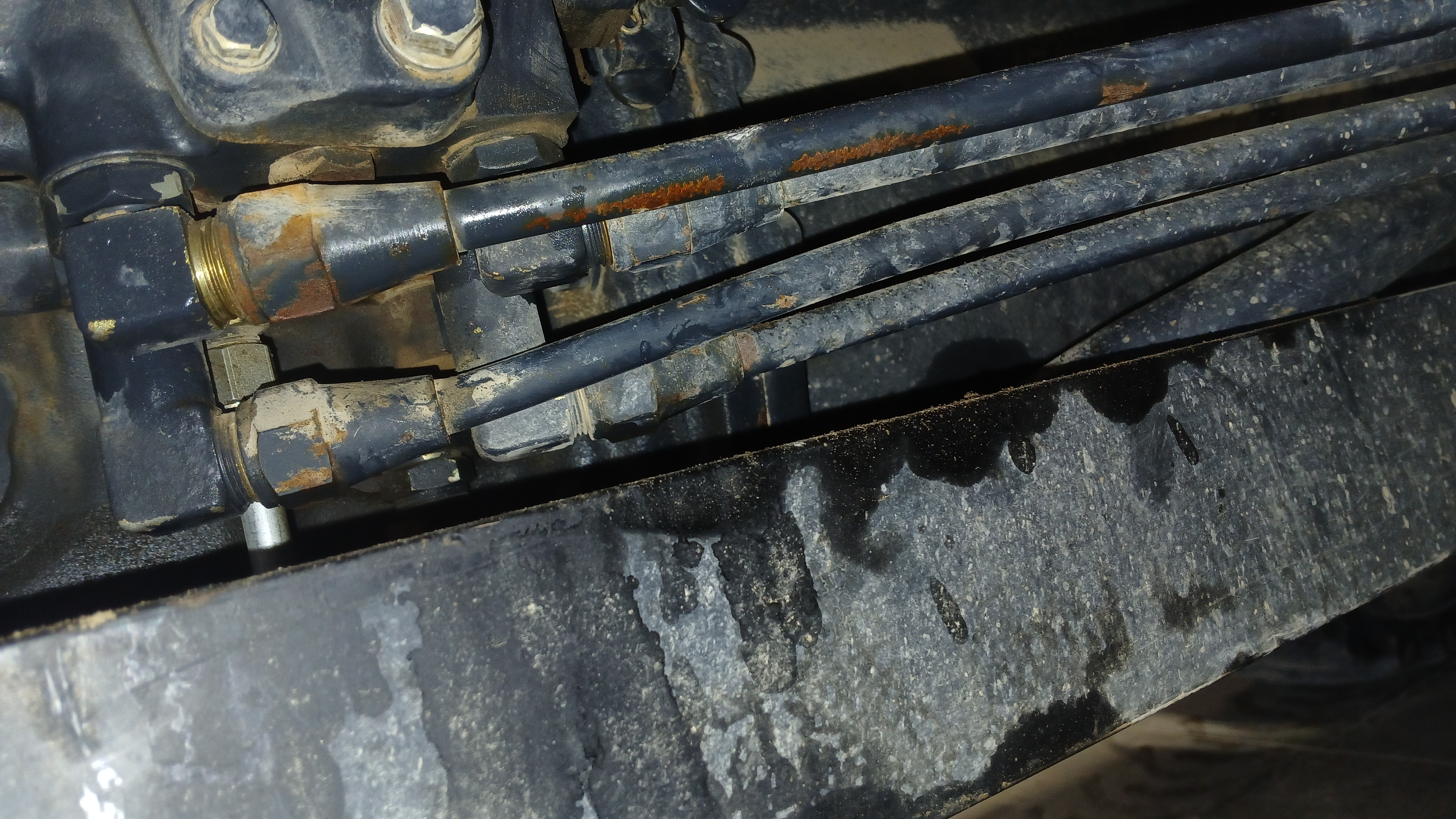

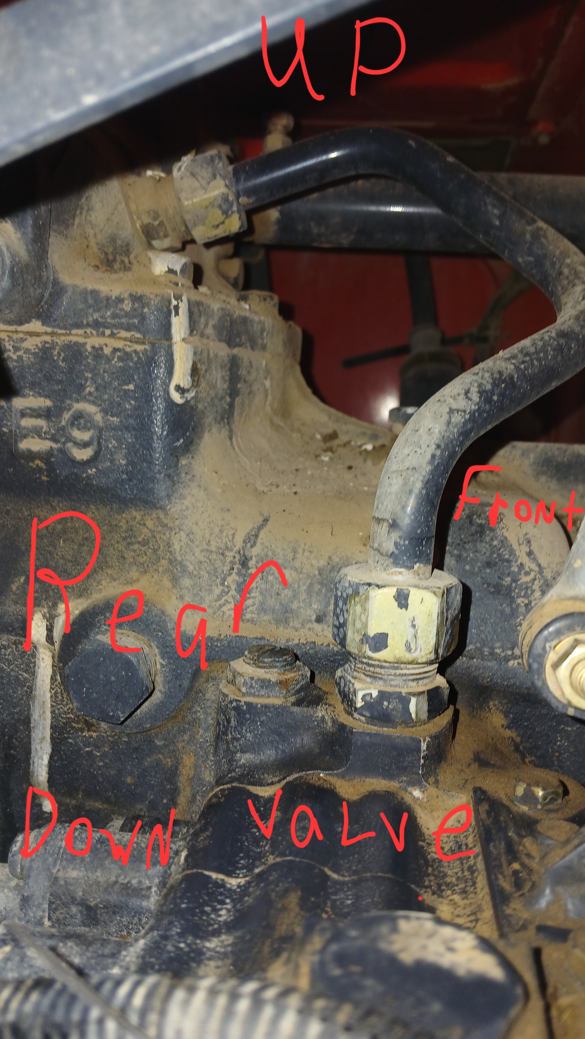

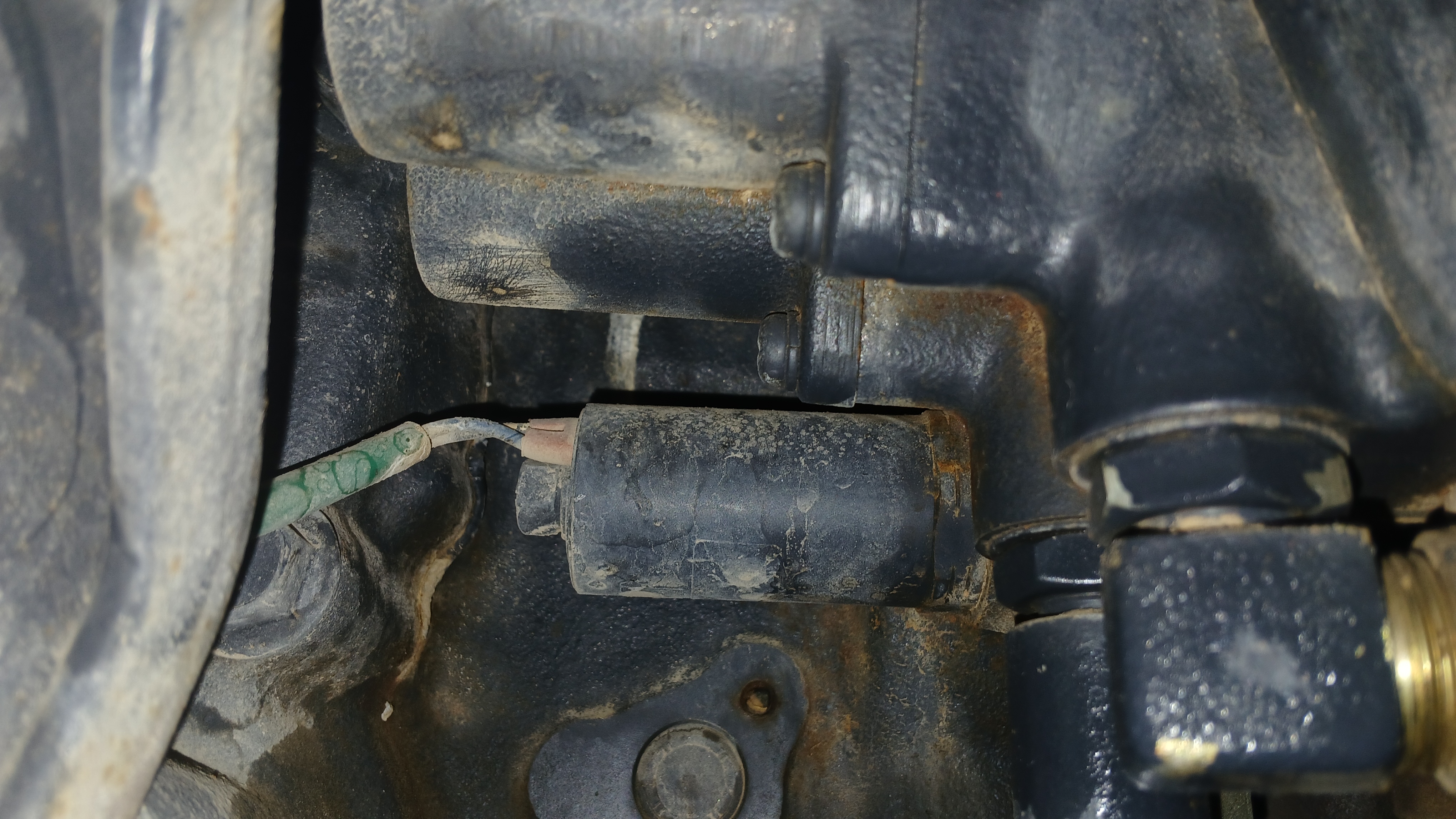

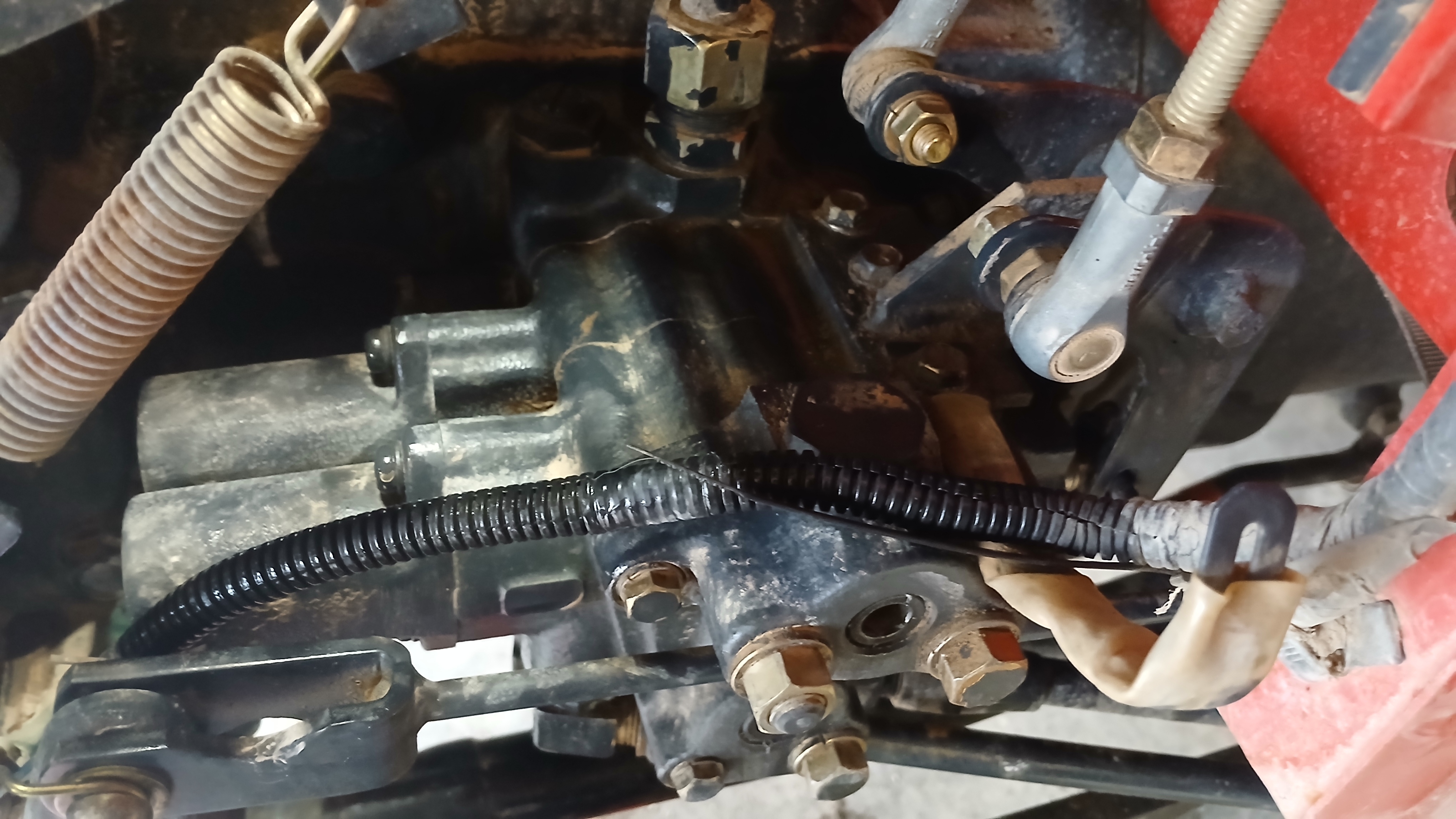

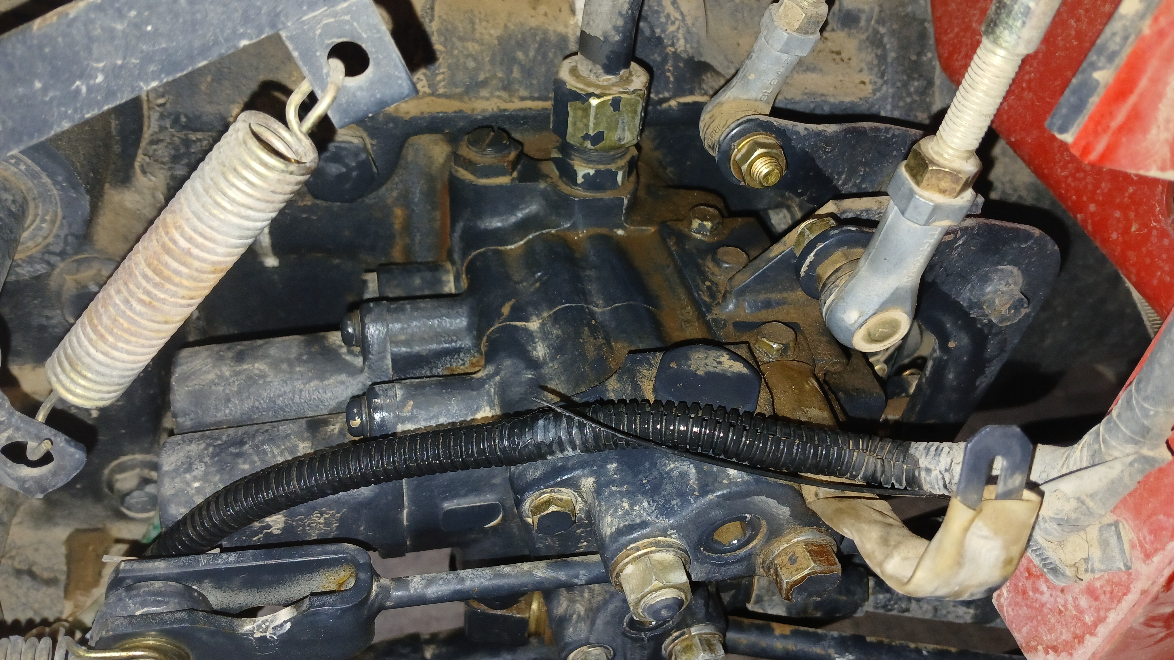

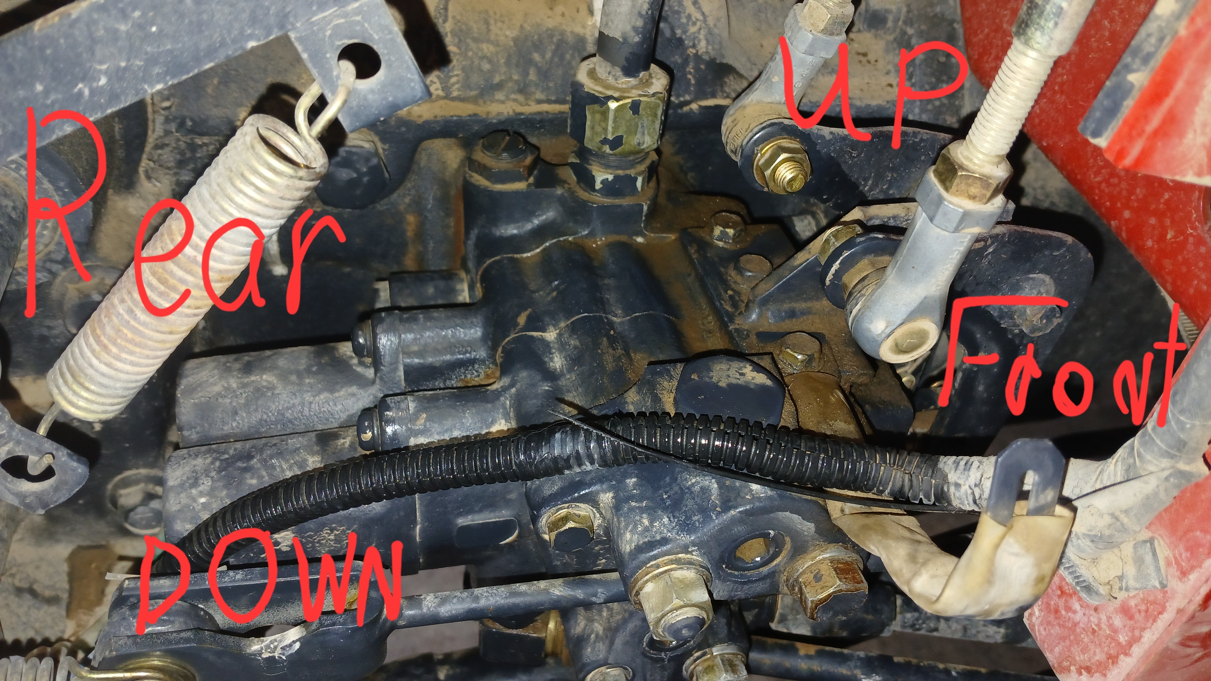

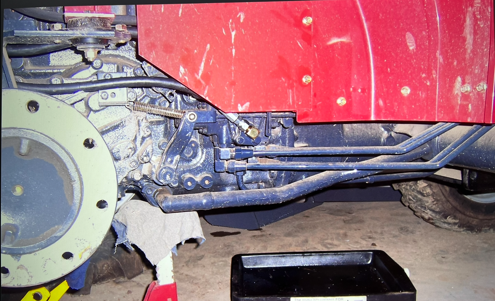

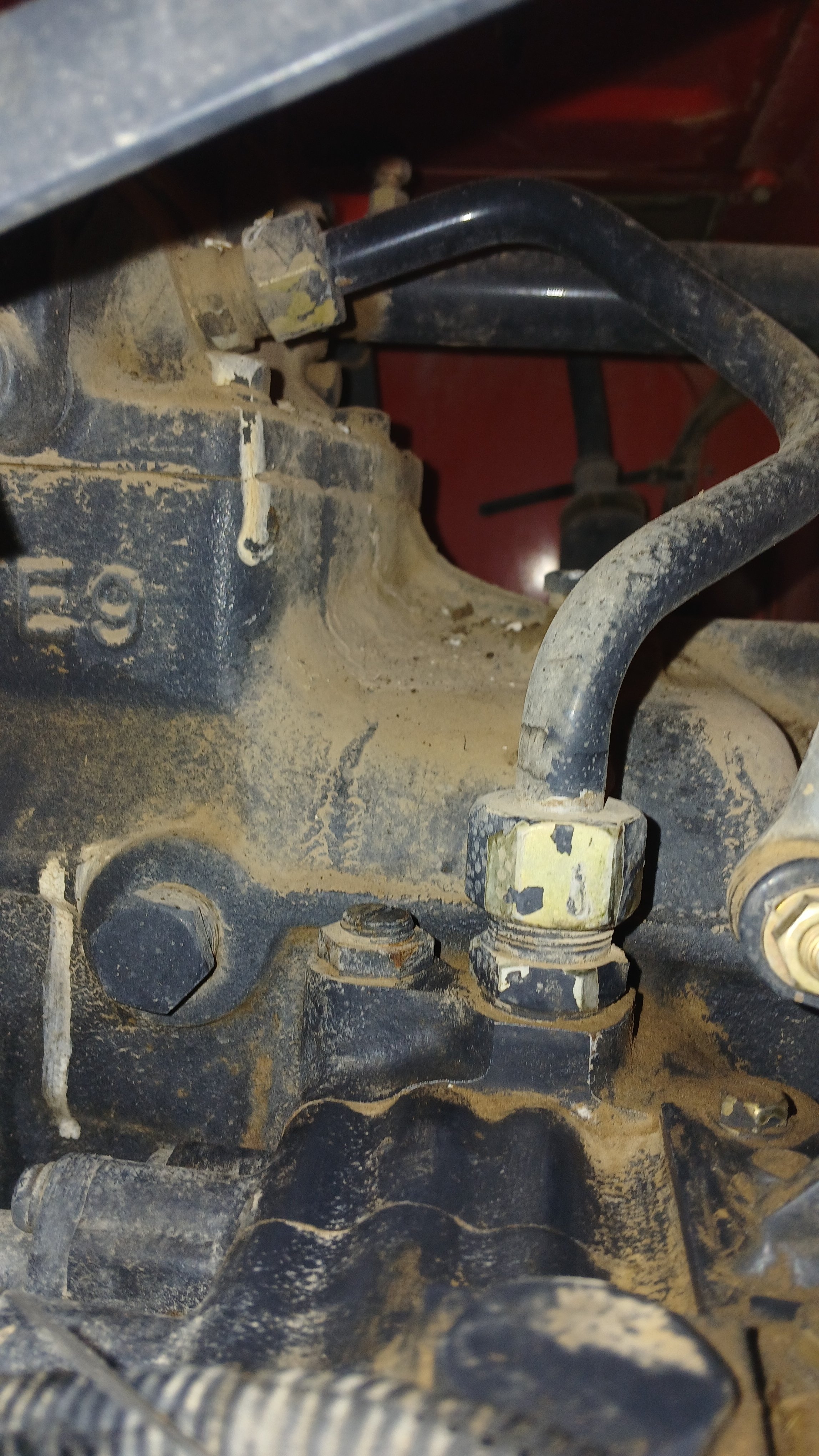

OK got the pass tire off and the fender cutout removed. Here's some pictures. I called my closest massey dealer (2 towns away) and they were eager to help but couldn't get me exactly what was needed. They said I should have a 3 spool front loader valve with a feeder for the rear remotes on the back... but I in fact have a 2 spool? Here's some pictures

A little more description of each picture.
First picture is at loader valve height looking into the tractor from the wheel
   / Questions about 2013 Massey Ferguson 1533 Rear Remote install
#17
Second Pic is from outside wheel to inside of tractor. From top of the valve.

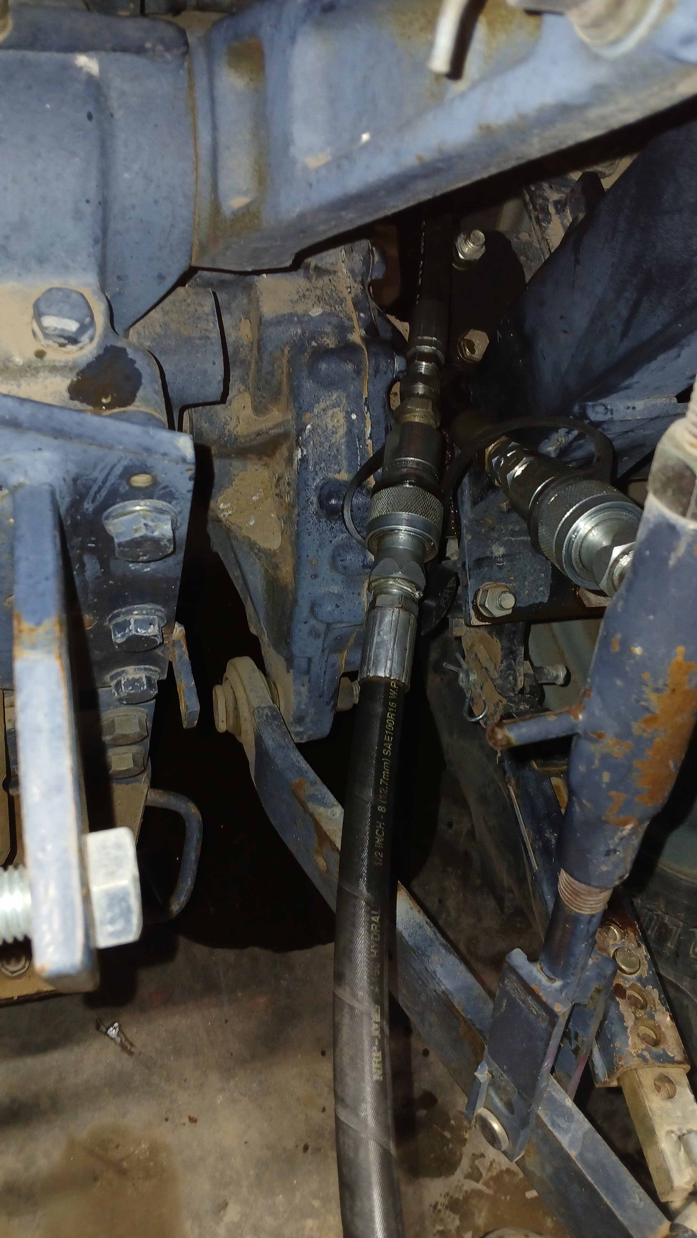

#18
This 3rd photo is of what appears to be a rear output line... it's directly on top of the loader valve pressure input. (Where my orange tape goes around the hydraulic pump outlet line)

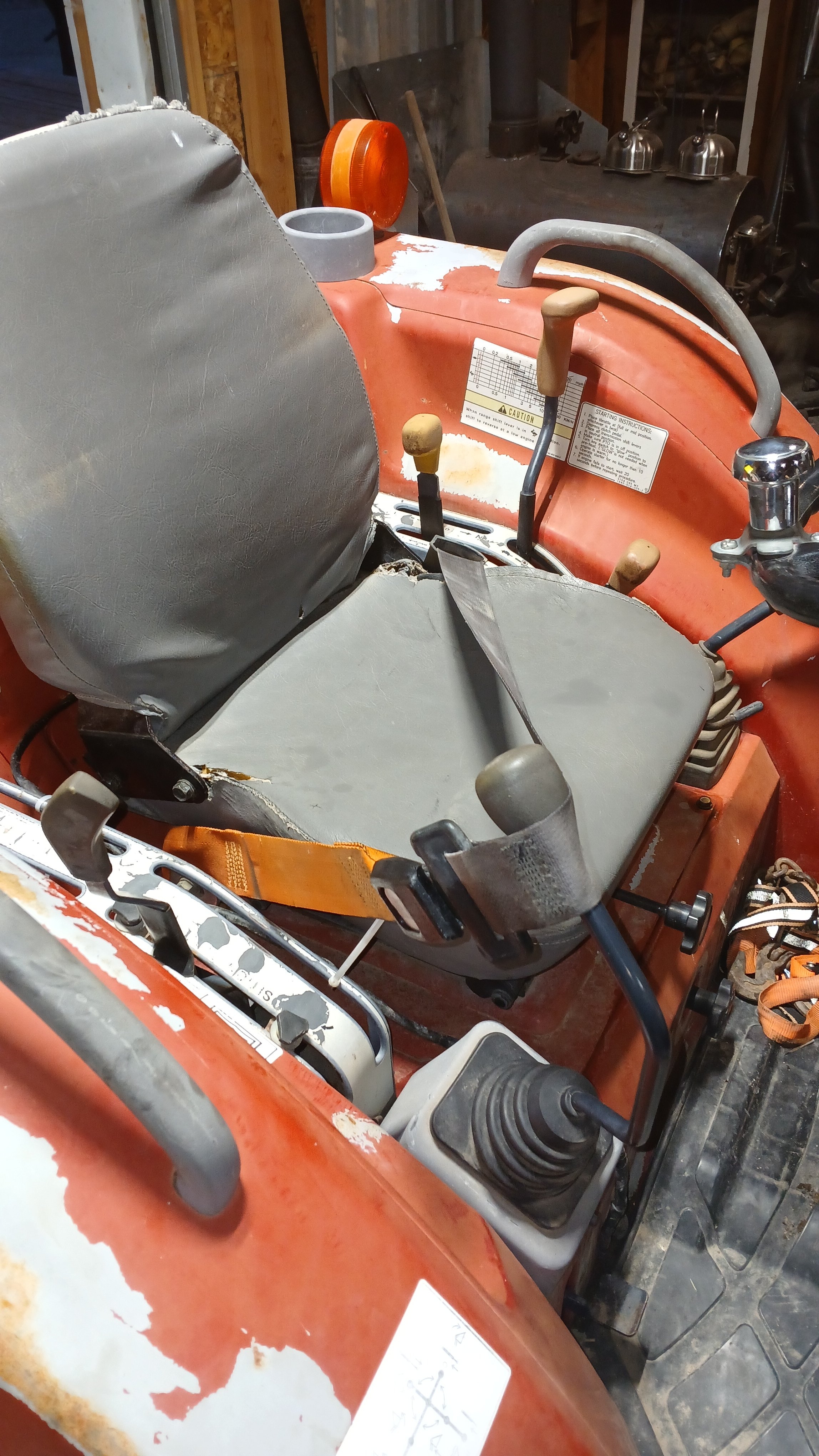

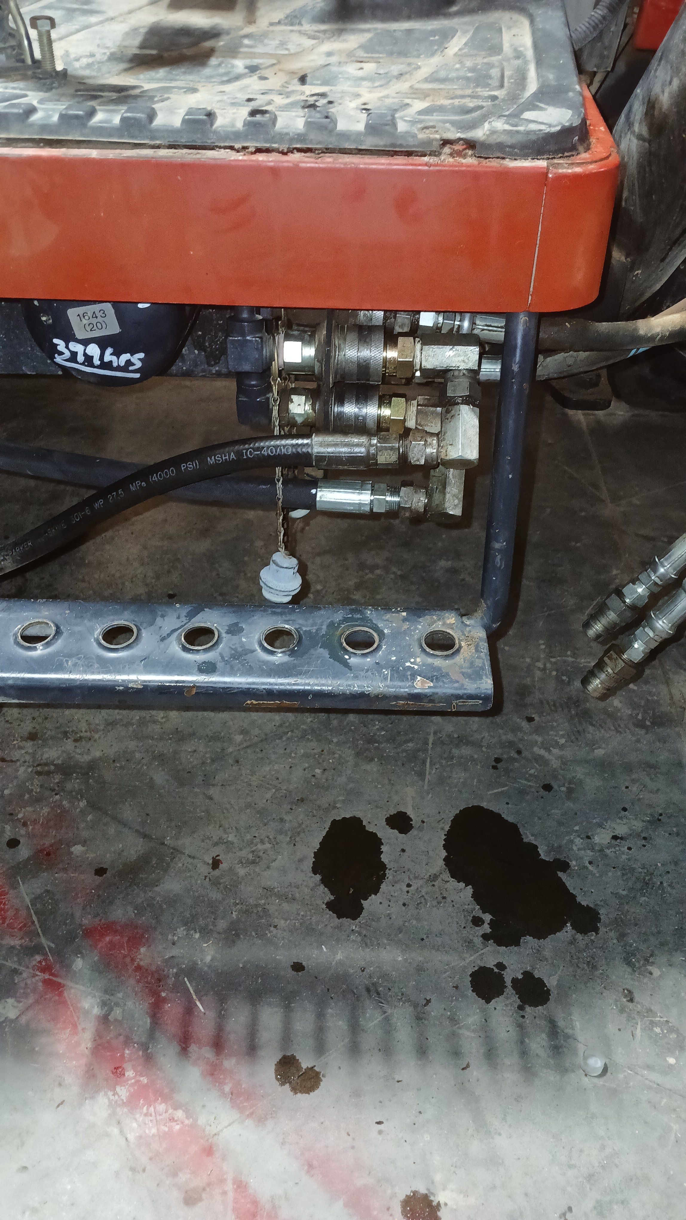

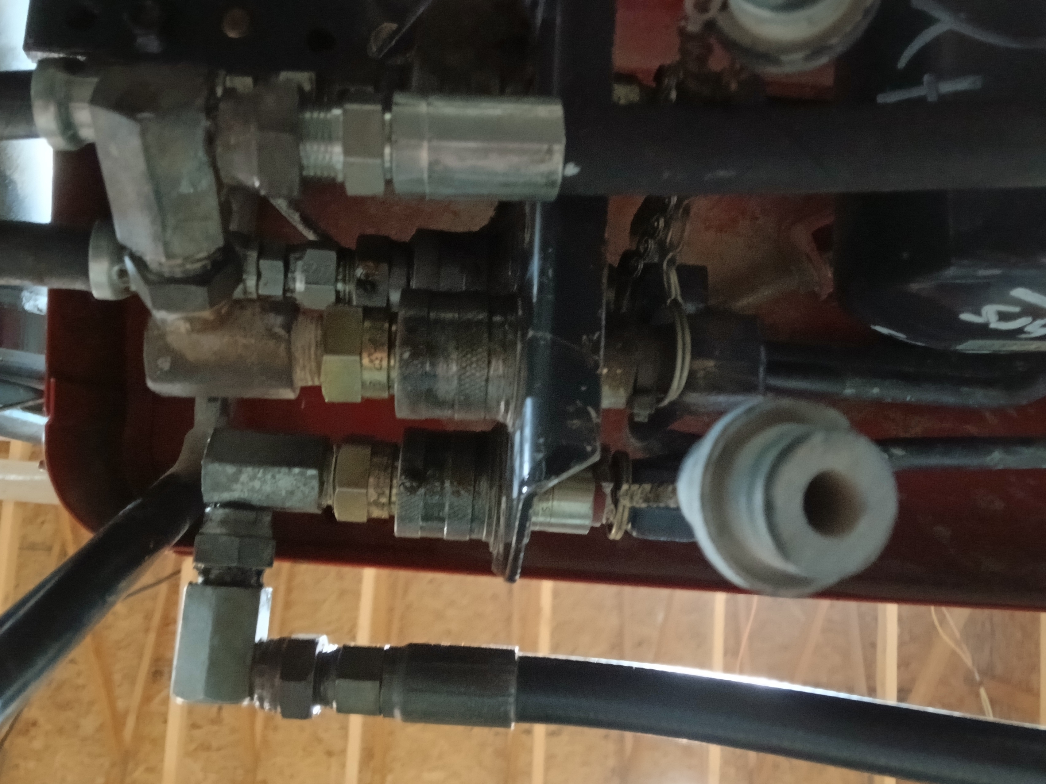

I have an old Ag tilling trailer that has alot of older hydraulic parts I can rob off of it. I made a temporary setup for now. Here's my Seatbelt throttle for it.
