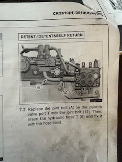

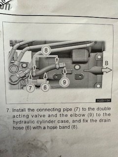

Evening All,
I am currently installing rear remote kit (KIOTI CKA 111) onto my CK2620. However, I've run into an issue and of course the dealer is closed until Monday.
The issue lies with how to install the return line of the double acting valve. It states certain Serial #'s for the 3510/4010 as a cutoff; before cutoff the return line goes to the joystick and after the cutoff it goes to the lift housing. But it states nothing for the 2610/2620, even though in the header of the document the 2610 is listed.
Anyone have suggestions or dealt with this? I was hoping to get it all done this weekend verses having to wait until Monday to hear back from the dealer.
Cheers in advance!

View attachment 2410402View attachment 2410403View attachment 2410404
Same problem here on my ck2610 rops

Same issue here where you able to get an answer for the drain issue?
