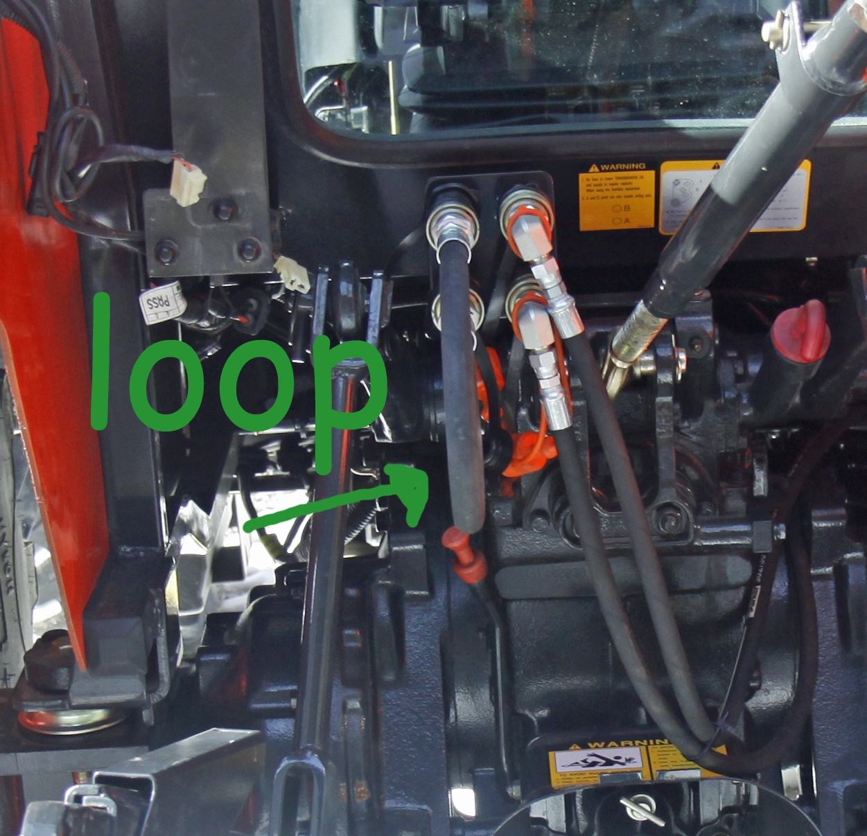

To prevent deadheading a remote with a detent ball, i installed a loop of hose with 2 quick disconnects. I use this valve to operate my log splitter. I want the detent to lock the valve open so my external valve on the splitter controls in and out of the cylinder. When the splitter is off the unit, im installing the loop of hose. I removed the detent in the other rear remote to operate my hydraulic top link.
Hey, that's a good idea. Are those ready made, or did you just have your local hydraulic hose guys make one up. If the latter, is there a more technical name for the hose ends than "tractor quick connect male adapter"?
/ dumb question about TYM rear remotes #8
I just had my local hose shop make it. I gave them the coupler number, they made it
