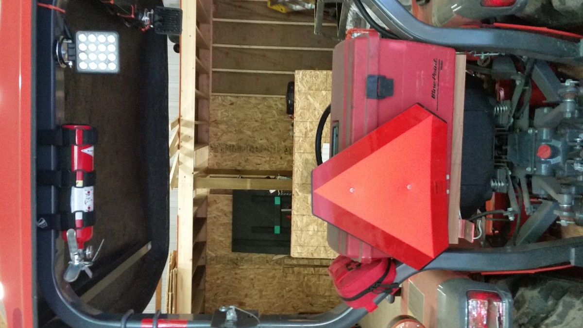

Here is mine. Mounted on the ROPS with my own bracket. I still maintained the ease of pulling the fire extinguisher fast. It just slides on a little hook on the top, while the bottom just have a strap that allow for the fire extinguisher to slide in.

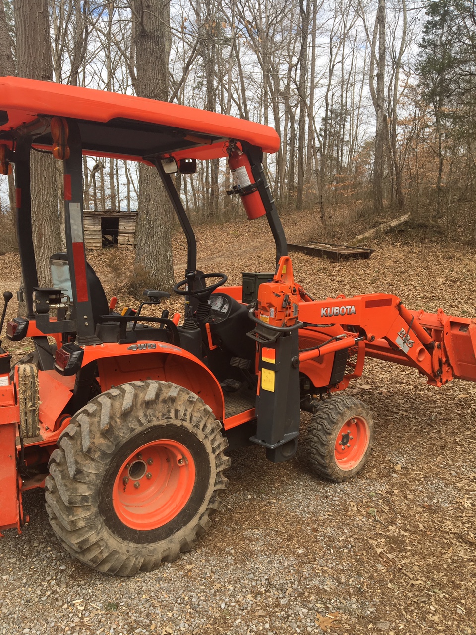

I too had difficulty finding the best mount and ended up going with a nylon version that straps on. Has worked extremely well for me and was easy to remove from my old tractor to my new.
I would recommended that you wrap some Scotch tape or a bread tie through your safety pin so it doesn't get snagged by brush, or fall out due to vibration.

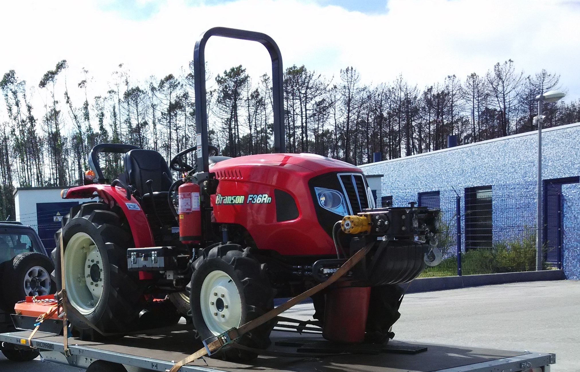

   / Fire extinguisher #23
I’m more impressed by the nylon version that straps the tractor to the wall than I am the extinguisher straps!

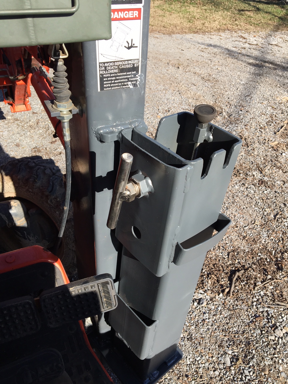

   / Fire extinguisher #26
Scrap pile chainsaw, chain and tool holder. 5” square tube and 2x5” rectangle tube split. Bolt with spring for clamp. Doesn’t really need a clamp. Uses factory plastic blade guard which helps moving saw from shop, truck or worksite. Note adjustable rubber foot to add support for the saw. 1/2 plate on bottom. Welded to loader upright. Can safely carry chain, saw or tools on tractor.
   / Fire extinguisher #27
That looks good! Thx for sharing.
